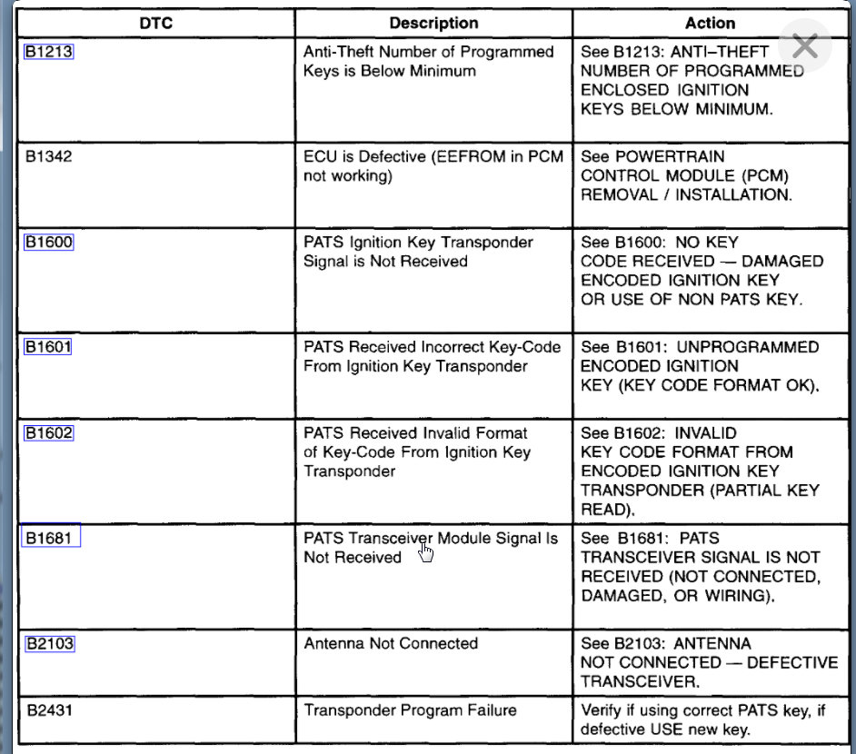

Replace the head gaskets and the starter and the anti-theft lock won't let me crank the vehicle.
Apr 20, 2021 at 8:58 AM
CERTIFIED EXPERT
18,907 POSTS
We need to start with scanning for codes.
More than likely you will have one of the codes below.
So once we know what codes are there we will know what direction to go so let's start here and go from there. Thanks
