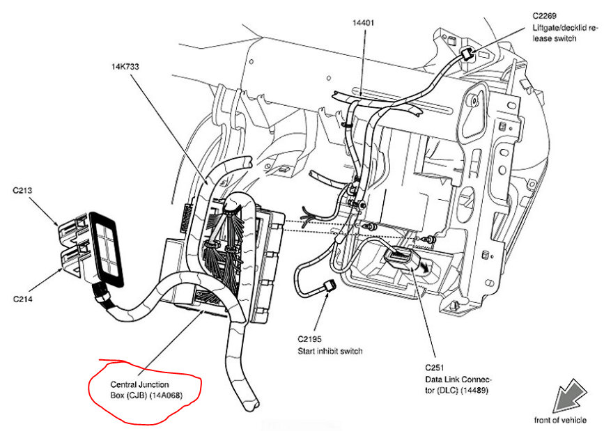

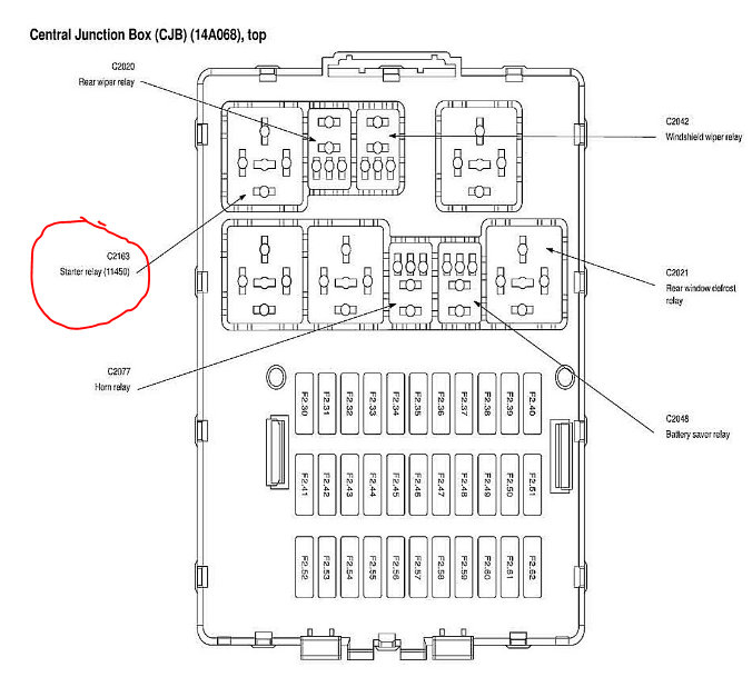

Where is the starter relay for this car? my distribution box they have Rl then numbers.

The starter relay is located in the central junction box.Here is a tutorial that can show you how to test a relay:
I've attached 2 pictures below showing its location and circled in red.Hope this helps and thanks for using 2CarPros.
