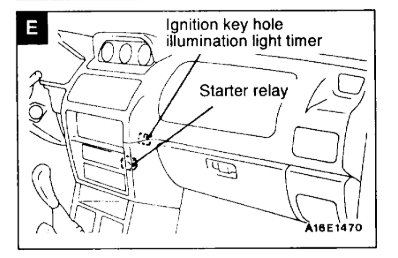

Unfortunately, No picture was available.Just states as behind center console-Behind center of dash.I'll try to find a picture in the meantime.Here is a tutorial showing how to test relays.

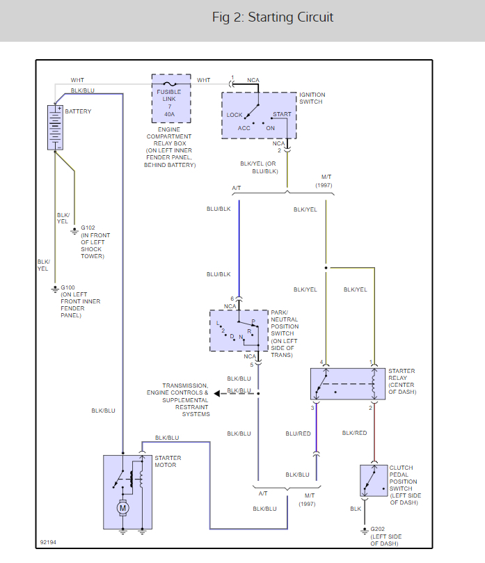

If I can jump in here with the location of the relay and the wiring diagrams so you can see how the system works. Check out the diagrams (Below). Please let us know if you need anything else.
