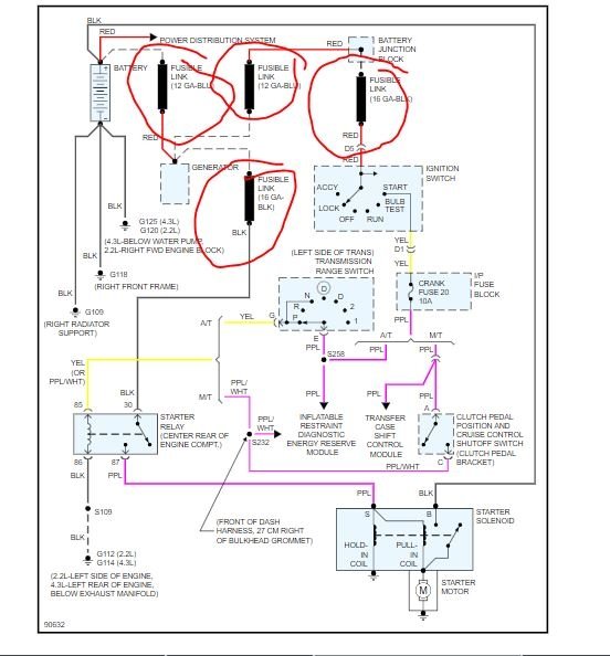

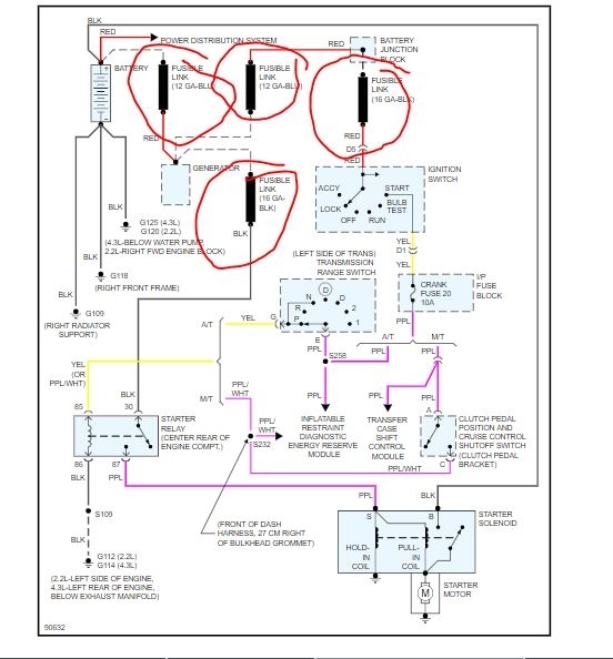

Good afternoon,
I attached a wiring diagram for you to view. There are fusible links behind the alternator and you may have burned them out. Test them to see if they are broken.

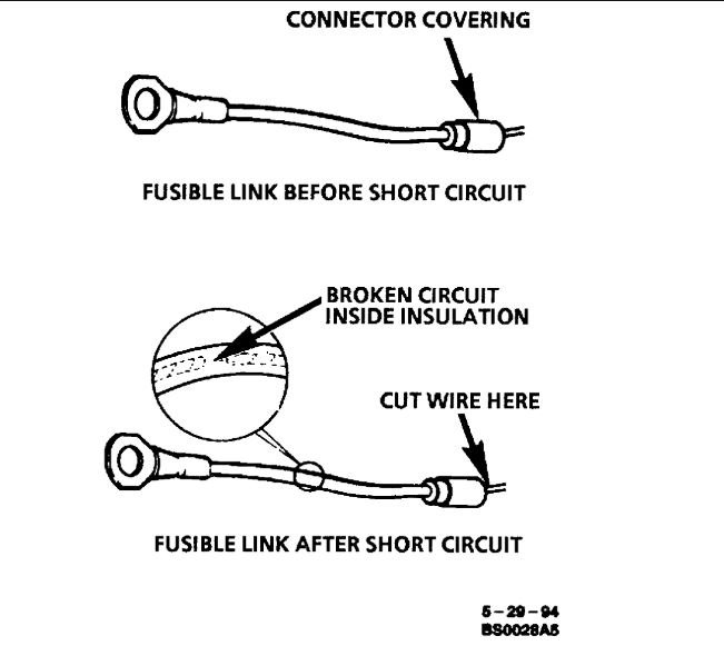

With a test light. If they are bad, they will look broken. You will have power on 1 side but not the other.
In addition to circuit breakers and fuses, some circuits use fusible links to protect the wiring. Like fuses, fusible links are "one-time" protection devices that will melt and create an open circuit.
Not all fusible link open Circuits can be detected by observation. Always inspect that there is battery voltage past the fusible link to verify continuity.

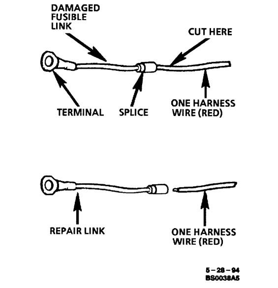

To replace a damaged fusible link, cut it off beyond the splice. Replace with a repair link. When connecting the repair link, strip wire and use staking-type pliers to crimp the splice securely in two places. For more details on splicing procedures, refer to "Typical Electrical Repair Procedures." Use crimp and seal splices whenever possible. See: Vehicle > Diagnostic Aids > Typical Electrical Repair Procedures
Double Wire Feed Fusible Link
To replace a damaged fusible link which feeds two harness wires, cut them both off beyond the splice. Use two repair links, one spliced to each harness wire.

I have tested my wiring from my alternator to the starter relay and i have no power to the starter relay. I have power from battery to alternator and no power past fusible link. Should i have the key turned to start to test past the fusible link or is it blown?
Feb 2, 2020 at 8:58 AM
Again, no. It is hot all the time. It sounds like the link has failed if you have no power past it. Replace the link and retest.
