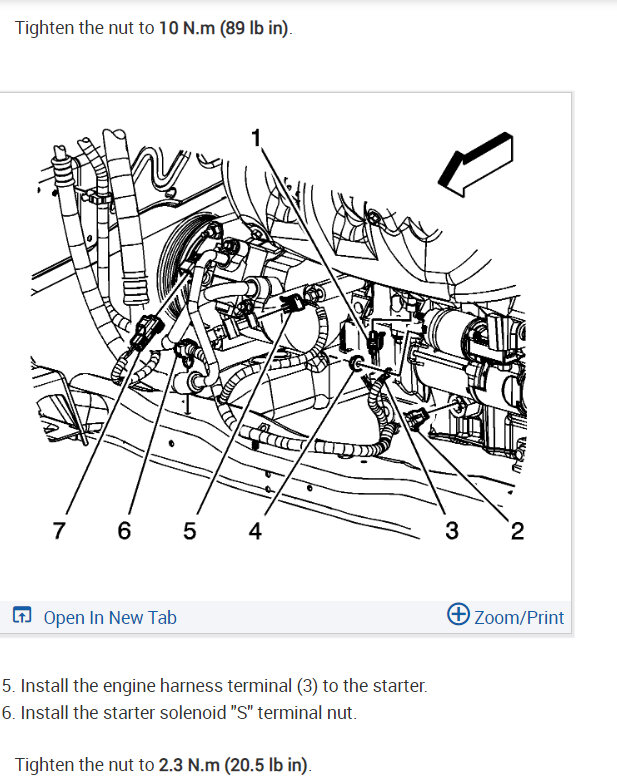

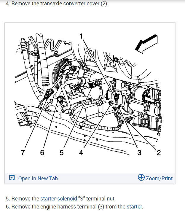

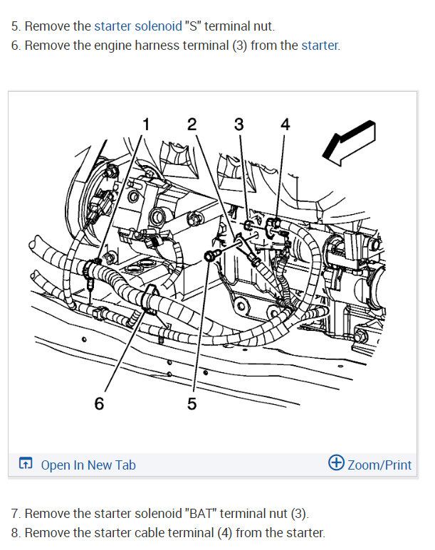

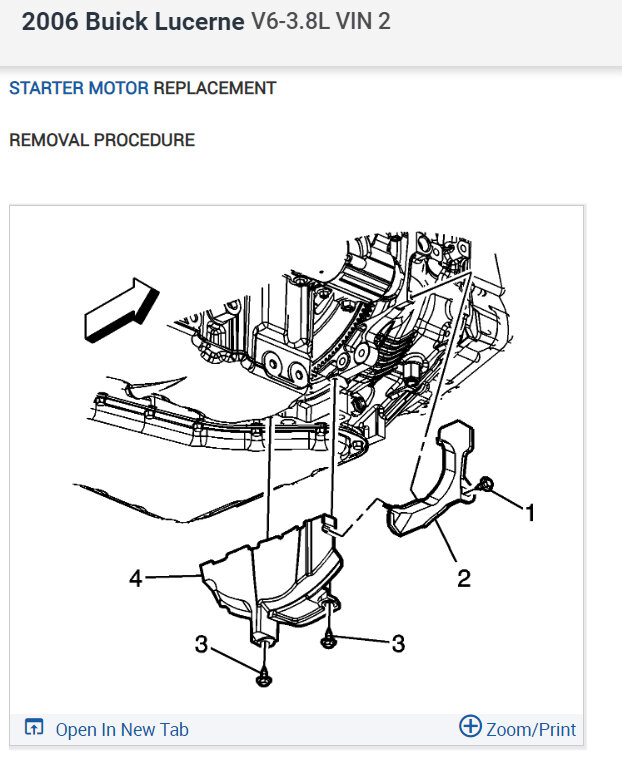

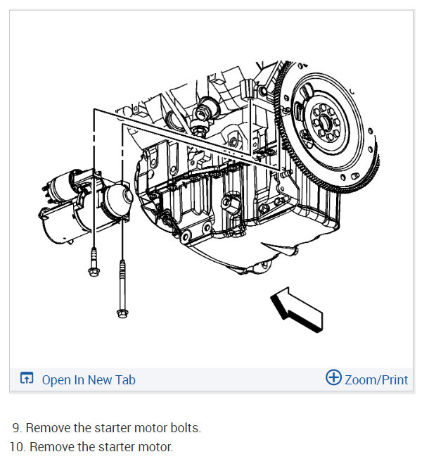

The starter is on the engine down low on the left side rear. here is a generic guide to help you step by step with instructions in the diagrams below to show you how on your car:
