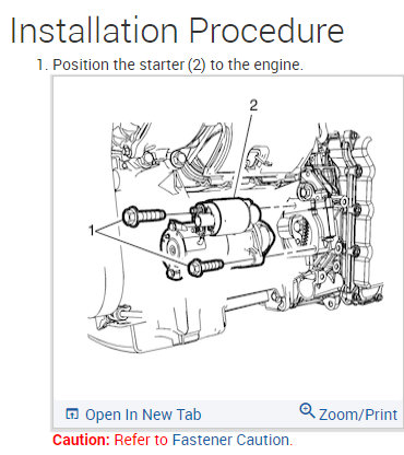

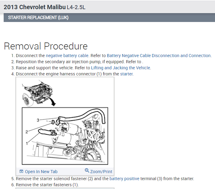

I have had this vehicle for about 5 years. I have replaced about everything under the hood but I'm having problem locating the starting after the freeze it is just clicking.
