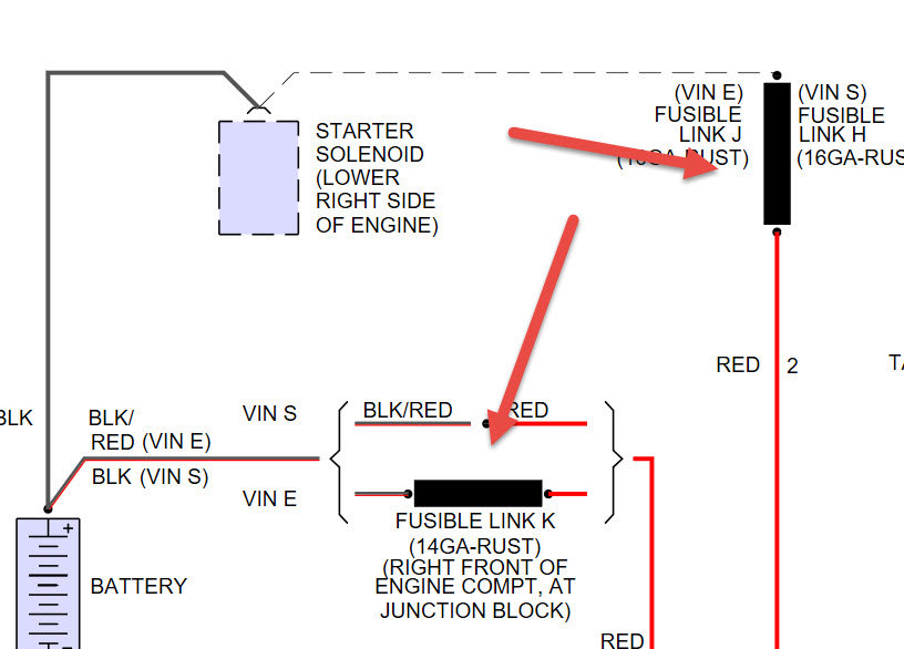

First or first opportunity have battery checked for cleanliness, condition including a load test most places do for free. check fusible links for a good connection both sides they may not be should have battery voltage both sides. See picture, then take starter to auto parts and have checked the starter drive may be bad if it will spin but will not turn engine over which will require a rebuilt starter.
