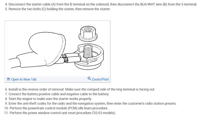

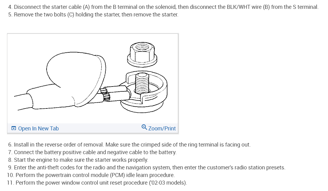

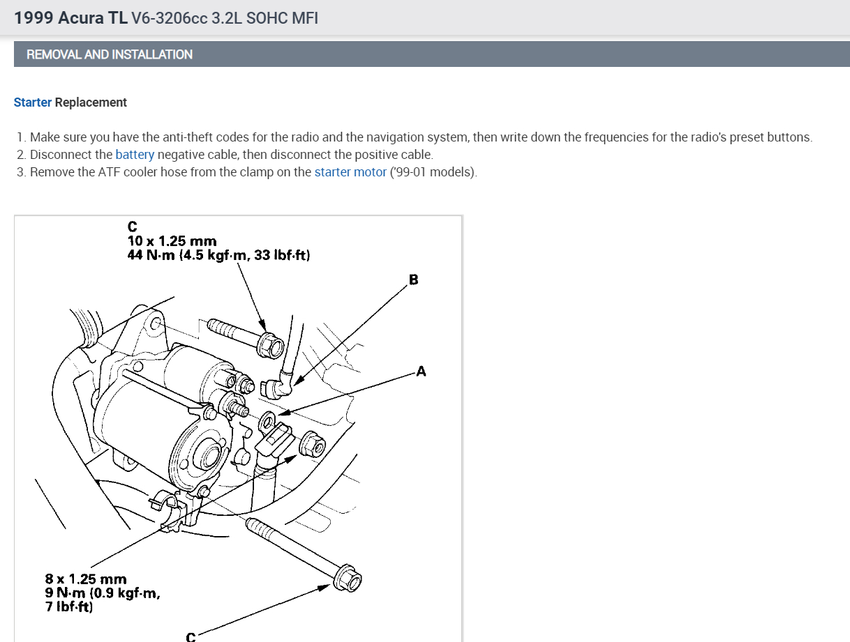

It sounds like the starter you installed is defective or the wiring to the starter has been installed incorrectly. Here is a guide to help you step by step for the starter replacement and instructions in the images below to show you how on your car.
