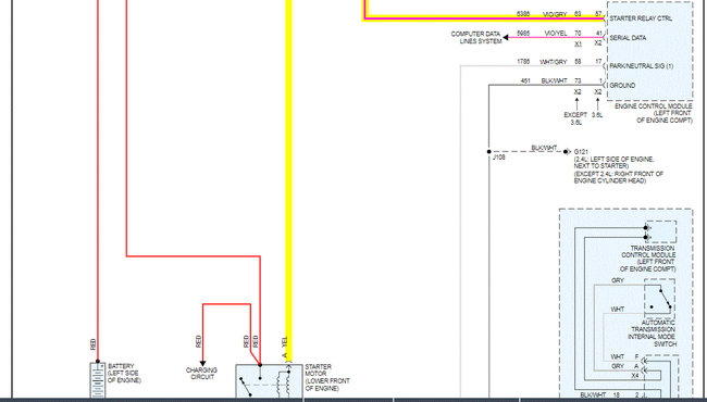

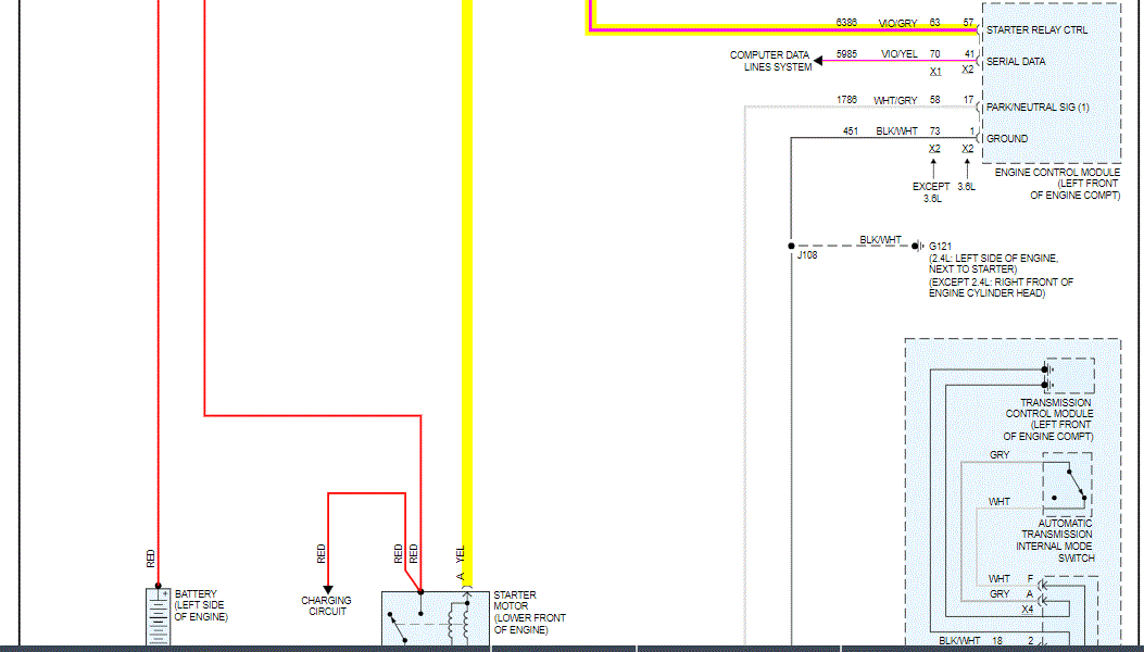

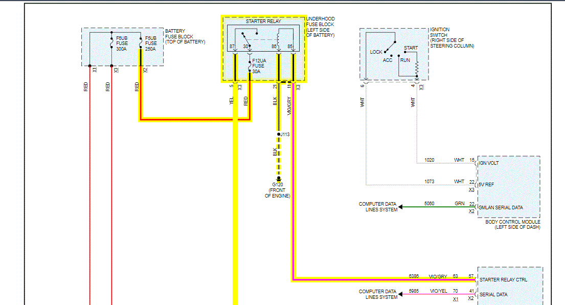

I have a friend with the car listed above that threw a code starter relay circuit p0615. The relay energizes properly and the fuse blade on battery is good going to starter, fuse box checks out good. During time unable to get underneath car to even attempt to look at starter and solenoid and of course unsure for removal and replacement guide. 75 to 80% of the time tries to start car the dash resets.
Is there a wiring diagram and troubleshooting for the DTC p0615?

Good afternoon,
If the relay energizes when you turn the key to start, you need to go to the starter solenoid and check for power at the yellow wire.
I attached a wiring diagram for you of the system.
Circuit/System Description
When the ignition switch is placed in the START position, a discrete signal is supplied to the body control module (BCM) notifying it that the ignition is in the START position. The BCM then sends a message to the engine control module (ECM) that crank has been requested. The ECM then verifies that the clutch pedal is depressed or the transmission is in Park/Neutral. If it is, the ECM then supplies 12 V to the control circuit of the starter relay. When this occurs, battery voltage is supplied through the switch of the starter relay to the starter solenoid.

Circuit/System Testing
1. Ignition OFF, disconnect the KR27 starter relay.
2. Ignition OFF and scan tool disconnected, open and close the driver door, and wait 1 minute. Test for less than 5.0 Ohms between the relay ground circuit terminal 86 and ground.
If greater than the specified range, test the ground circuit for an open/high resistance.
3. Verify a test lamp illuminates between the B+ circuit terminal 30 and ground.
If the test lamp does not illuminate, test the B+ circuit for a short to ground or an open/high resistance. If the circuit tests normal and the B+ circuit fuse is open, test the control circuit terminal 87 for a short to ground.
4. Ignition ON, verify that a test lamp does not illuminate between the control circuit terminal 87 and ground.
If the test lamp illuminates, test the control circuit for a short to voltage.
5. Parking brake applied and the transmission is in NEUTRAL or PARK. Momentarily install a 30 A fused jumper wire between the B+ circuit terminal 30 and the control circuit terminal 87. Verify the M64 starter motor is activated.
If the M64 motor does not activate, test the control circuit for an open/high resistance. If the circuit tests normal, test or replace the M64 starter motor.
6. Ignition OFF, connect a test lamp between the control circuit terminal 85 and the ground circuit terminal 86.
7. Transmission in park or neutral, command the starter relay ON and OFF with a scan tool. The test lamp should turn ON and OFF when changing between the commanded states.
If the test lamp is always ON, test the control circuit for short to voltage. If the circuit tests normal, replace the K20 ECM.
If the test lamp is always OFF, test the control circuit for a short to ground or an open/high resistance. If the circuit tests normal, replace the K20 ECM.
8. If all circuits tests normal, replace the KR27 starter relay.

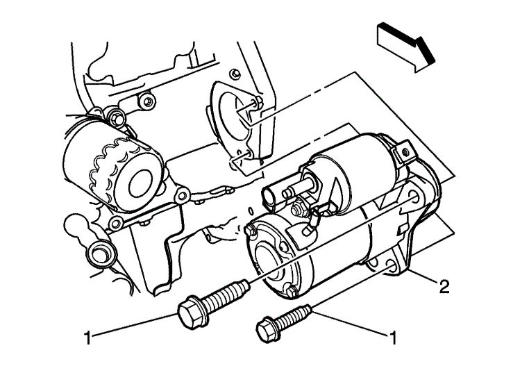

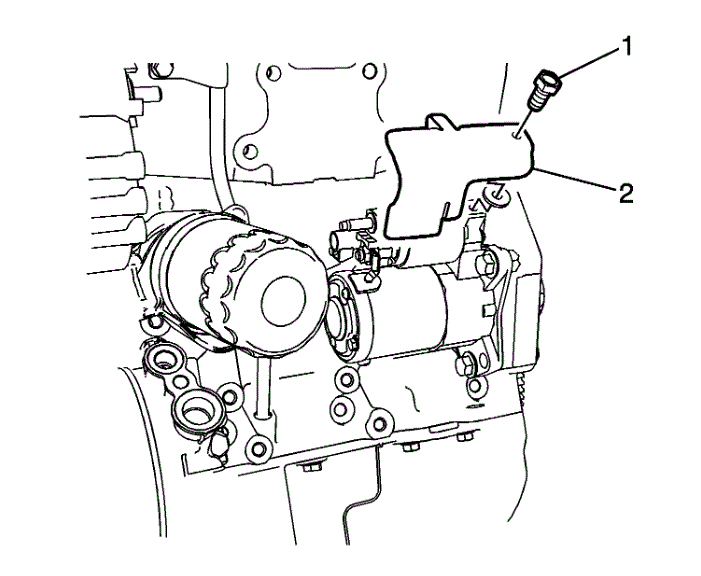

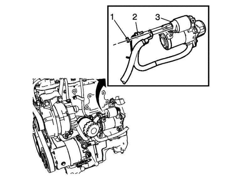

Starter
Starter Replacement (V6)
Removal Procedure
1. Turn OFF the ignition.
2. Disconnect the battery negative cable. Refer to Battery Negative Cable Disconnection and Connection (See: Negative > Removal and Replacement > Battery Negative Cable Disconnection and Connection).
3. Remove the heat shield (2) from the starter.
4. Raise and support the vehicle.Refer to Lifting and Jacking the Vehicle (See: Vehicle Lifting > Procedures > Lifting and Jacking the Vehicle)
5. Disconnect the knock sensor connector.
6. Remove the battery positive nut (1) and the engine harness connector (2), from the starter solenoid (3).
7. Remove the starter motor bolts (1).
8. Remove the starter motor (2).
