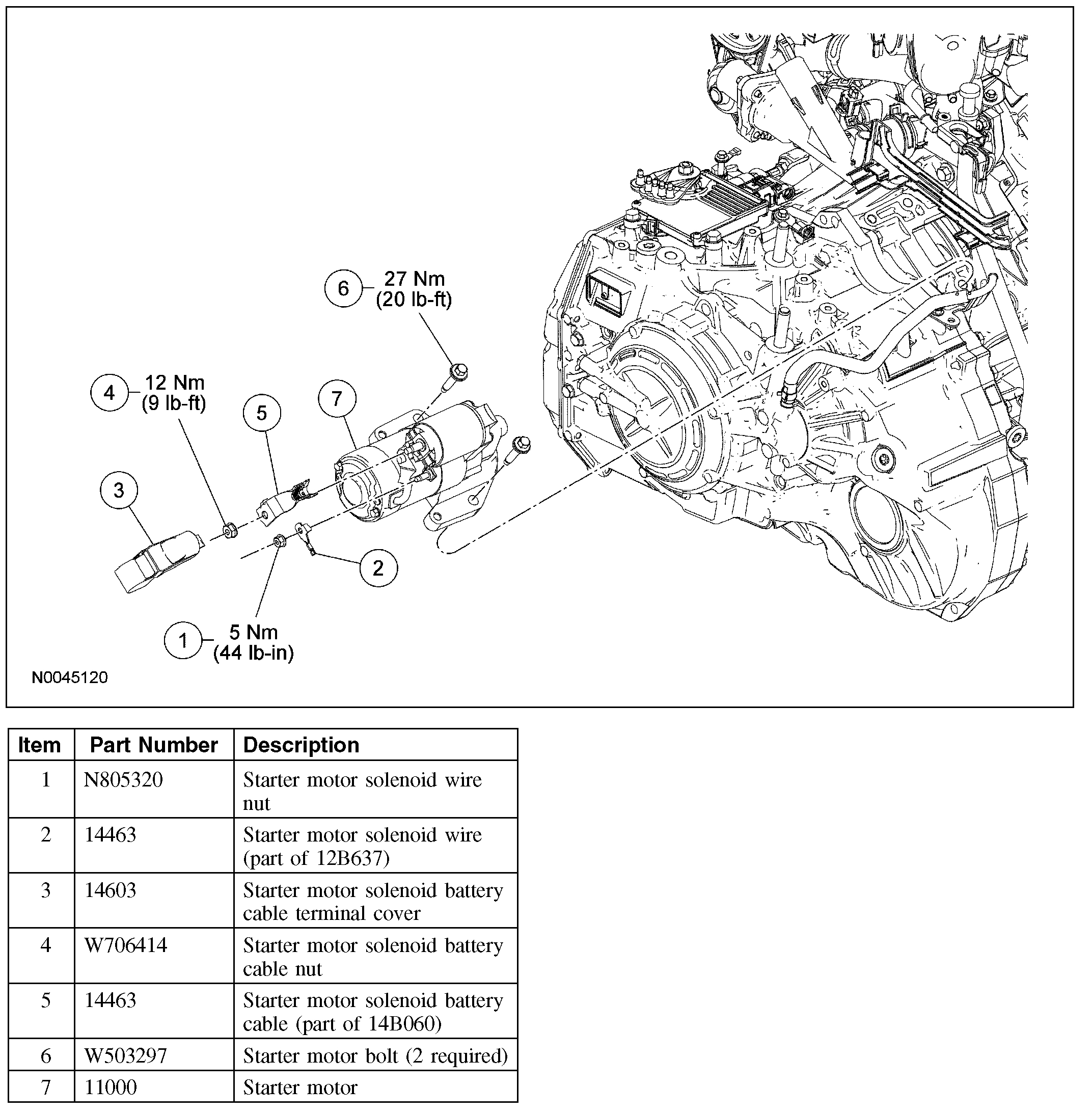

Here are the directions specific to your vehicle for removal and replacement. The attached picture correlates with these directions. When removing it, inspect the wiring to make sure nothing has melted and may be shorting, specifically in this case, the smaller wire on the starter.
___________________________
PROCEDURES
STARTER MOTOR
Removal and Installation
WARNING: When carrying out maintenance on the starting system, be aware that the heavy gauge leads are connected directly to the battery. Make sure the protective caps are in place when maintenance is completed.
1. Remove the battery tray.
2. Remove the starter motor solenoid wire nut and position the wire aside.
- To install, tighten to 5 Nm (44 lb-in).
3. Position the starter motor solenoid terminal battery cable cover aside.
4. Remove the starter motor solenoid battery cable nut and position aside the cable.
- To install, tighten to 12 Nm (9 lb-ft).
5. Remove the 2 starter motor bolts and the starter motor.
- To install, tighten to 27 Nm (20 lb-ft).
6. To install, reverse the removal procedure.
