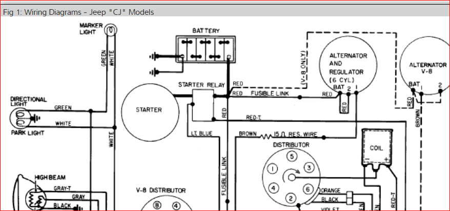

Hello, I bought this vehicle without a starter. I am wondering if you have a picture showing where the two wires connect?

I have attached a picture from a wiring diagram. Hope this helps and feel free to ask any questions. Thanks for using 2CarPros.

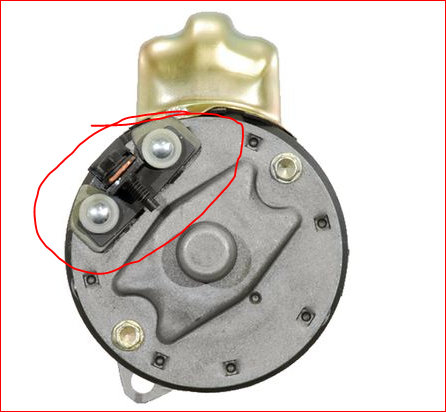

Sweet! Thank you! Do you know if the positive wire connect to the bolt in the front of the starter or back?

It would be on the back. I have attached a picture and circled in red. Hope this helps and thanks again for using 2CarPros.
