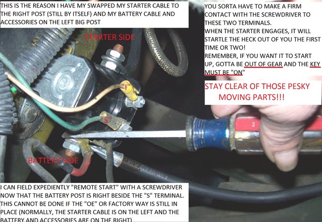

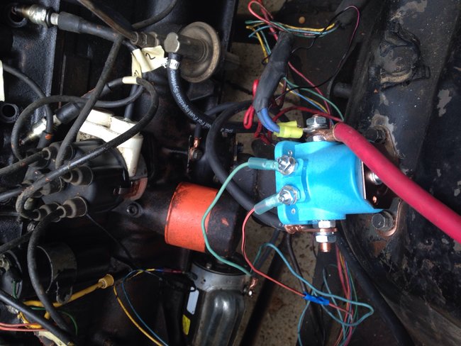

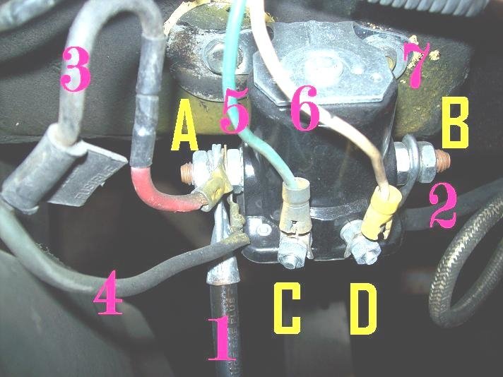

Insure the battery cable and accessories are on one big post all together (A in picture on my Jeeps)
Insure the starter cable is on the other big post- all by itself (B in my picture)
(which big post does not matter, as long as the starter is all by itself on one of them)
I like my Positive cable and accessories on the big post closest to the "s" terminal so that I can crank/ bump the the starter with a screwdriver if need be
The one from the ignition switch will so to small terminal "s" on the solenoid (location C in my last picture), the other wire goes to "I" (which feeds the coil while cranking)(D in pic)
Points?/ Prestolite Ign?/ Other?
Any other non-OEM modifications on your baby?

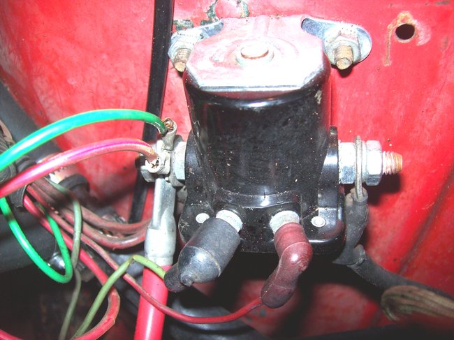

Here's a picture of my 1977's solenoid.

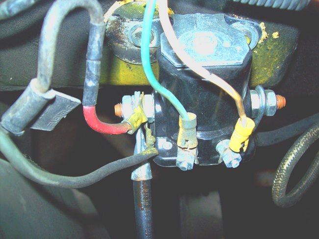

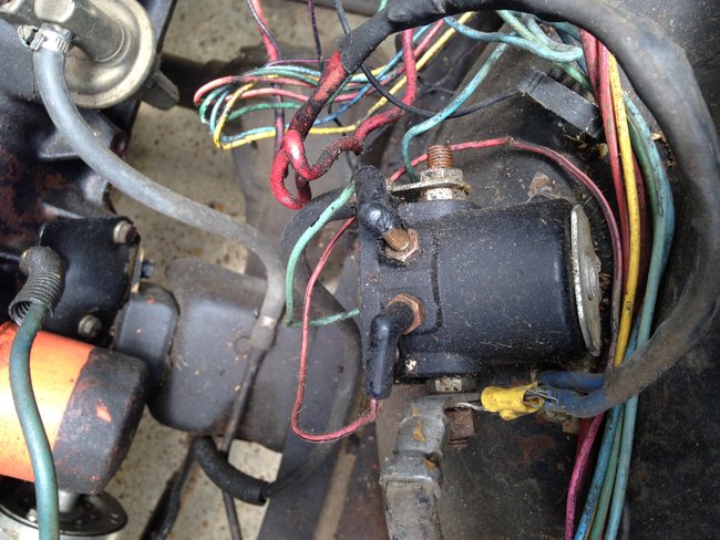

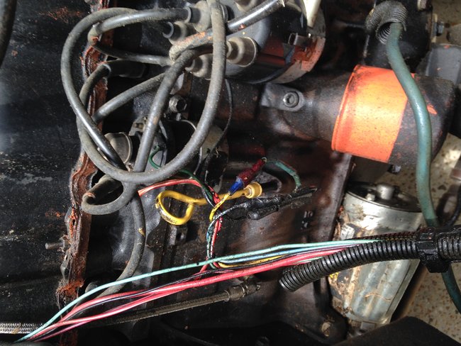

Pictures of old solenoid.

It looks to be wired correctly
The only other possibilities (if the new one don't fix it) Might be a bad ignition switch or a "hot wire" somehow connected or crossed up with "S-WIRE"
Yours being just like factory (positive battery cable and accessories on the right side (bottom in your pic) Starter on the left by itself (top in your pic)
I have mine opposite, you can see my reason in the 1st pic
In your pic on the accessory side (big post on bottom in pic) Looks like some of your wires are fraying out of the "stake-ons"!
The glimpse of the front of your distributor tells me that you have "Prestolite Ignition"
Let us know if the "Solenoid" fixes you up!
Keep shootin' questions if you have any.

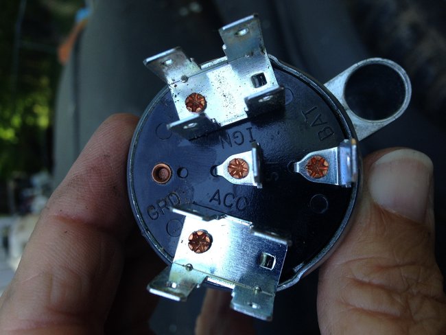

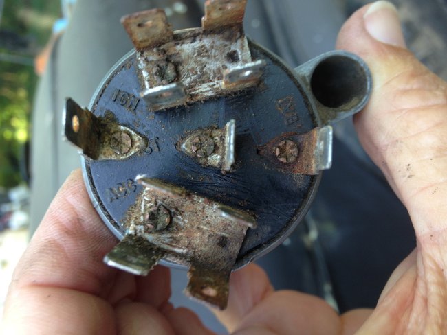

Pics of old key switch and new switch

I found the same as your old one at rockauto.com
I found it under a 1974 cj-5
Here's the link
http://www.rockauto.com/en/moreinfo.php?pk=936689&cc=1180583&jsn=422
It may be that you can find it local if you go with a '74
Also insure that your starter cable (metal below the ring) is not touching "metal" on the bottom of the solenoid- kinda looks close in the pic
I'd say the other terminal is necessary/ 'specially if this issue did not arise until you tried the new switch
Thanks for the pics they help us a lot! Not too many people post 'em for us.

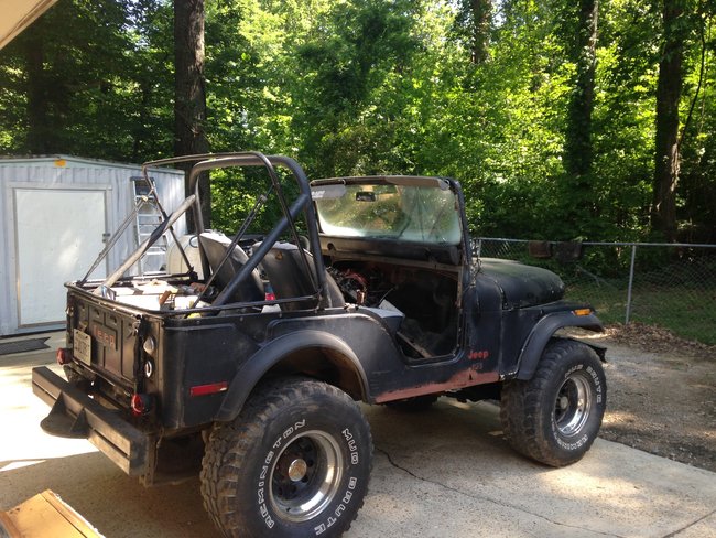

We still ain't seen a picture of this "Jeep" that you coulda just made up all along!
But really, We are glad you have it running right!
Wave at them other CJs, one of 'em might be me!
The Medic
Jun 19, 2016 at 4:34 PM
SPITNHIT
  • 23 POSTS

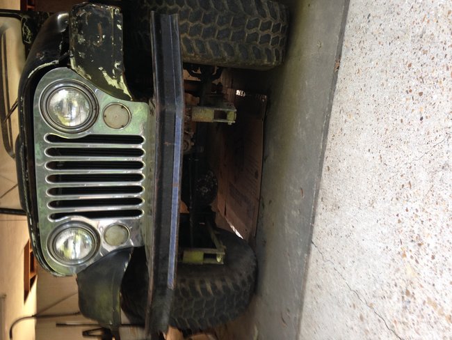

My toy! I've had it since mid April, spent the first 3 weeks going over everything. The VIN proved I had a '75 CJ5 but was originally built with a 232ci, I6. The engine code proved different, it's a 258ci, I6 from a '78 CJ5.
