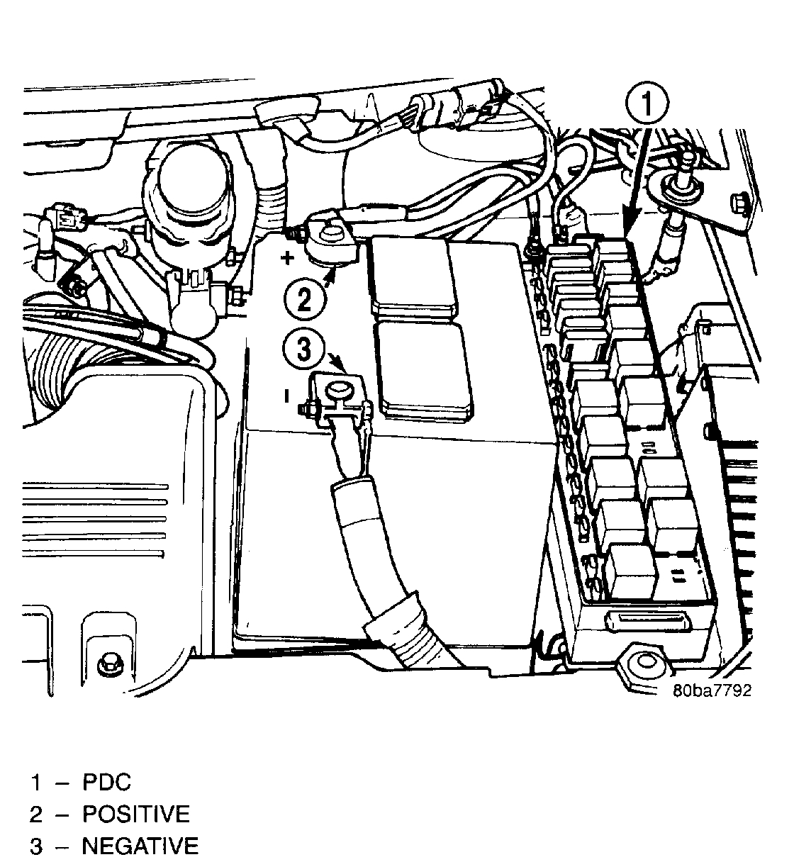

Battery Negative Cable
pic 1
2. Disconnect and isolate the battery negative cable.

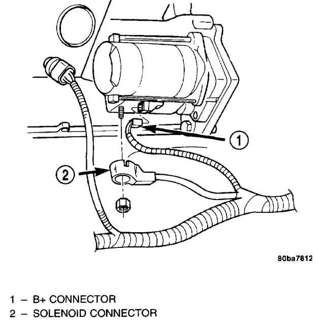

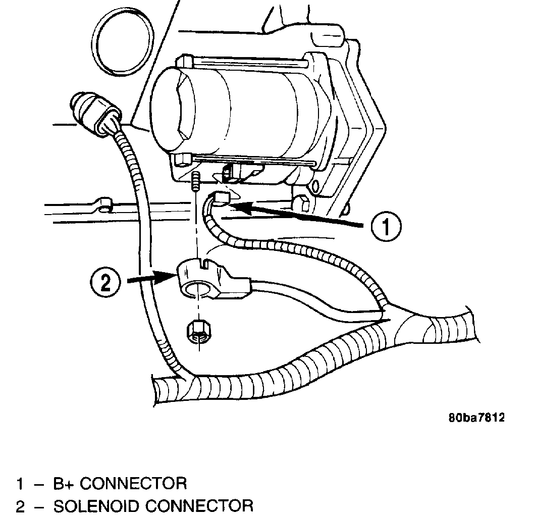

Starter - Engine Wire Connectors
pic 2
4. Remove nut holding B+ terminal to starter solenoid.
5. Disconnect solenoid connector from starter.

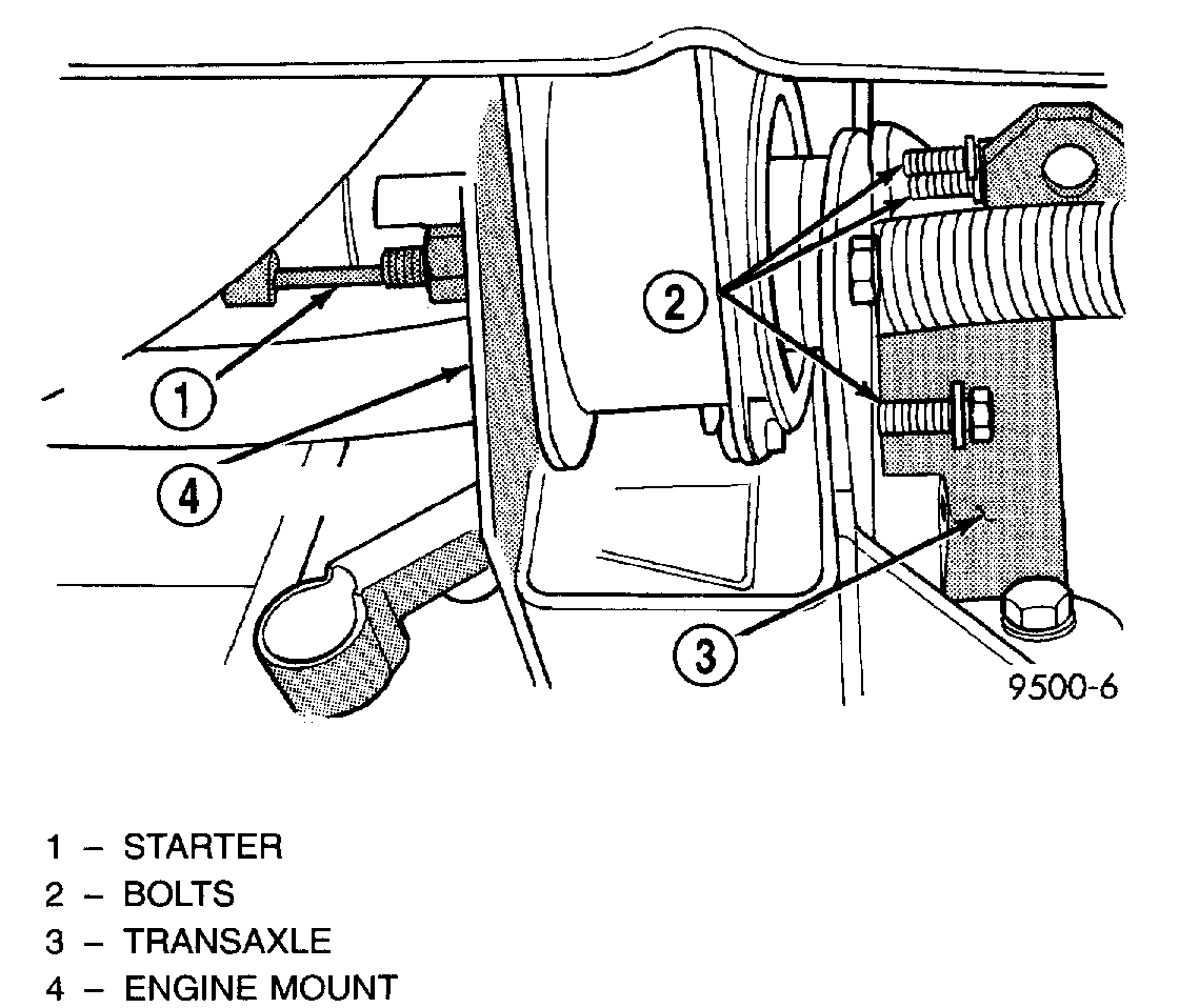

Starter Bolts
pic 3
6. Remove bolts holding starter to transaxle bellhousing.

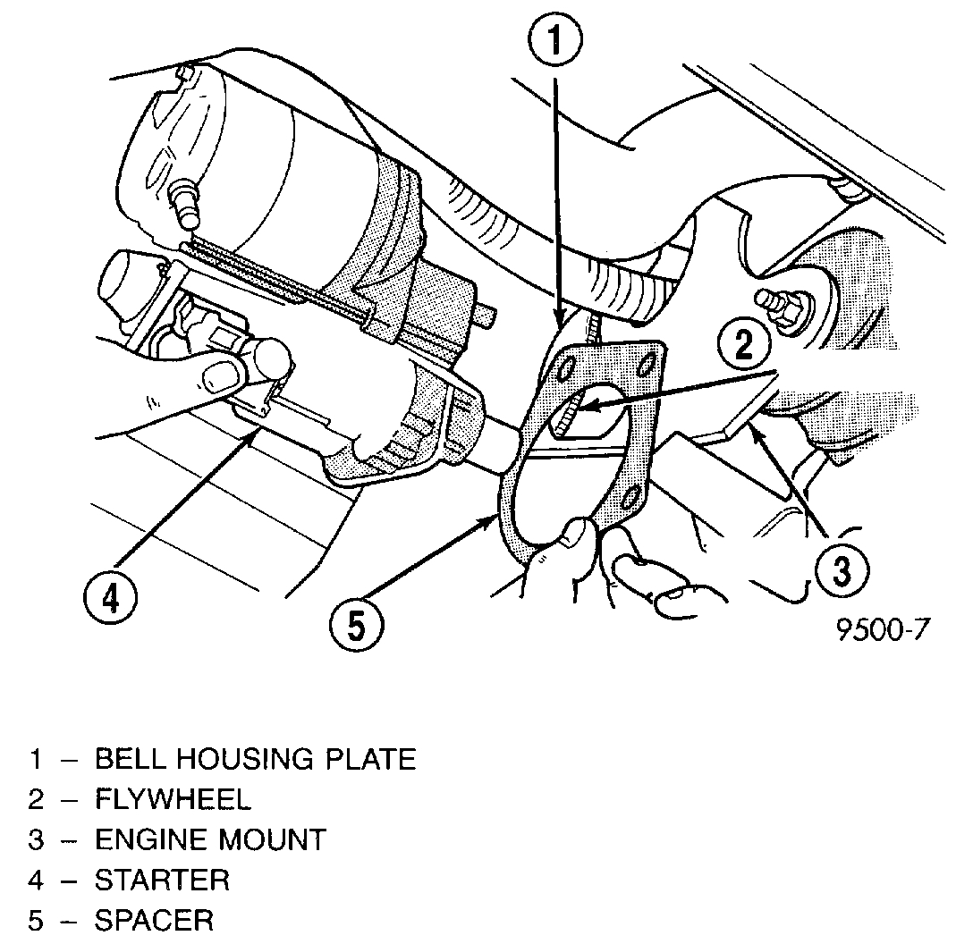

Starter
pic 4
7. Remove starter from bellhousing.
8. Separate starter spacer from transaxle bell housing.
