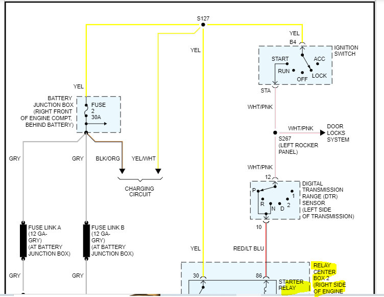

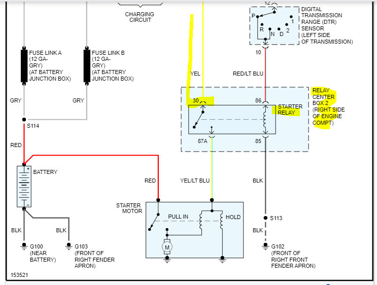

My car has a 30-amp fuse for the starter/alternator and every time I try to replace the fuse, it blows the moment it makes contact with its slot. All other fuses are good. I checked the battery, starter solenoid and alternator to make sure everything was properly connected with no damaged wires, and I couldn't find anything out of the ordinary. I assume it has a short somewhere. Has anybody come across this? Any suggestions?
