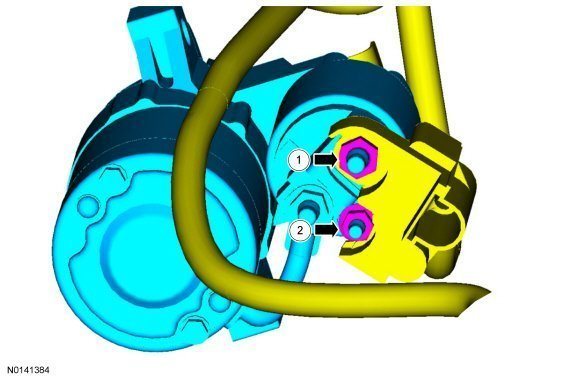

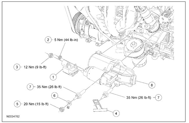

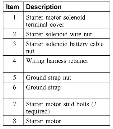

Where is the starter located and how hard is it to change on my own?
Sep 20, 2019 at 10:10 AM
BMDOUBLE
  • 1,139 POSTS

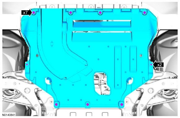

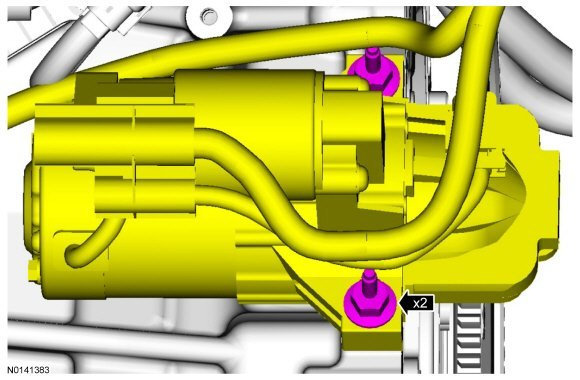

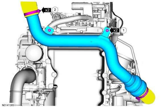

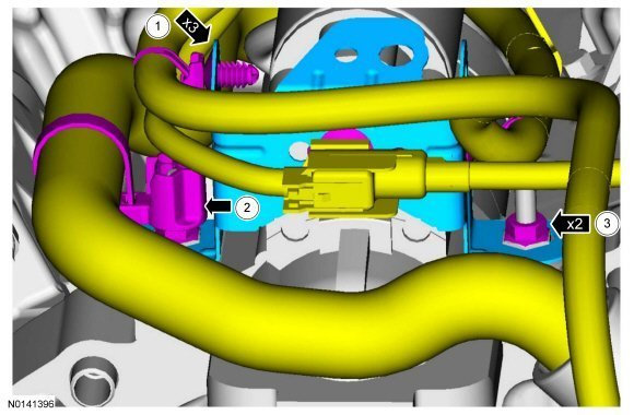

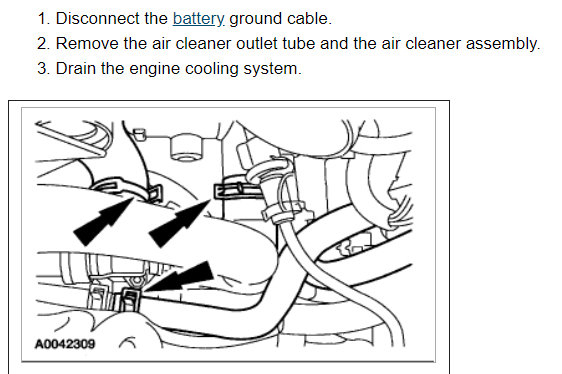

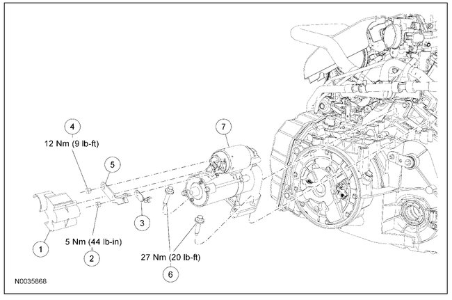

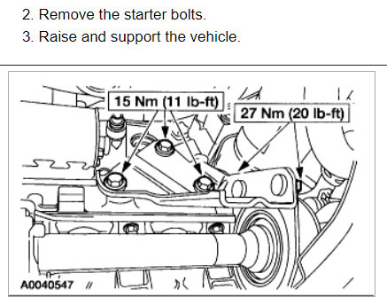

It's on the front side of the block and is not that difficult at all, but will take a little bit of dismantling the charge air cooler pipe from the under side of the vehicle. I've attached some pictures of the process.
This guide will help walk you through the steps with diagrams for you car below.

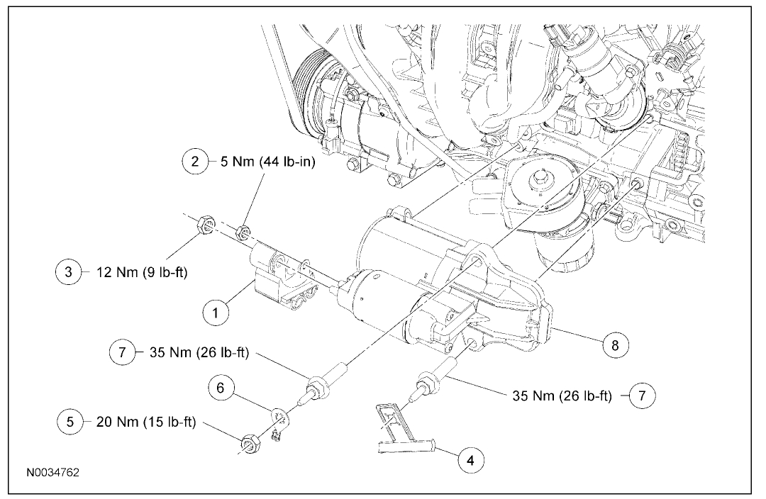

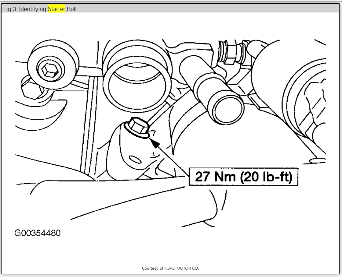

If you have a non hybrid car here is a guide to help you see what you are in for when doing the job.
Here are diagrams for what it will be like for your car I have included both engines

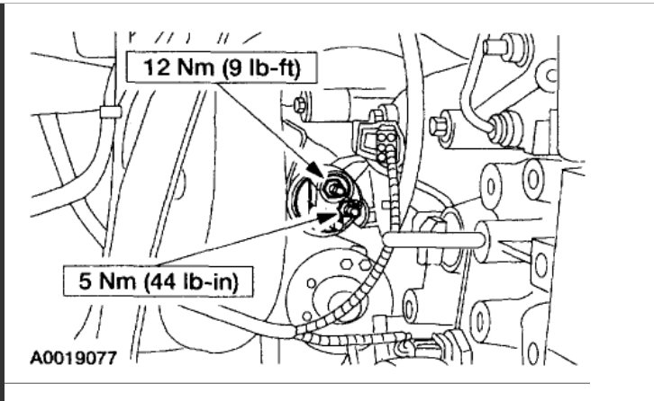

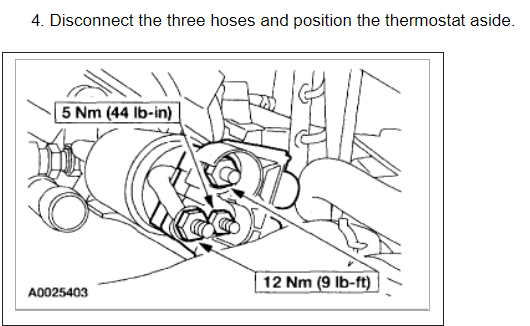

How do I replace starter motor on 2003 ford escape v6? I looked and I can't figure it out. Please help me!
May 23, 2020 at 11:02 AM (Merged)

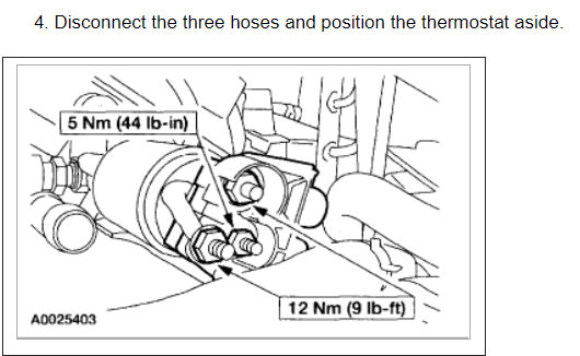

Hey Mastied,

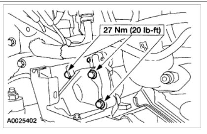

Here are the instruction you needed
Disconnect negative battery cable. Remove air cleaner outlet tube and air cleaner assembly. Drain engine cooling system. Disconnect the 3 hoses and position thermostat aside. Remove starter solenoid cable nuts and position solenoid cables aside. See Fig 8 . Remove starter motor mounting bolts and starter motor. See Fig 9 . To install, reverse removal procedure. Tighten bolts to specification. See TORQUE SPECIFICATIONS
Here is a guide that will show you what you are in for
Please let us know happens so it will help others.

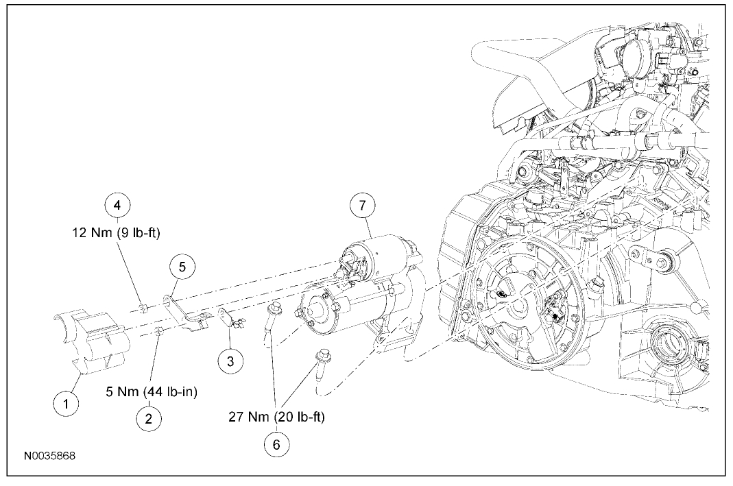

Here are start motor diagrams for what it will be like for your car (below) both engines.
