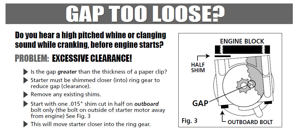

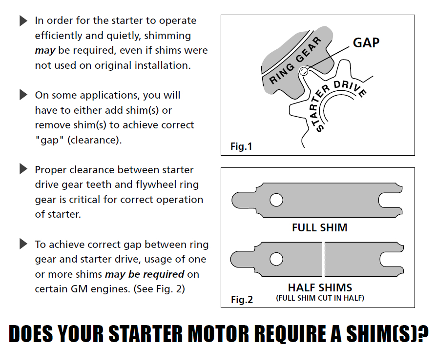

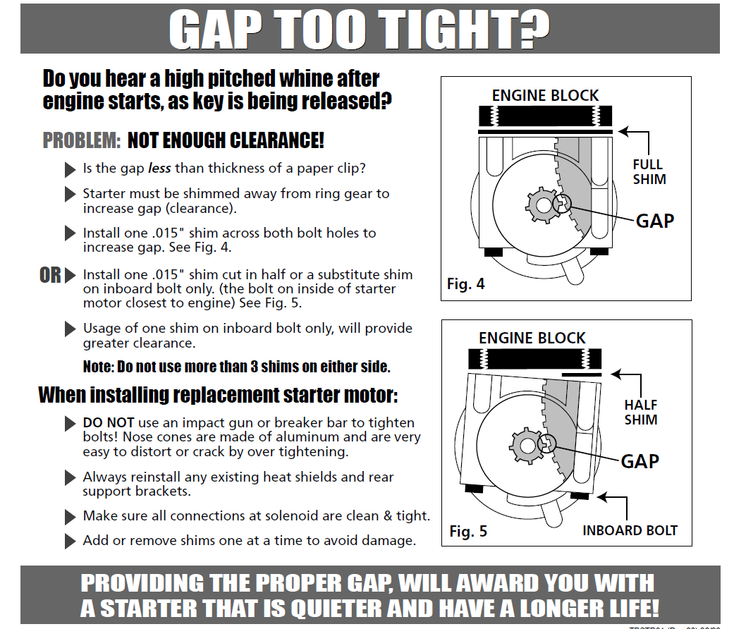

inserted key to start engine. all i got was a winding noise.
took the starter to Advanced auto,they found the seleniod was bad.
put a a new used rebuilt starter would not stop cranking. checked my connections to see if i had wires touching, all good.
Took new starter back to Advanced auto machine said stater was good .
re installed and i got the winding noise again.
Any thoughts?
