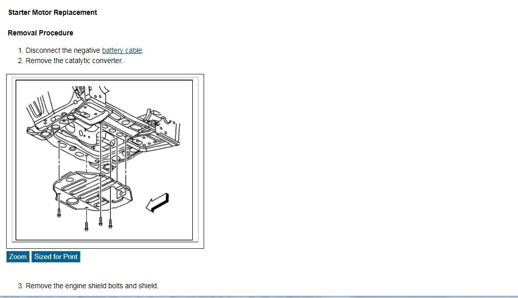

My car is not starting. All the lights come on bright and there is a clicking noise when i go to start it. I was told it is my starter but where is it located on my car?

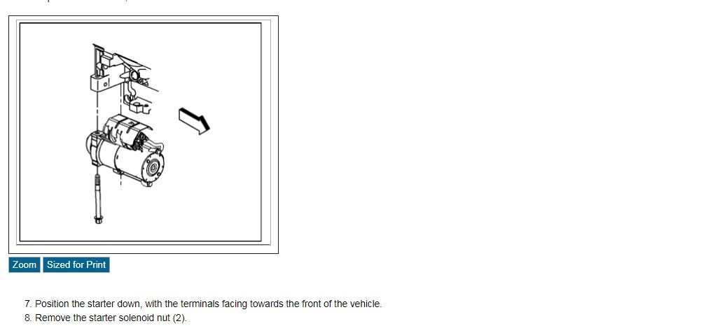

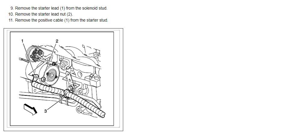

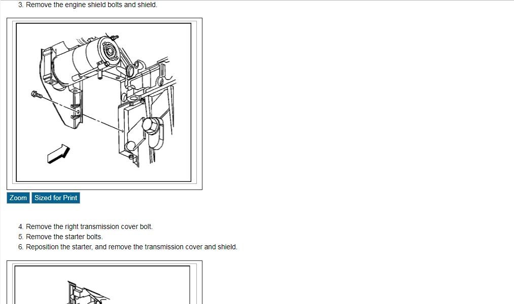

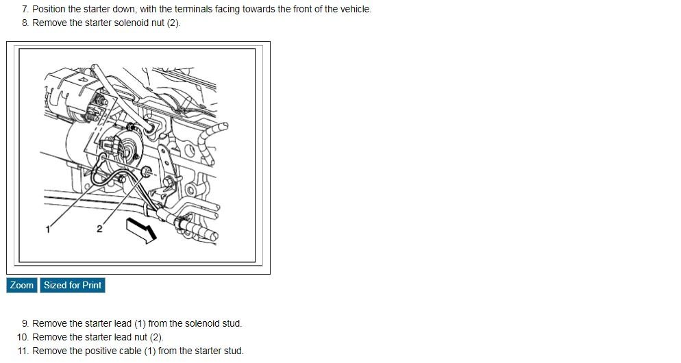

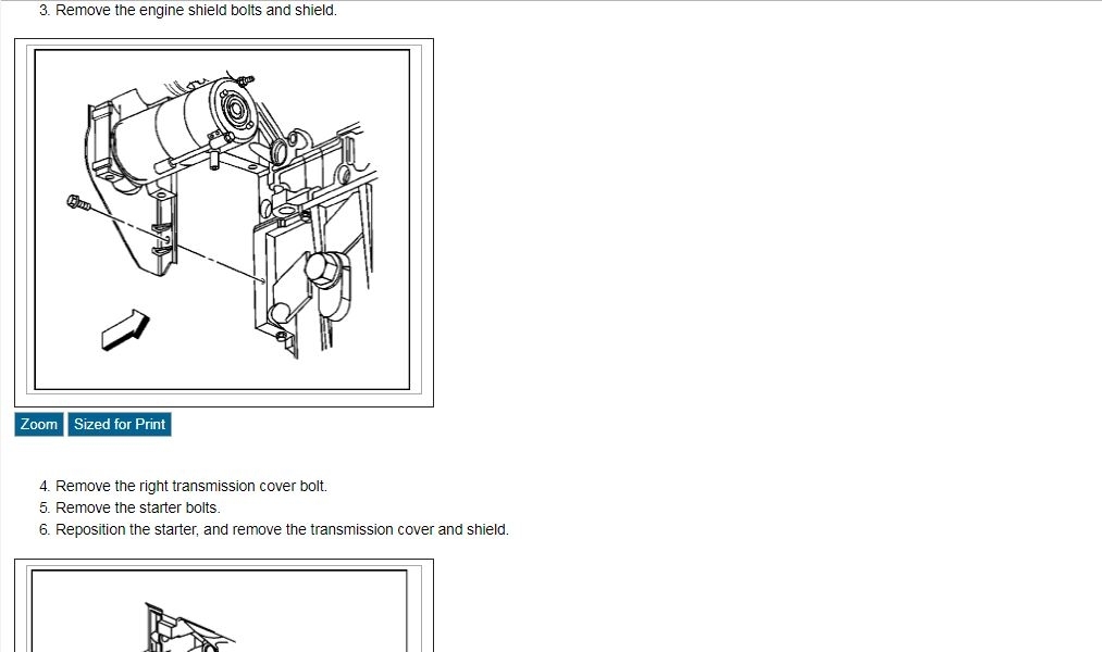

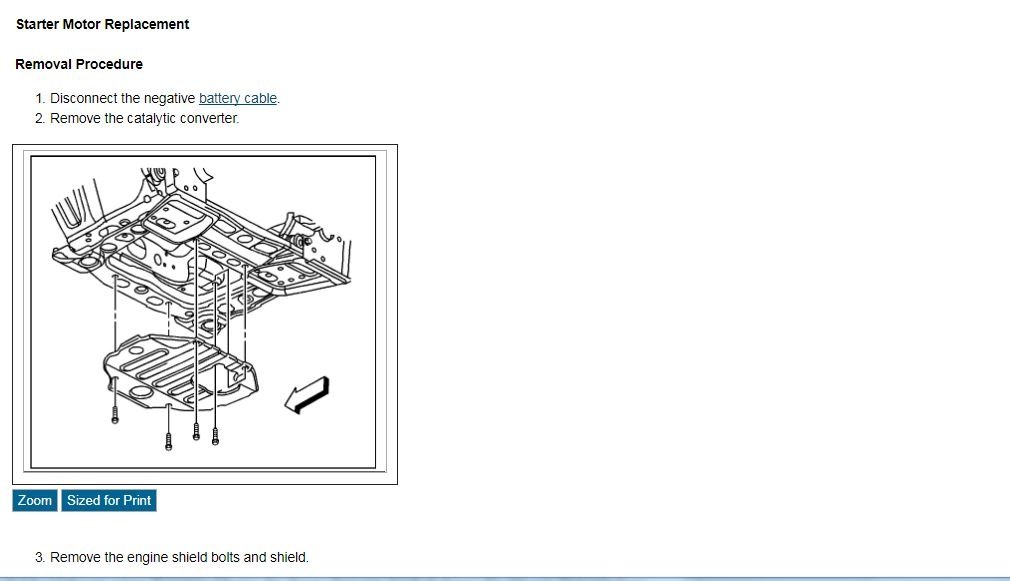

The starter is located under the truck, above a catalytic converter, and near the transmission. I have attached the removal procedure, captured from AllData. Installation is the reverse.
