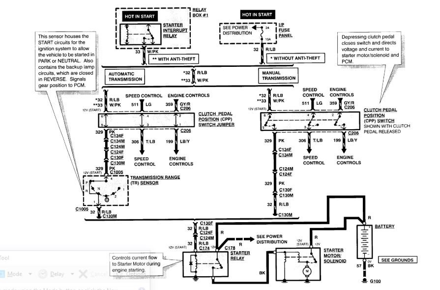

Good morning.
It is possible.
Does it ever disengage?
Can you post a picture of the solenoid wiring?
It could also be a stuck relay or the starter motor itself.

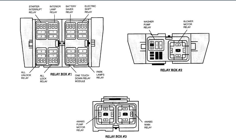

Before jumping into replacing the starter make sure the relay is releasing the power to the solenoid. It may be as simple as a relay.
Do not want you to spend a lot of money on something that will not fix it.
Nov 7, 2018 at 7:45 AM
SLEEVE44
  • 12 POSTS
Where exactly is the relay?
Nov 7, 2018 at 7:47 AM
Left front out by the headlight is a relay box.
Picture attached.
Nov 7, 2018 at 7:54 AM
SLEEVE44
  • 12 POSTS
I do not see a relay in front by the light. Could it be in the fuse box?
Nov 7, 2018 at 3:29 PM
It will be in a relay box, yes.
Nov 7, 2018 at 3:37 PM
SLEEVE44
  • 12 POSTS
I see the relay box up by head light, but it only houses relays to blower and the window washer.
Nov 7, 2018 at 3:39 PM
There should only be one blower relay.
Have someone try to start the truck and see if you feel one of the relays click. If you are worried about the starter sticking, then remove the small wire on the starter solenoid. That will not stop the relay from working.

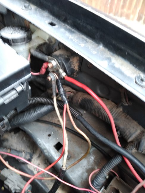

Can you tell if the solenoid is wired right?
Nov 10, 2018 at 12:18 PM
Wow! No it is not.
The positive battery cable goes to one stud. all the other big eyelet wires go on that stud as well as they feed other systems.
The wire to the starter motor goes on the other stud. No other wire should be on there. That is why you have your issue.
The little wire is good.
Nov 10, 2018 at 12:54 PM
SLEEVE44
  • 12 POSTS
Thank you very much.
Nov 10, 2018 at 12:56 PM
You are welcome.
Always glad to help.
Nov 10, 2018 at 1:03 PM
SLEEVE44
  • 12 POSTS
That solved the problem.

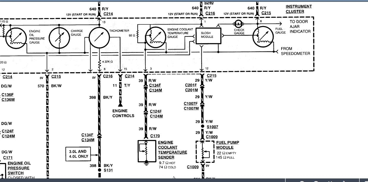

Now I have another problem. I cannot get my fuel gauge to work.
Nov 10, 2018 at 2:56 PM
Okay, sorry, traveling
Did you check for power to the sender at the fuel tank?
Diagram attached.
Check the yellow/white wire for power with the key on.
