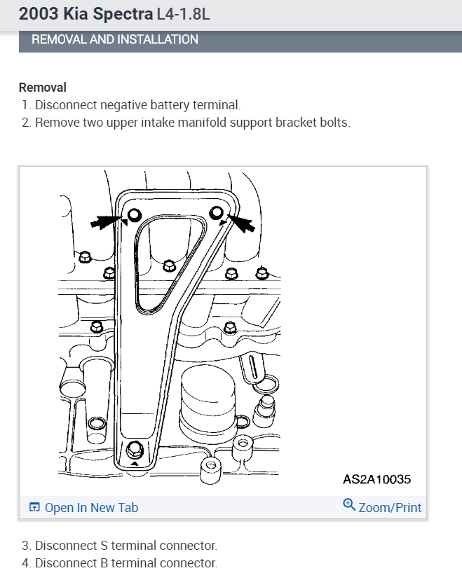

I'm trying to locate where the starter is and I can't find it.
Jul 4, 2019 at 9:07 AM
Good afternoon,

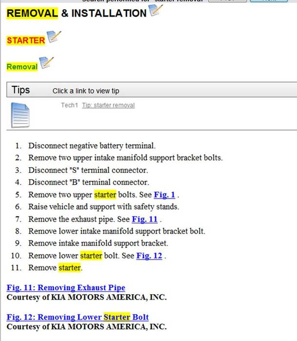

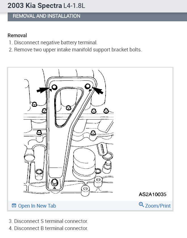

I attached a picture for you to view. I attached the procedure for you as well. Check out the diagrams (Below). Please let us know what happens.

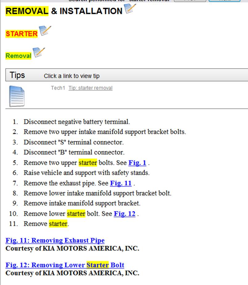

How to replace a starter in a 4 cylinder 16 valve Dohc. I would like to know the best possible way to replace this from the car on the ground.
Oct 7, 2020 at 11:58 AM (Merged)
IMPALASS
  • 3,112 POSTS

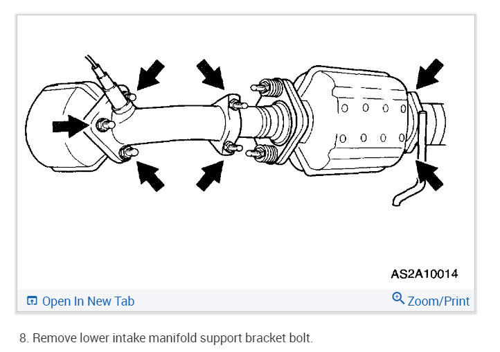

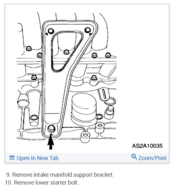

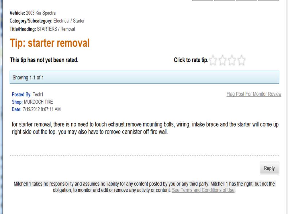

Hello I have provided the removal and installation according to the manual. I have also included a tip that provides a different way. This will also be in two parts....removal and installation
Here is a guide that will give you an idea as well.

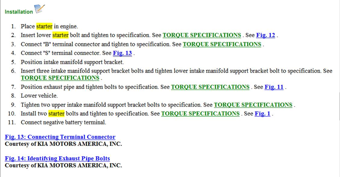

Here is the installation

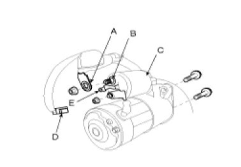

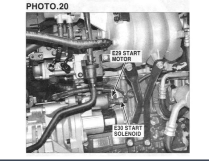

Look under the car, it will be between the engine and transmission on the passenger's side. Here is a guide to walk you through the steps and diagrams below to show you on your car.

The starter mounting bolts should have been torqued to 27 - 38 Foot Lbs. This grinding could also occur if the starter electrical connections are hooked up in the wrong spots. Since the fuse blew and was getting the noise, my bet would be on the wiring, not the mounting bolts..

Either the wiring is not hooked up in the correct spots on the starter OR the wiring harness itself is bad.

if it's grinding now then just switch the spot and see if it resolves problem
