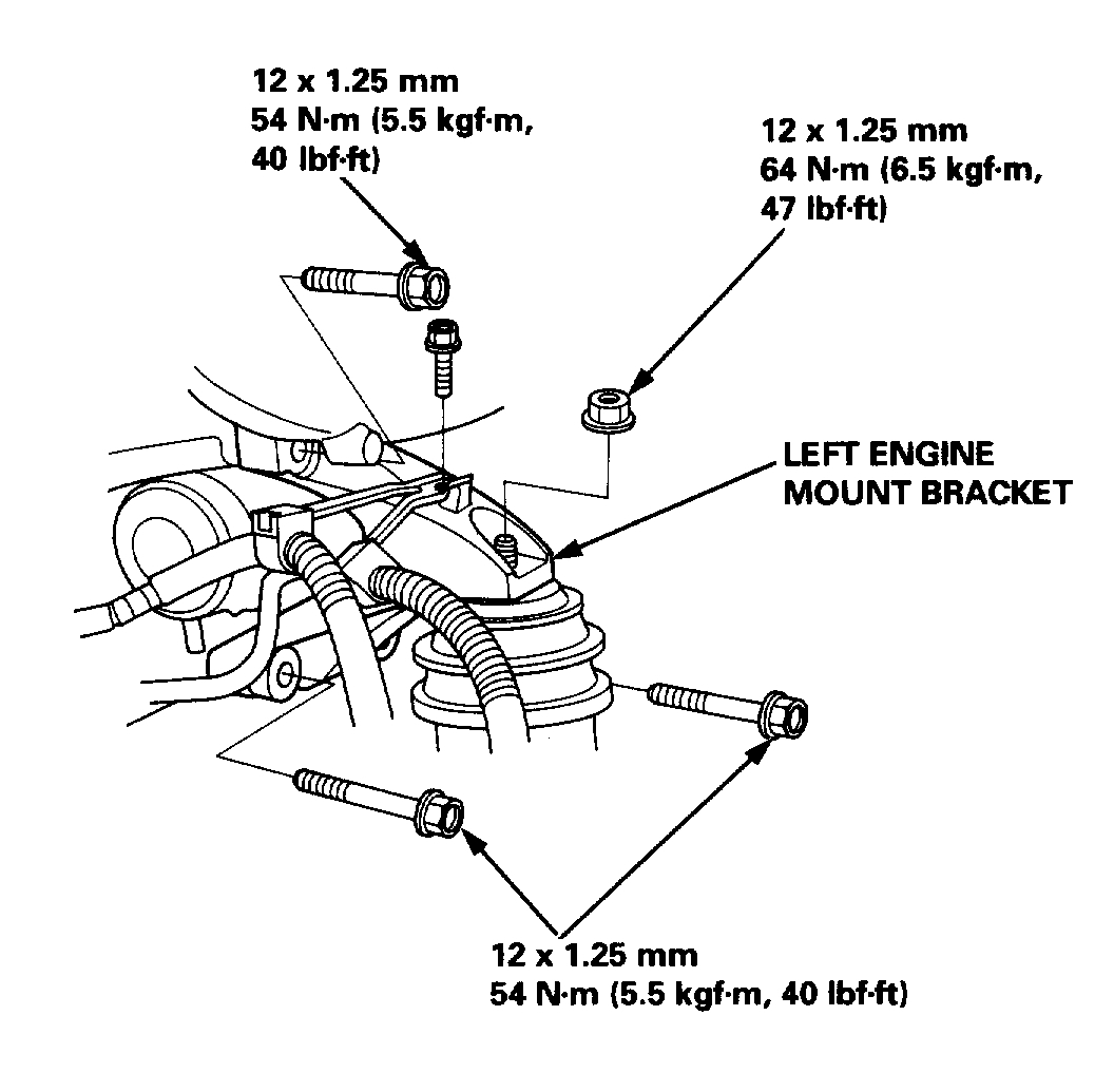

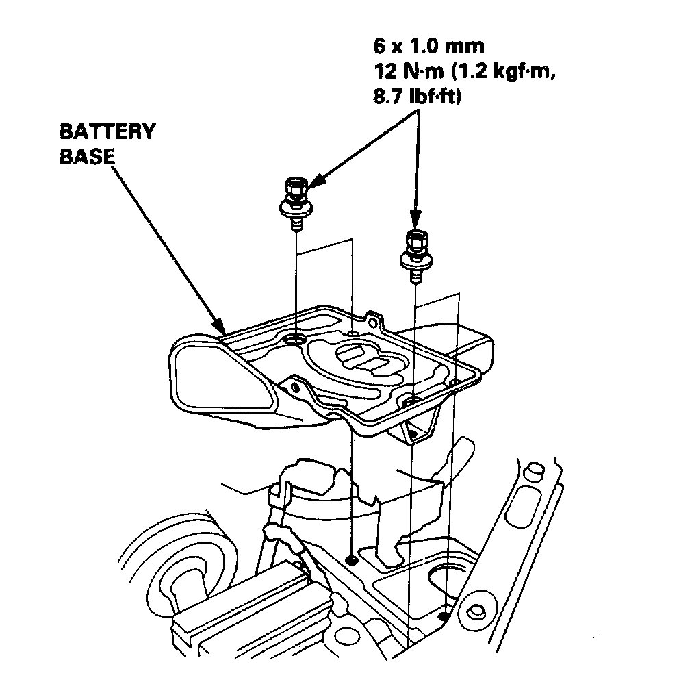

3. Raise the coolant reservoir, then remove the battery and battery base.
4. Remove the alternator belt and alternator.
5. Remove the left exhaust manifold cover.
6. Remove the left damper fork.
7. Disconnect the left suspension lower arm ball joint.
8. Remove the left driveshaft.

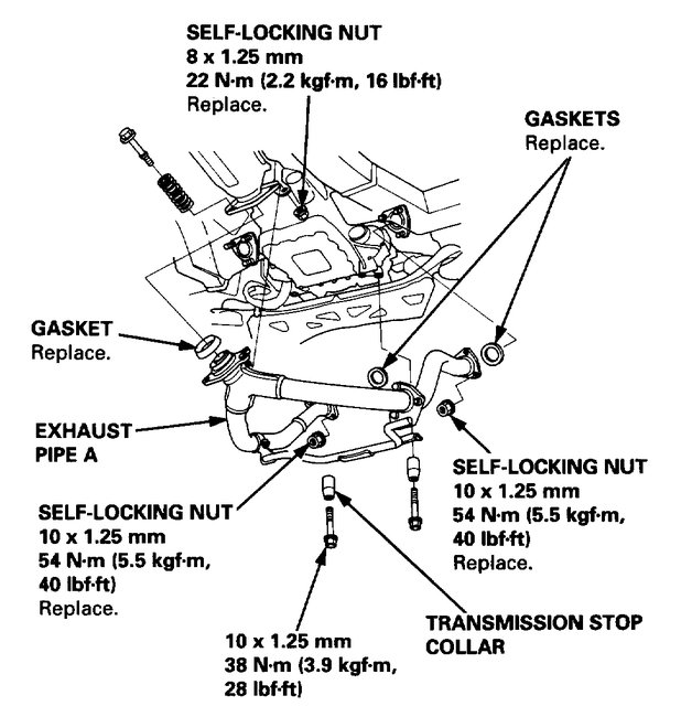

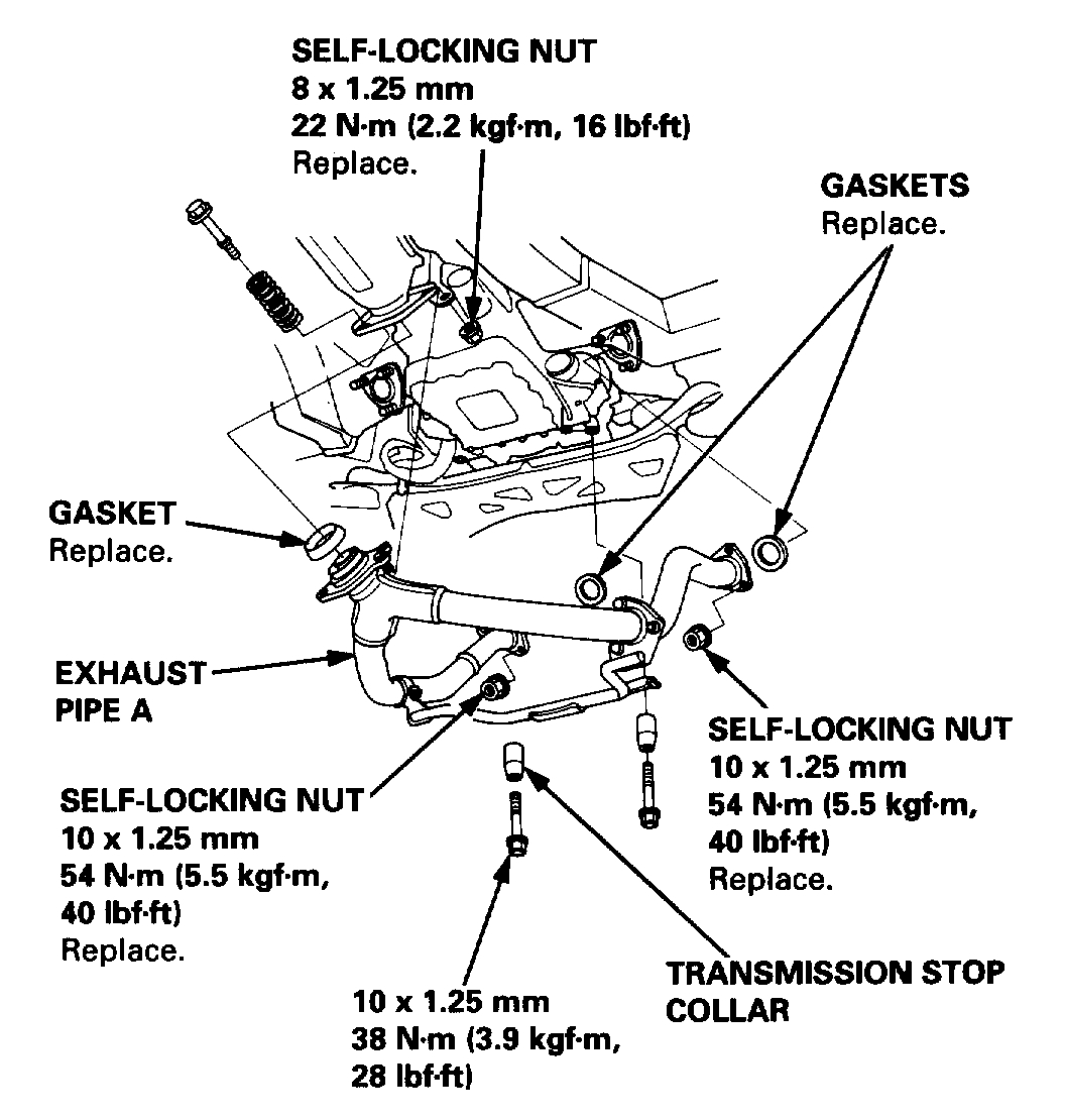

9. Remove the transmission stop collar, then remove the exhaust pipe A.
10. Remove the front mount mounting bolts.

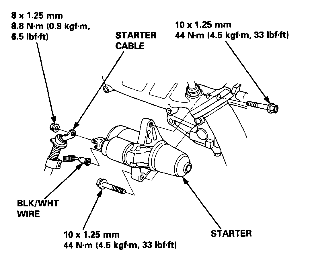

13. Disconnect the starter cable and BLK/WHT wire, then remove the starter.

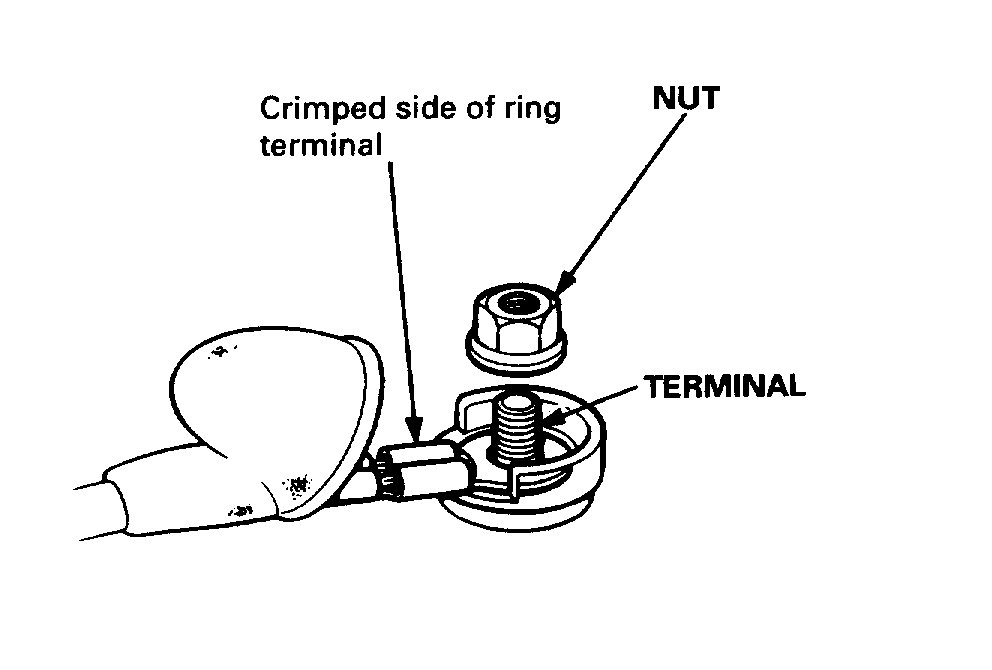

14. Install in the reverse order of removal.
NOTE: When installing the starter cable, make sure that the crimped side of the ring terminal is facing out.
