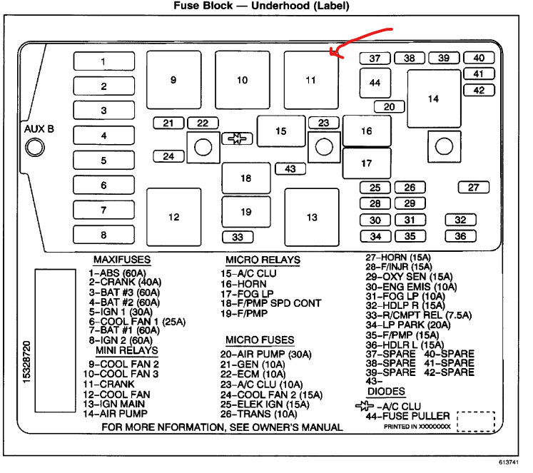

when trying to jump start starter motor engages?
2001 BUICK REGAL
200,000 MILES
JIM DEAN JR.
Sep 9, 2024 at 10:18 AM
You probably have a starter motor solenoid that is stuck on but to be sure let's remove the CRANK relay from the main fuse panel to see if that makes a difference. Here is the location in the images below. Check out the images (Below). Please let us know what happens.
Sep 9, 2024 at 12:04 PM
