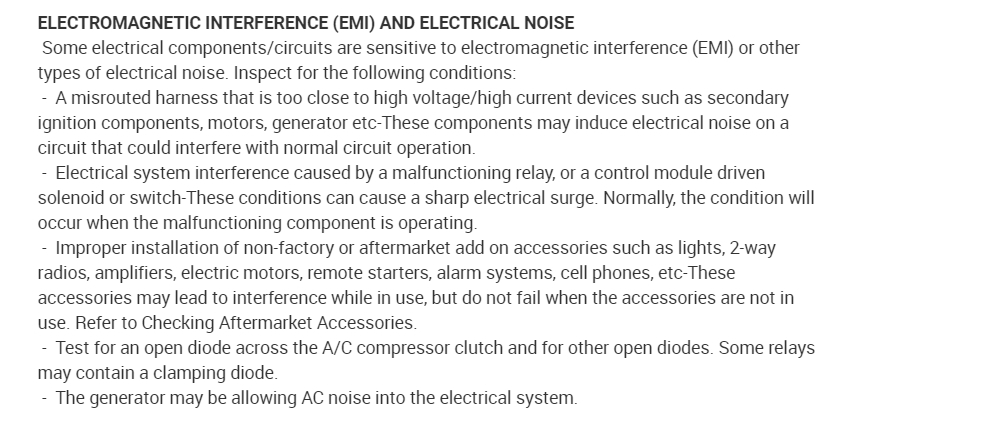

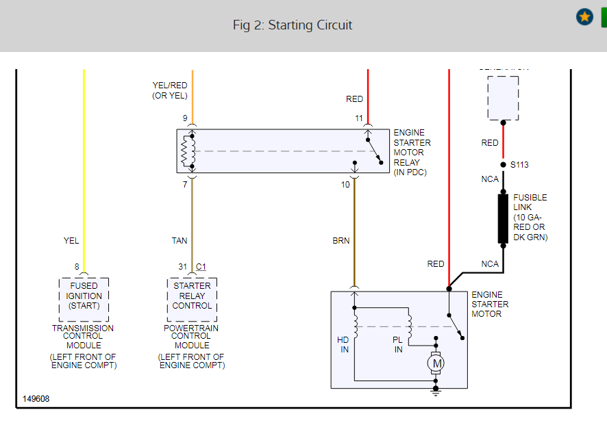

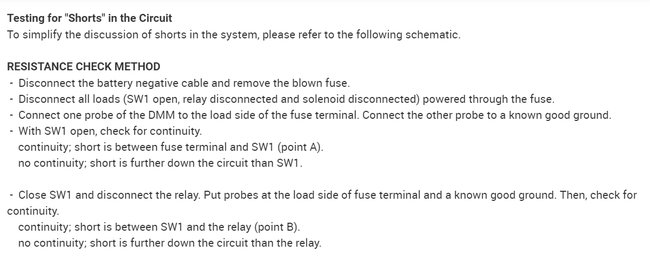

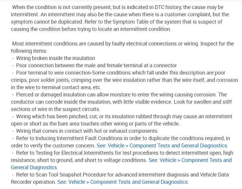

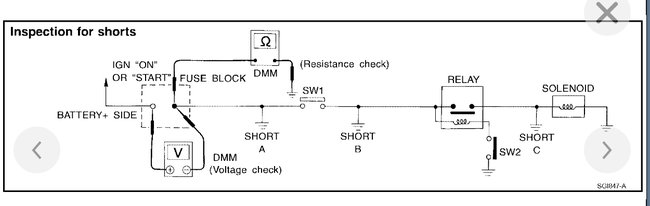

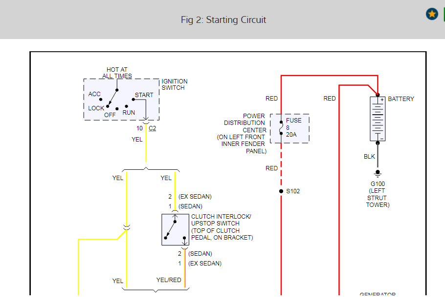

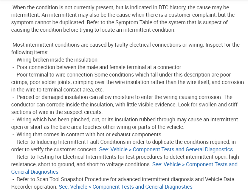

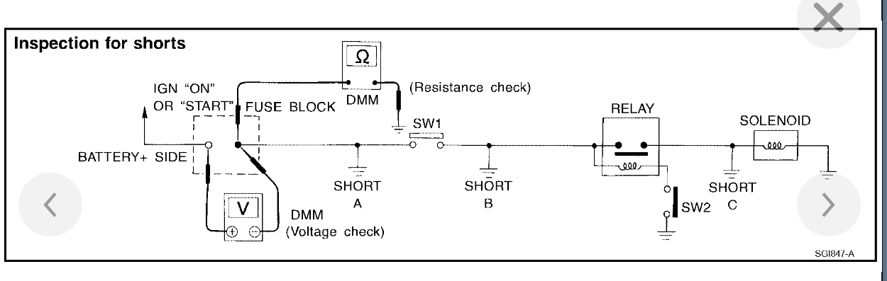

Car starts sometimes, sometimes it blows #8 fuse. ignition switch is good, fuel pump and relay are good. Starter relay is good.
Pulled starter had it bench tested and it shows good. is it possible to test good and still be bad?
