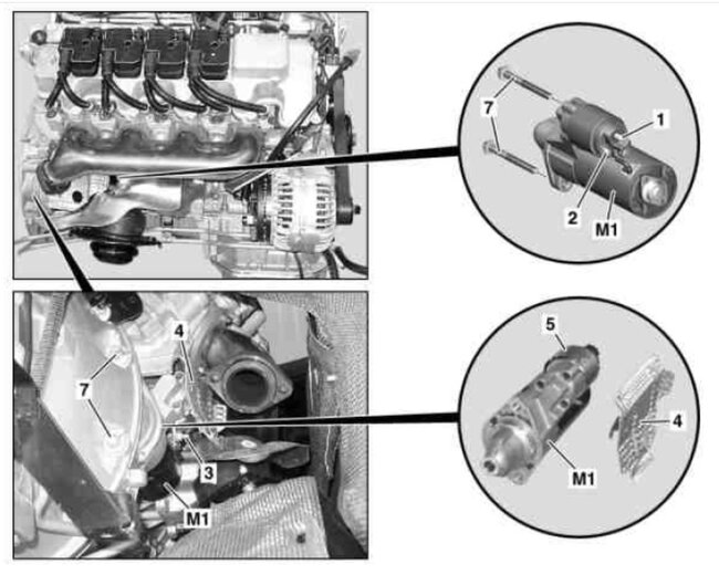

Location.Where is the starter located?
Nov 8, 2024 at 11:59 PM
CERTIFIED EXPERT
53,855 POSTS
The starter is located on the right side of the engine block near the flywheel/transmission. Check out the images (below). Let us know if you need anything else.
Image (Click to enlarge)
