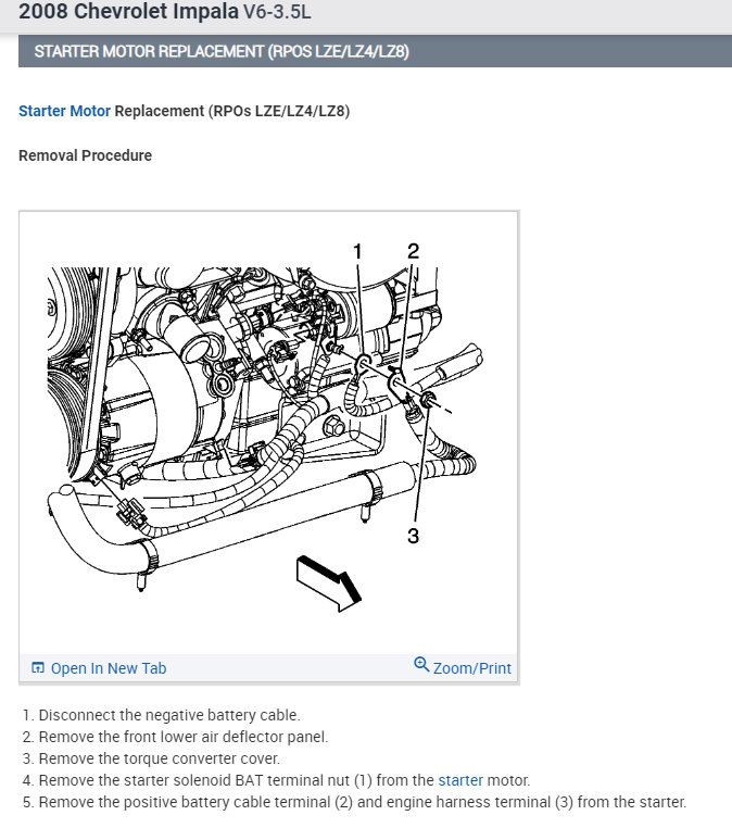

It sounds like the new starter is staying engaged longer than it is supposed to. Likely due to internal fault.
So, this will need to be replaced to prevent damage to other components like the flex plate.
Was this installed at a shop, or did you install the starter?
Either way it should be covered under parts warranty.
Let me know of any questions.
