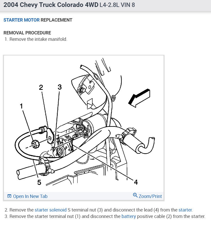

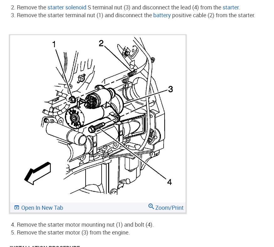

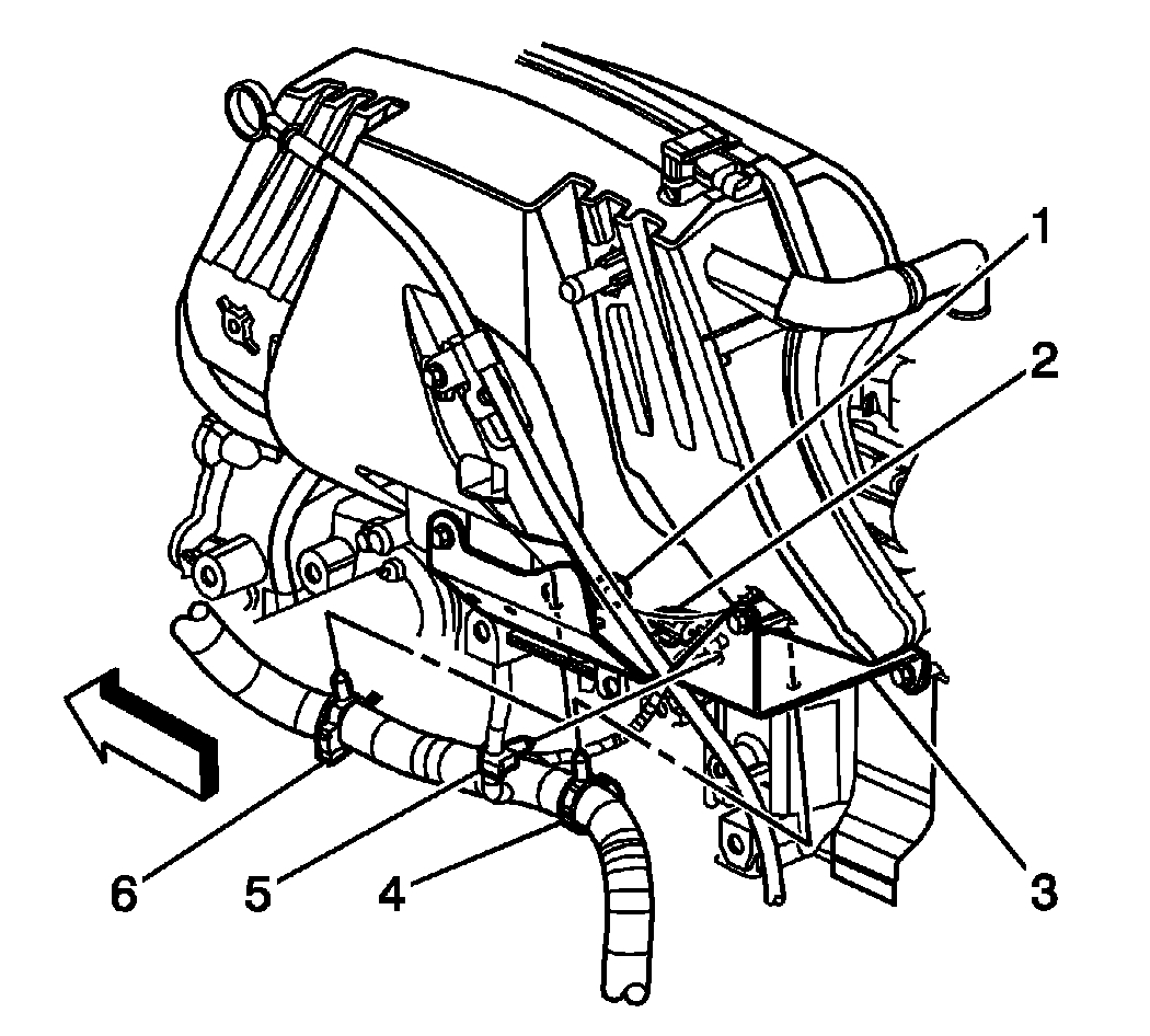

The five cylinder is the 3.5 and the starter is under the intake manifold.
It is a five hour job at the least.
Intake manifold replacement
Removal Procedure:
1.Remove the throttle body. Refer to Throttle Body Assembly Replacement in Engine Controls-3.5L (L52).
2.Remove the battery box. Refer to Battery Box Replacement in Engine Electrical.
3.Remove the oil level indicator and tube. Refer to Oil Level Indicator and Tube Replacement .
4.Disconnect the brake booster hose (6) from the brake booster.
5.Disconnect the MAP sensor electrical connector (3).
6.Disconnect the MAP sensor wiring harness retainer (4) from the intake manifold (5).
7.Disconnect the PCV dirty air tube (2) from the camshaft cover.
8.Remove the generator. Refer to Generator Replacement in Engine Electrical.
Fig 1: Identifying Intake Manifold External Components

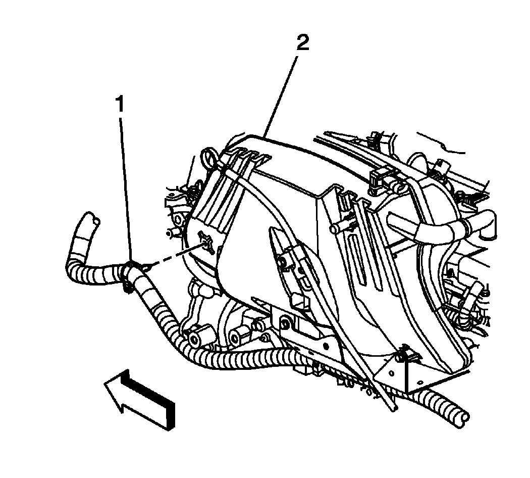

9.Disconnect the engine wiring harness retainer (1) from the intake manifold (2).
Fig 2: View Of Intake Manifold Engine Wiring Harness Retainer

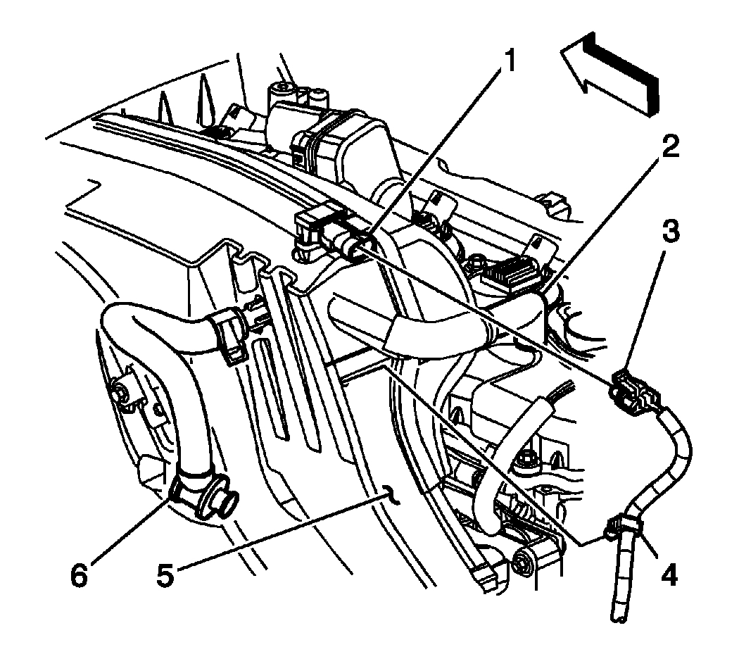

14.Disconnect the following wiring harness retainers from the engine wiring harness bracket:1.The battery cable
2.The engine (4, 6)
3.The MAP sensor (5)
Fig 4: Engine Wiring Harness Bracket Wiring Harness Retainers

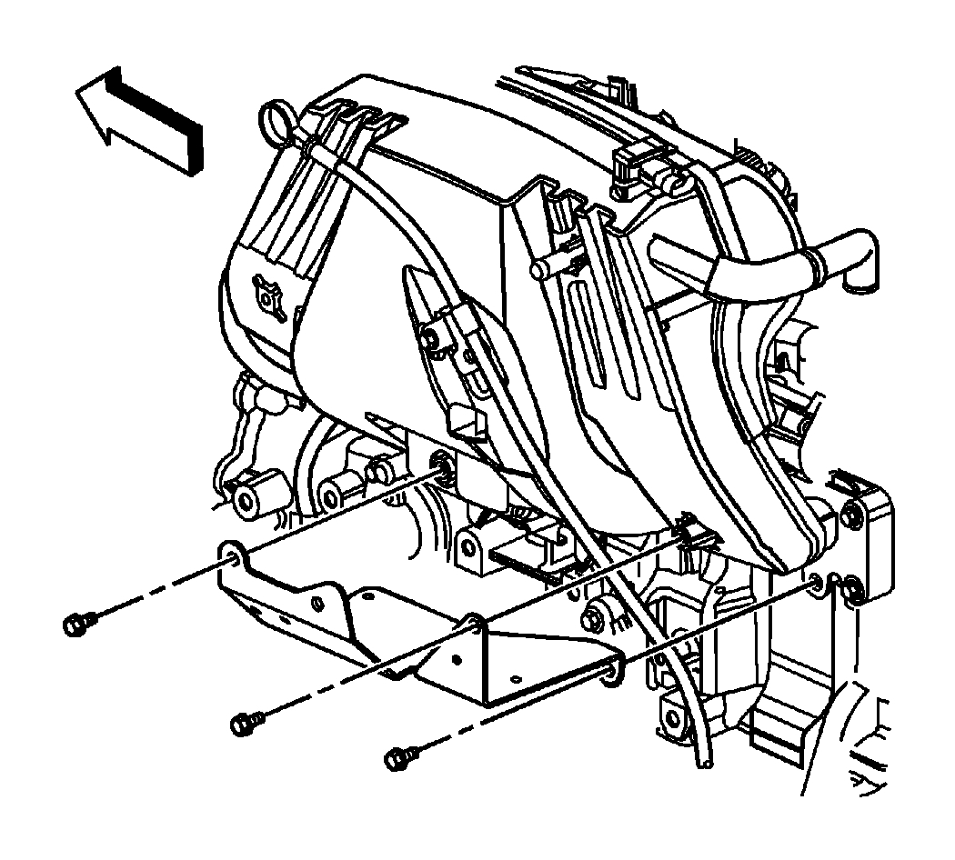

15.Remove the remaining engine wiring harness bracket bolt.
Remove the bracket from the engine compartment through the wheelhouse opening.
Fig 5: View Of Engine Wiring Harness Bracket

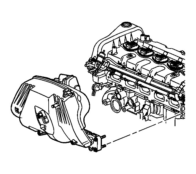

16.Remove the intake manifold bolts.
Fig 6: View Of Intake Manifold
17.Lower the vehicle.
18.Remove the intake manifold from the cylinder head.
19.Remove the seal from the intake manifold.
Discard the seal.
