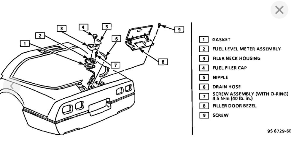

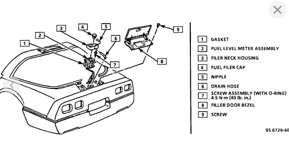

Due to the design of where the gas fill neck is located, I got rain water in the gas. This happened once before and my mechanic and I drained the tank, refilled it and it was fine.

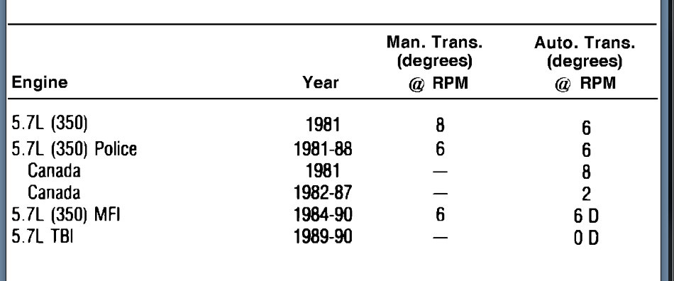

The most common cause of a misfire is a timing issue allowing unburned fuel to ignite in the intake due to the intake valve remaining open during ignition or it opens to soon and allows the ignited fuel to escape back into the intake.

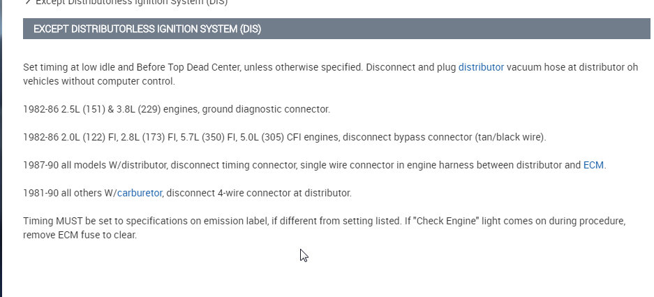

Your vehicle should have a distributor correct? If so, I would start with checking the timing.

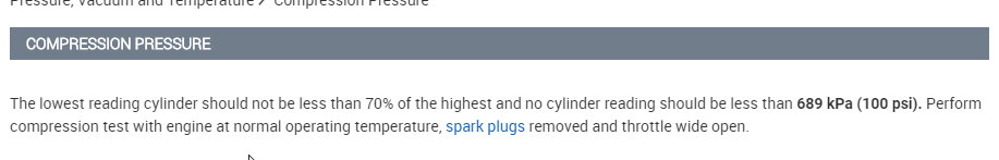

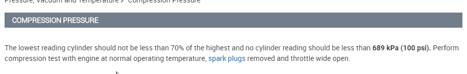

After this we need to inspect for vacuum leaks. With all that happened we could very easily have created a vacuum leak. Lastly we need to check compression. All of this is to verify base engine and go from there.
