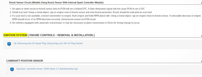

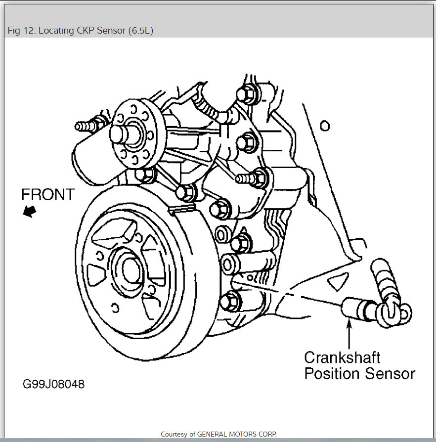

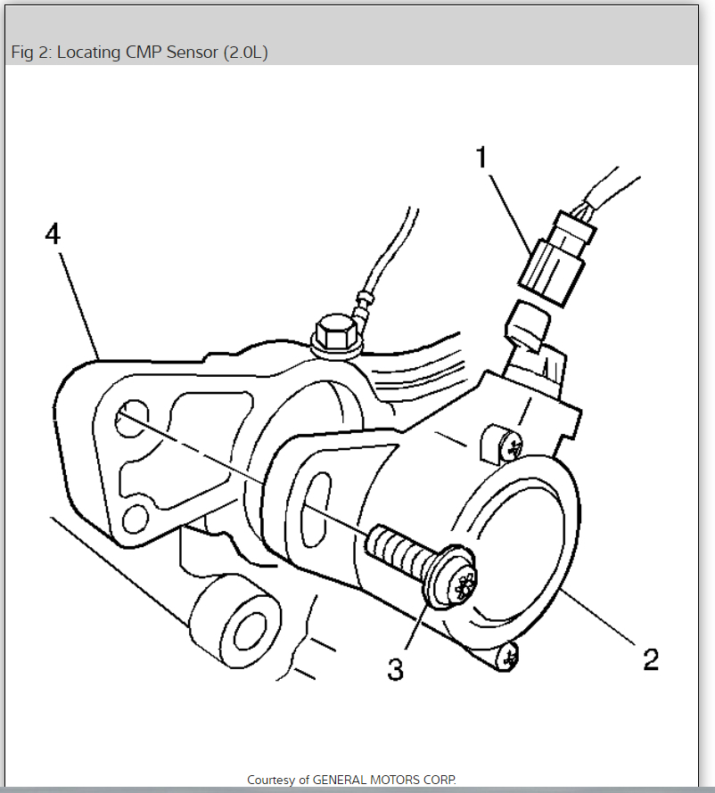

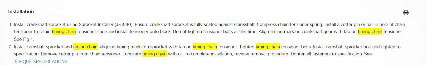

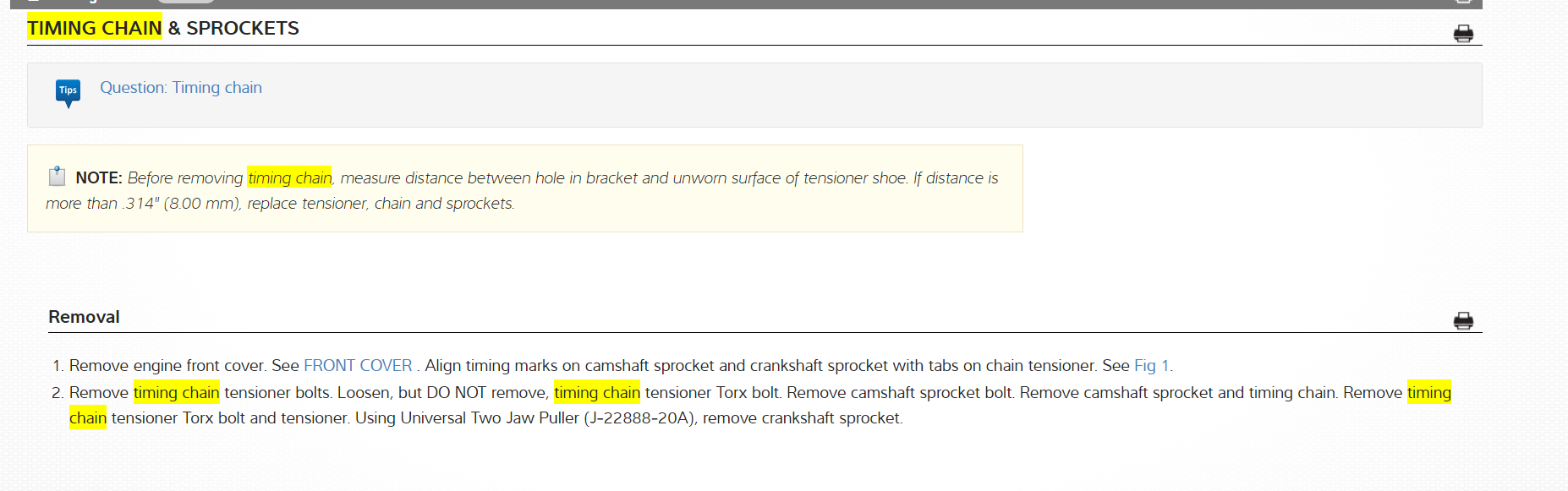

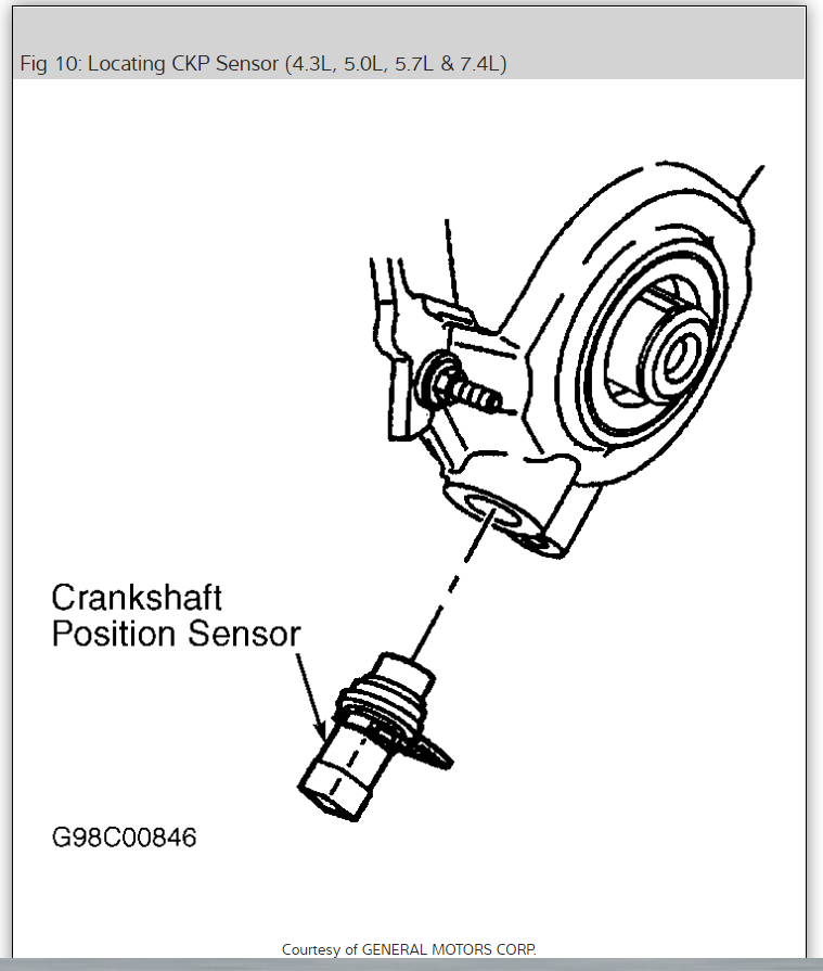

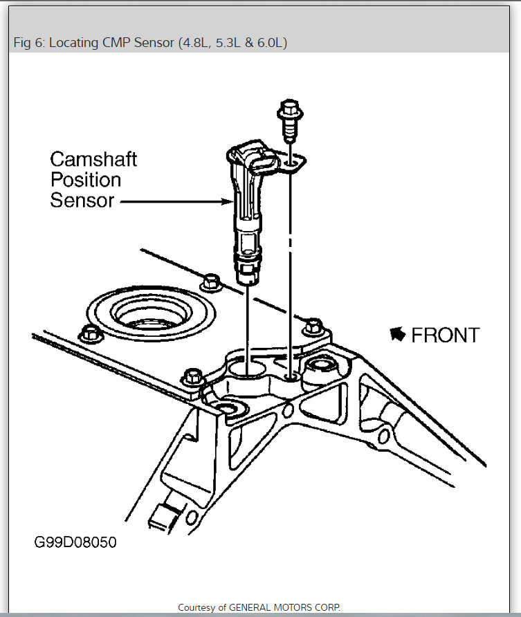

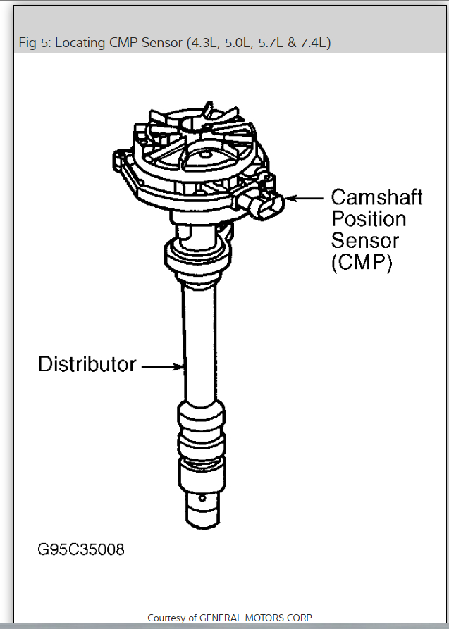

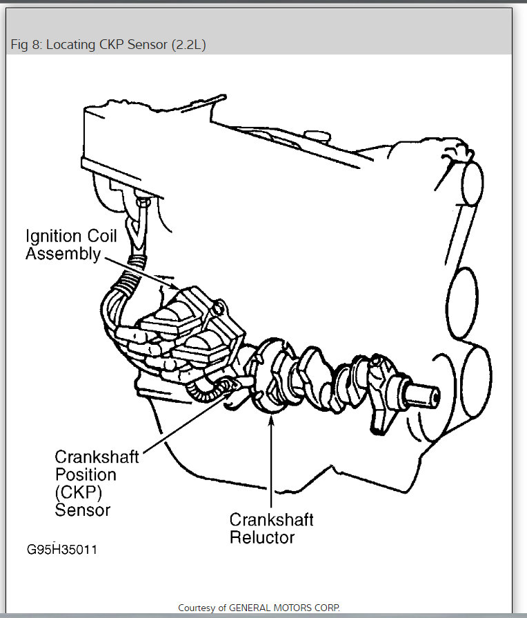

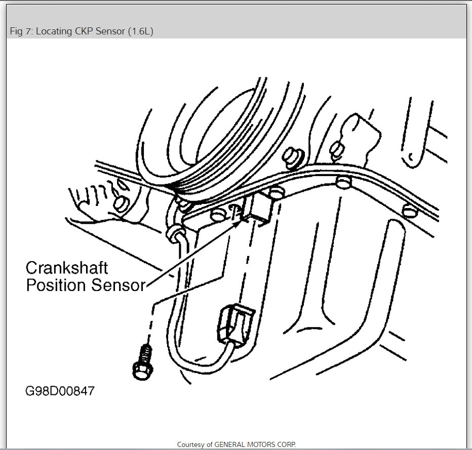

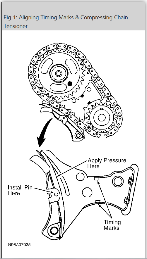

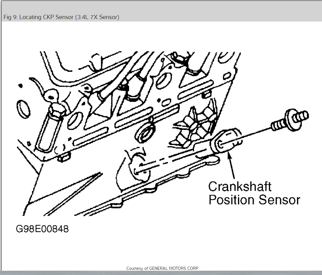

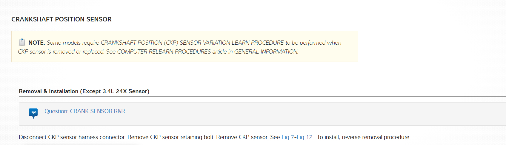

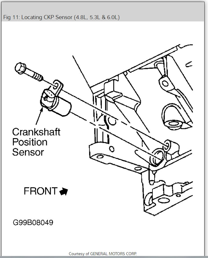

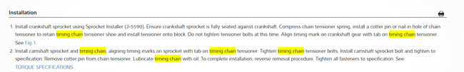

I hope you were talking about your timing chain, because your ignition timing is non adjustable. Anyway, I have included directions for setting the timing on your timing chain in the diagrams down below. Please get back to us with any other questions you may have, or if we can help in any other way, and let us know what happens, please.
Thank you,
Alex

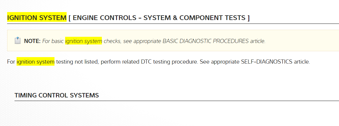

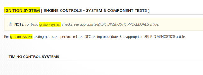

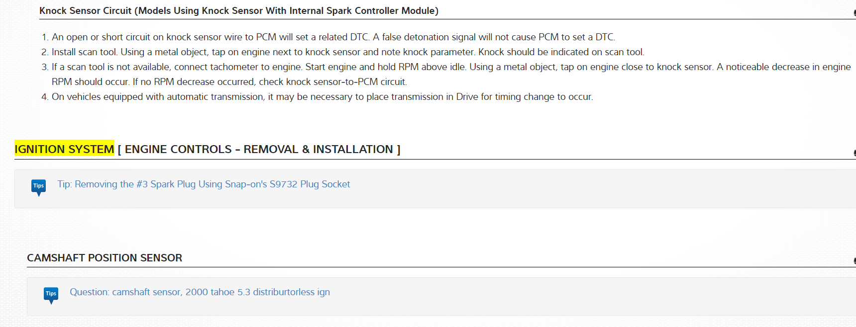

Hello again,
In the diagrams below I have included the instructions for ignition timing on your vehicle. Please let us know if there is anything else we can do to help.
Thanks,
Alex
