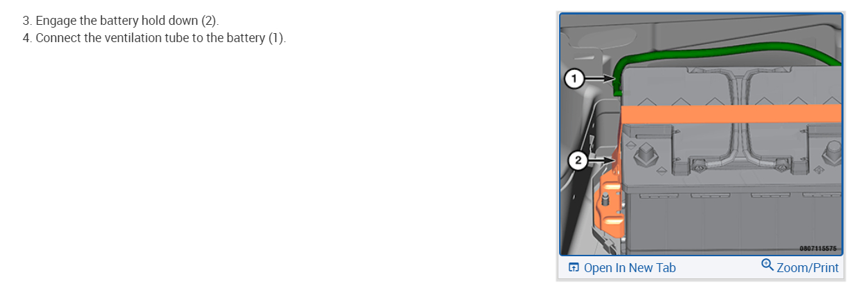

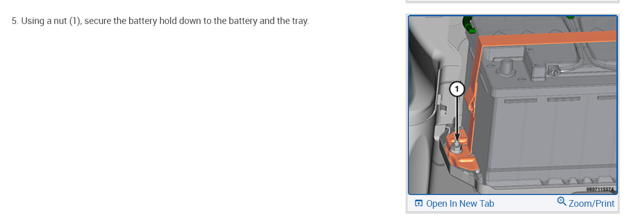

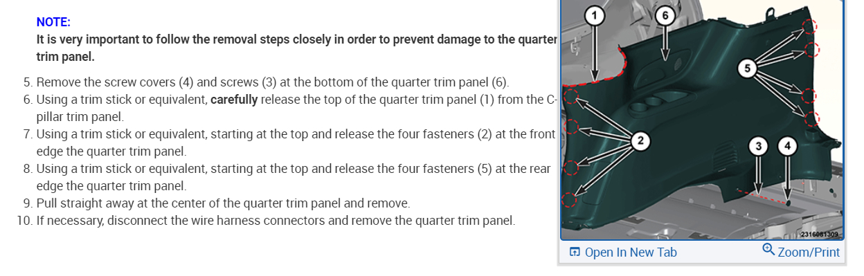

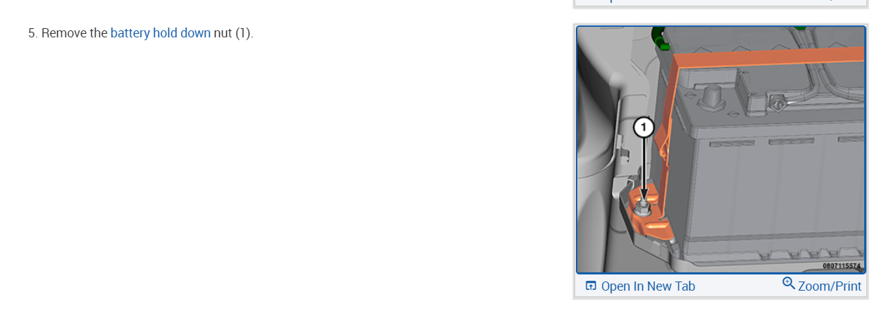

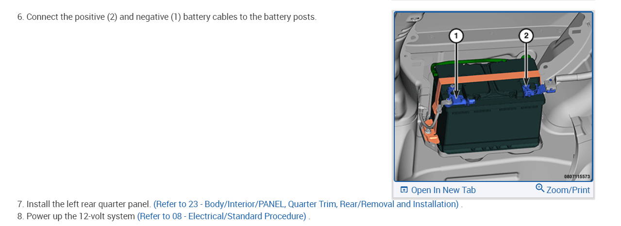

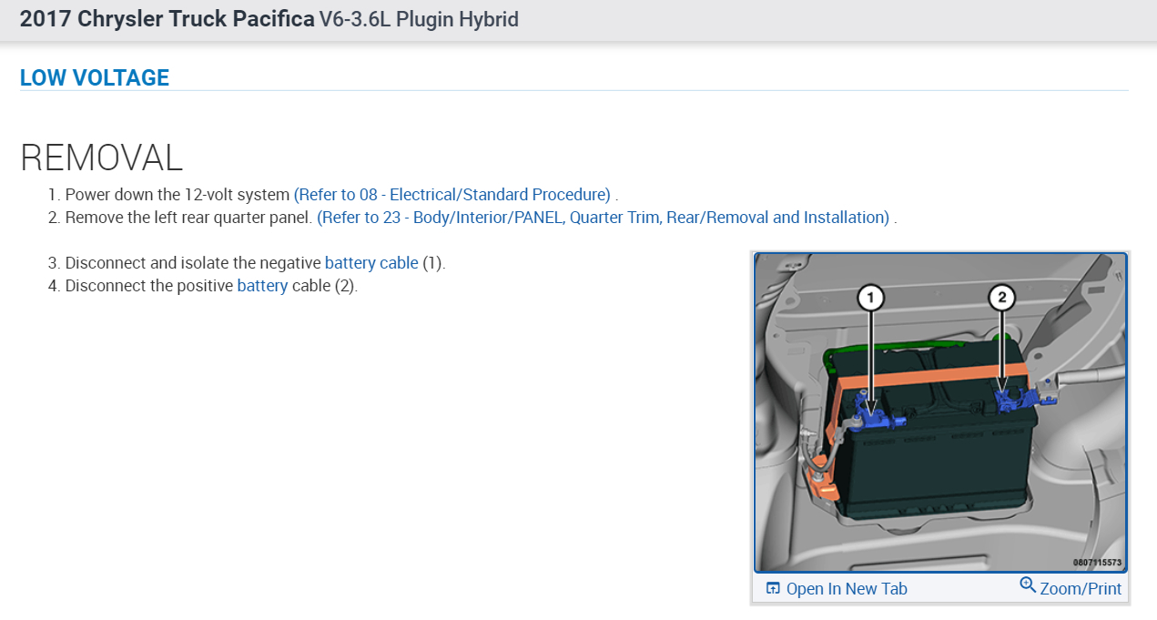

I changed the aux battery. Restored the remote start. The instrument cluster icon circle/arrow around an A with ! still shows. And the message “start/stop unavailable”
