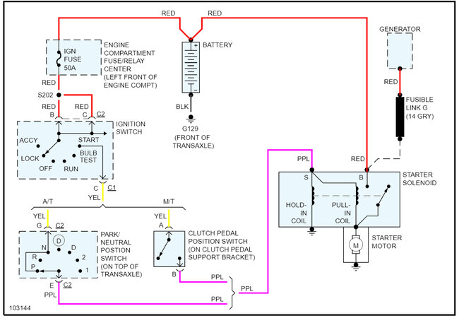

I had to replace the starter and the battery at the same time. The new starter is wired in the same as the old one (which worked but was worn out). 5 wires, btw. Now, when I turn on the key, all the proper idiot lights come on, but when I turn the switch to the start position, nothing happens. Not even a click. There is no starter relay on this car, only a 50-amp fuse, which is good. I’m puzzled as to what it could be. Please help.

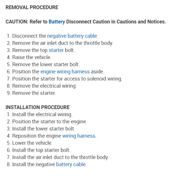

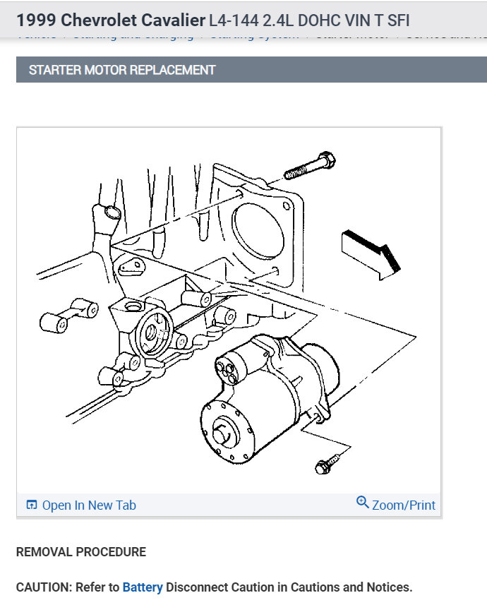

I have included the instructions for changing the starter out in case you need it, and the starter wiring diagrams so you can see how the system works. Check out the images (below). Please let us know how it goes

Ken. The starter is brand new, and it works fine if I jump the solenoid. All I can think of is that it is not getting a start signal. This year's model does not have a starter relay, only a 50-amp fuse, which is good. I’m getting frustrated with the whole project. I need the car to run, but I swear I’m ready to use some dynamite to solve the problem.

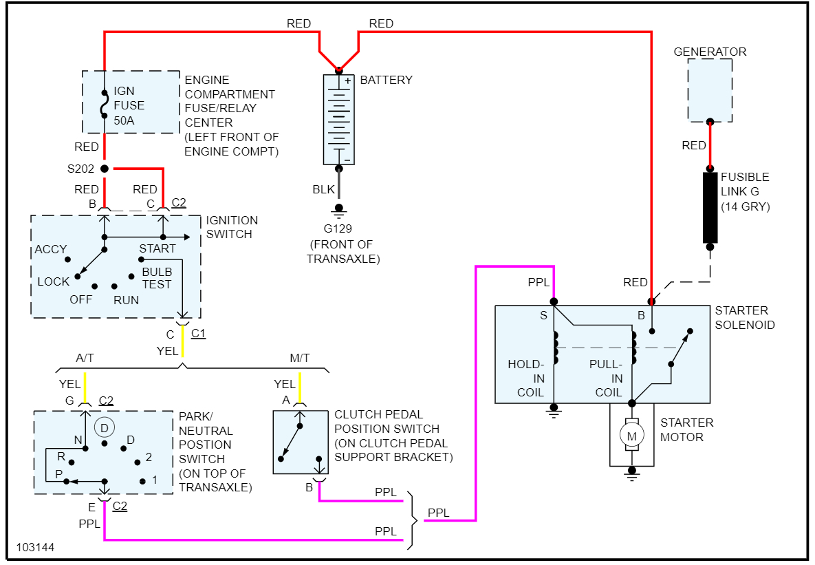

I hear you, please look at the starter trigger circuit wiring diagrams above and use this guide to see where you lose power at:
It looks straight forward, there is no security system involved.
