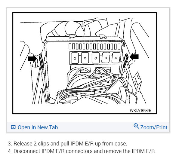

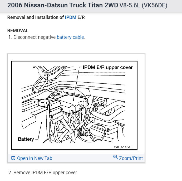

These trucks had a problem with the IPDM. to be sure here is a guide to check it with the location of the relay in the diagrams below and how to replace the IPDM:
