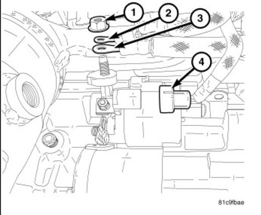

It sounds like you have a starter that is going out, here is a guide to help you confirm. Look toward the bottom of the guide.
https://www.2carpros.com/articles/car-engine-will-not-crank-over

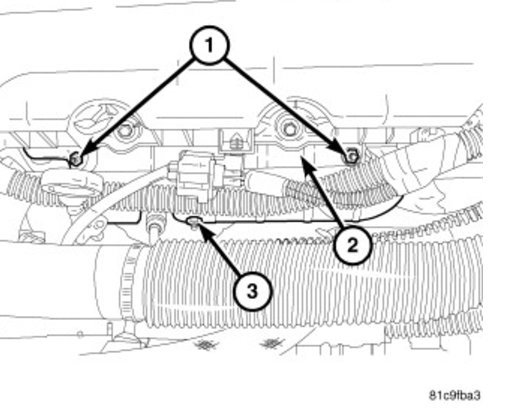

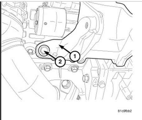

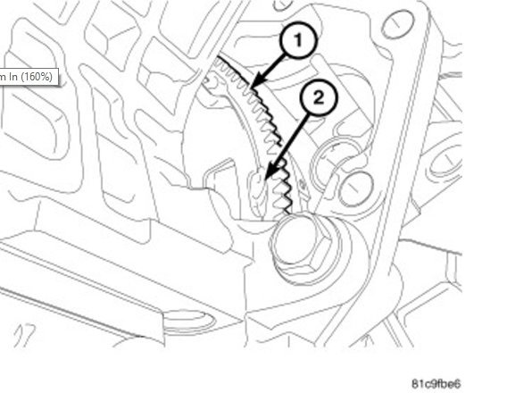

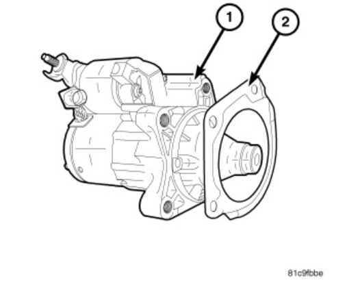

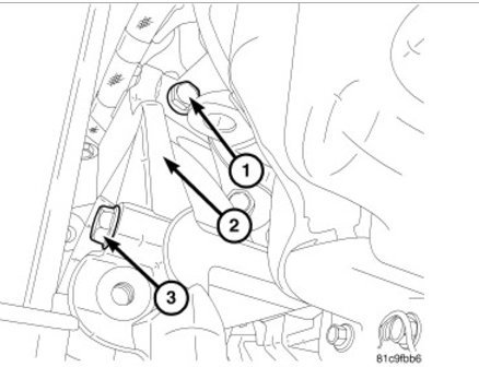

and if so here is a guide will show you what you are in for when doing the job.
you will need to jack up your car.
