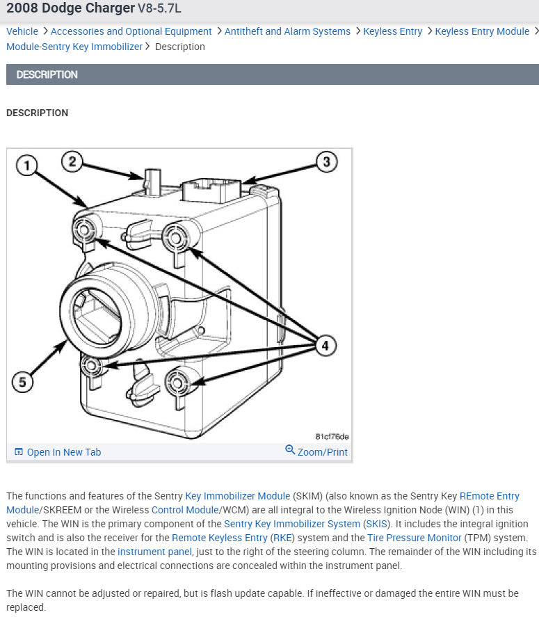

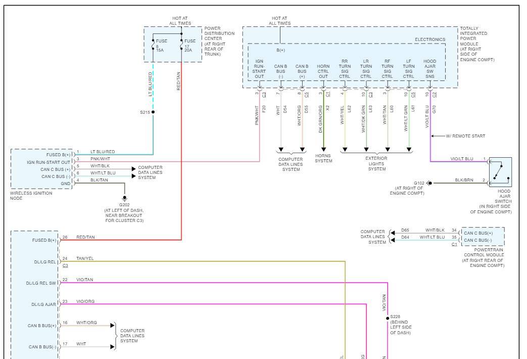

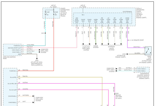

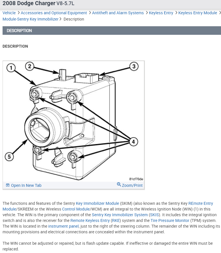

In order to start the car, you will have to reset the security system.
Try disconnecting the battery and wait for at least one minute then reconnect. This should reset the immobilizer system.
Here are some helpful information:
https://www.2carpros.com/articles/how-to-reset-a-security-system
Keep in mind that some of these vehicles will require a scan tool to reset the security system.
Please let me know what you find.
Thank you.
