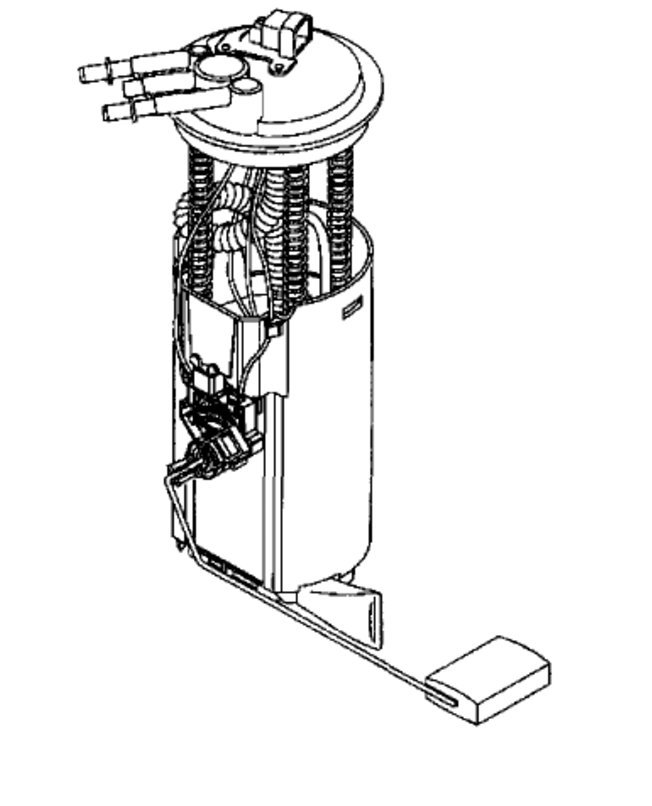

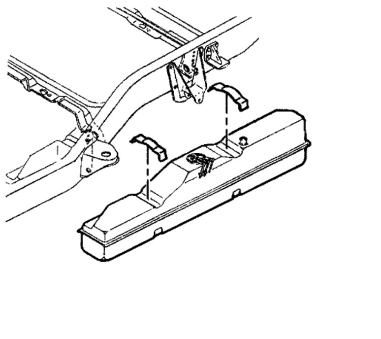

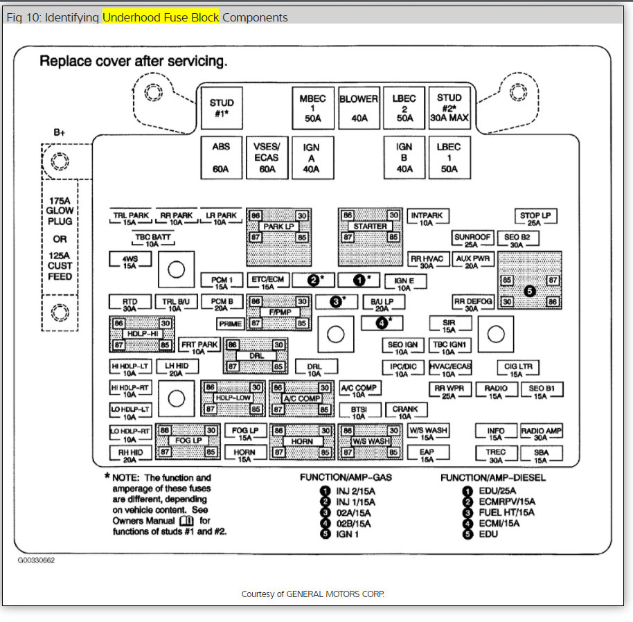

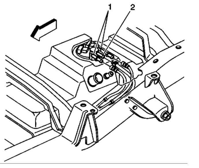

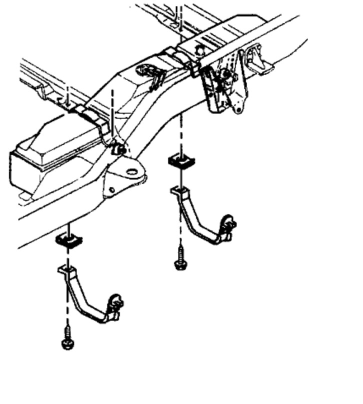

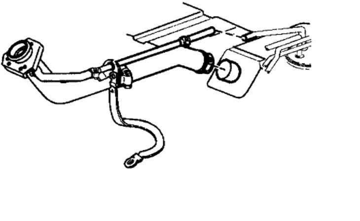

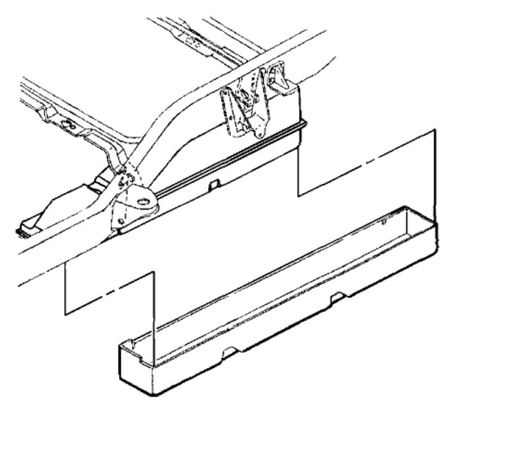

When the engine stalls is the fuel pump working? It sounds like a classic fuel pump problem which these trucks had. I would try the pump and relay first.
Here is a guide to give you an idea on what you are in for when doing the job:
Replace the relay as well.
Here is the pump from Amazon, this one comes with the harness end which has troubles as well:
https://www.amazon.com/gp/product/B00171V2GC/ref=as_li_qf_sp_asin_il_tl?ie=UTF8&tag=2carprcom-20&camp=1789&creative=9325&linkCode=as2&creativeASIN=B00171V2GC&linkId=d1b4d9b9df9e26006b933f685ac3b1a5
This is what it will be like on your car (below).
