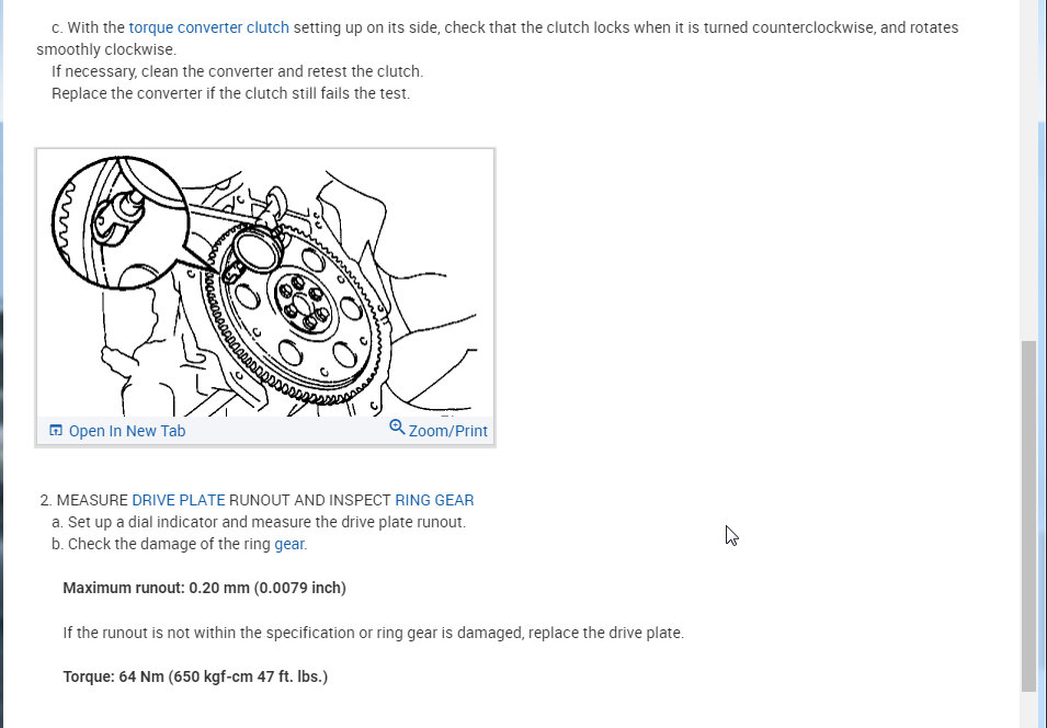

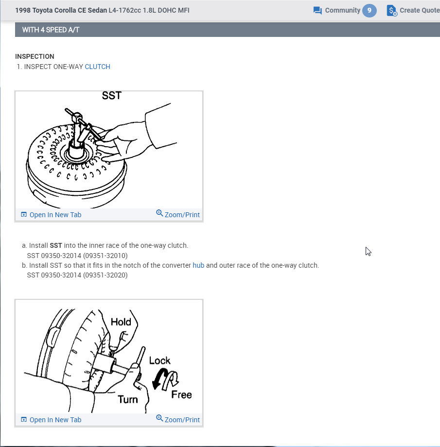

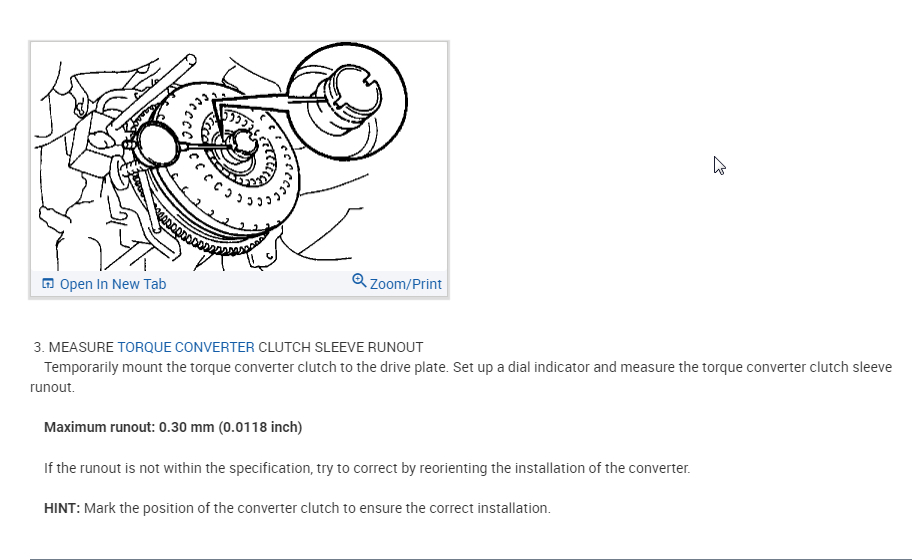

I can almost guarantee that this is the torque converter is not releasing when coming to a stop. Basically as you slow down the torque converter clutch should start slipping and then when you are moving slow enough it completely disengages. If it does not then it will stall the engine. Think of this as if you had a manual transmission and you came a stop sign and left it in gear but did not push the clutch in. Once you were moving slow enough the engine would just stall. This is basically the same thing that is happening here.
I attached the process on how to test it but that requires removing it, I would just replace it or have it replaced if it were me.

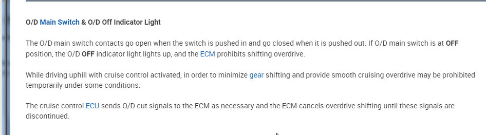

On older vehicles like this the torque converter normally only comes in at highway speeds so it is unlikely that it would happen at slower speeds. One way to test this would be if you have an Overdrive switch. It could be called Overdrive off switch and when it is pressed, you have an Overdrive off light on in the cluster. I attached the info on this.
If you turn the Overdrive off and then drive it at highway speeds and come to a stop when it normally would stall, it should not stall if it is the converter.
Unfortunately it can be other things but based on my experience this is the most likely cause if this happens after getting off the highway. I have seen a number of times on different vehicles.
Let me know if you have other questions and if it still does it when the Overdrive is off. If so, we can get into these other possible causes.
