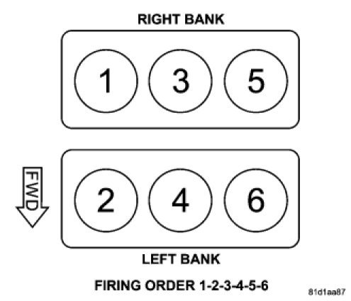

Regardless, replacing plugs may be necessary, but will not fix the problem. The first thing I need you to do is check the wiring to numbers 1 and 2 injectors. Make sure there is no evidence of damage, disconnect them and check for corrosion...
I attached a picture of cylinder location. The arrow on the left side of the picture points to the front of the vehicle.
