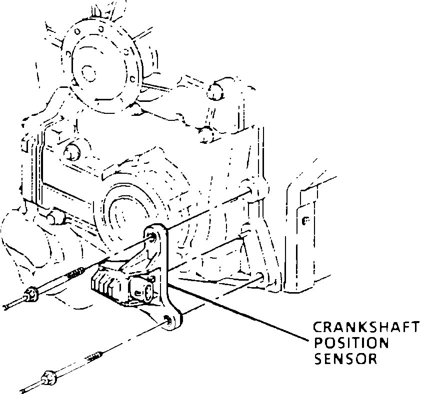

Based on your description, the first thought that comes to mind is the crankshaft position sensor is going bad. First, take a look through these two links:
https://www.2carpros.com/articles/how-a-crank-shaft-angle-sensor-works
As you can see, the sensor can cause stalling, no start when hot, and so on. Now to test the sensor, what you need to do is see if there is ignition spark to the spark plugs. Here is a link that shows how this is done. Also, you will need to check this when the engine refuses to start.
If you find there is no spark, then I would suggest replacement of the sensor. Here is a link that shows how in general one is replaced:
Here are the directions specific to your vehicle. The attached directions correlate with the directions.

Camshaft And Crankshaft Position Sensors
pic 1

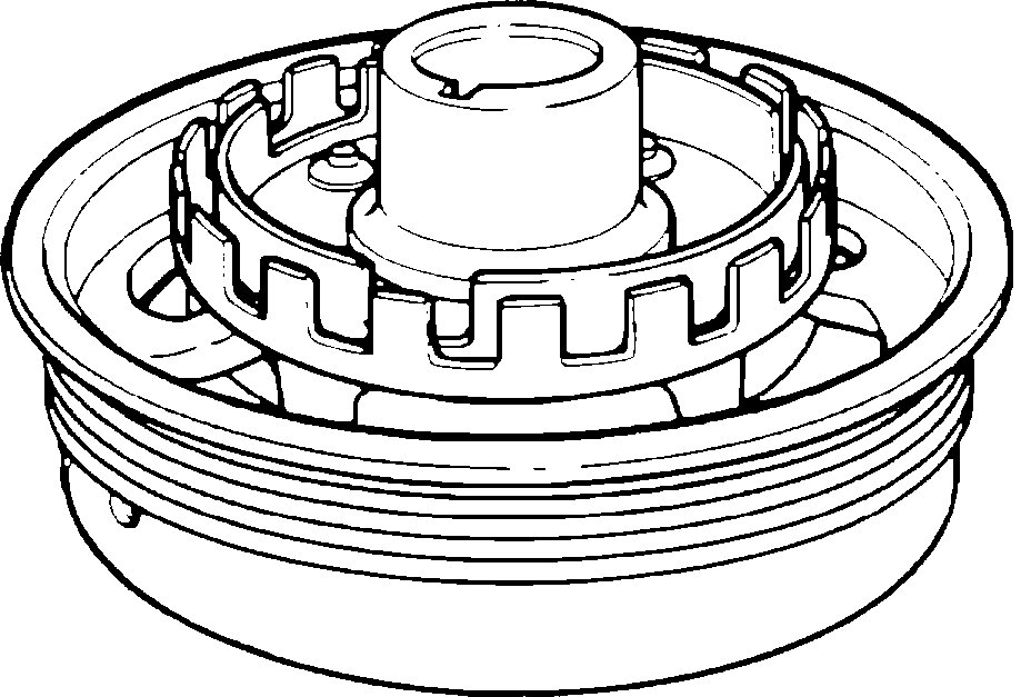

Crankshaft Balancer With Interrupter Rings
pic 2
7. Using special tool J38197, remove crankshaft harmonic balancer

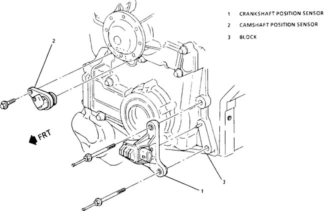

Crankshaft Position Sensor Shield
pic 3
8. Remove crankshaft position sensor shield

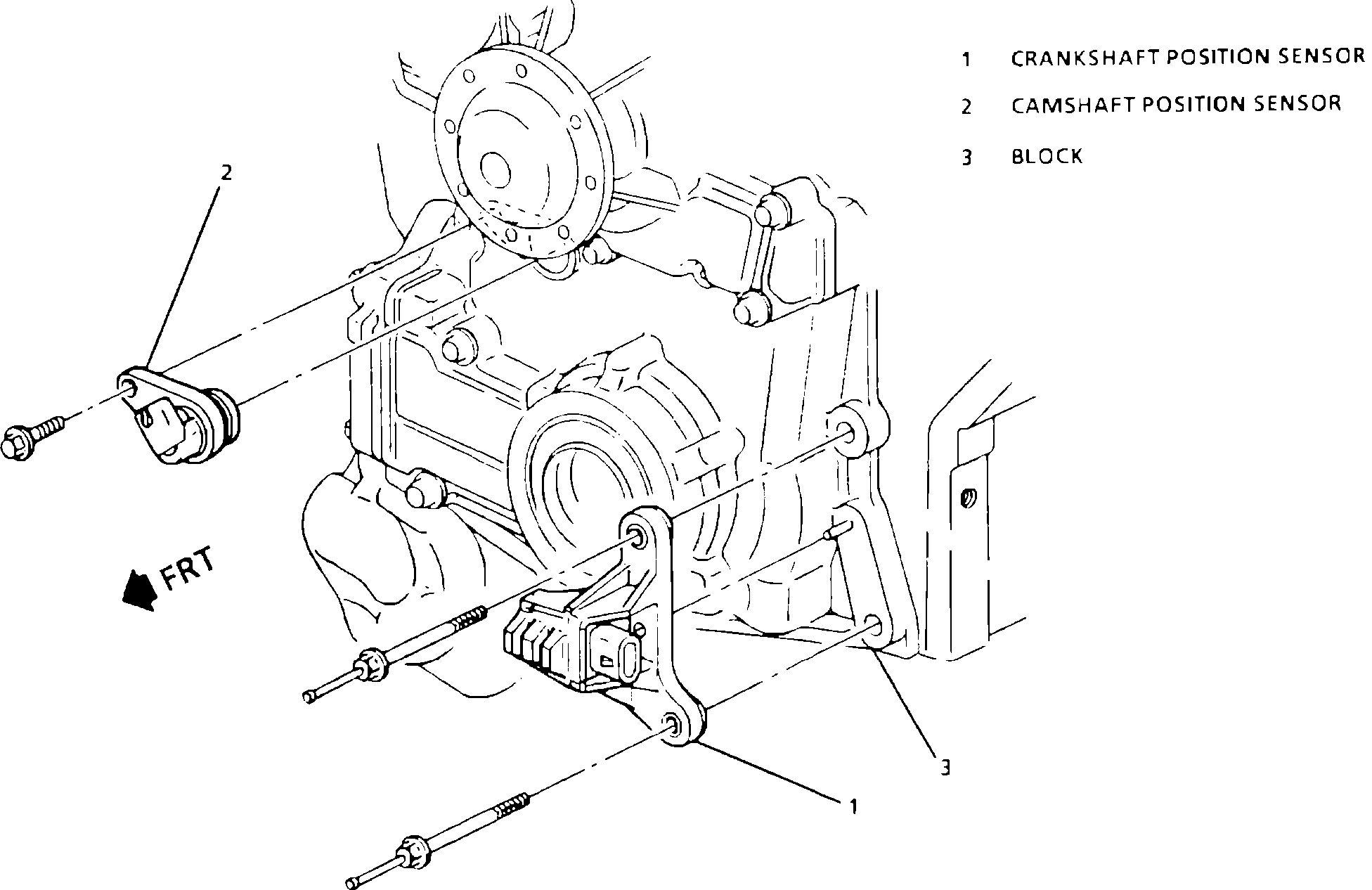

Crankshaft Sensor
pic 4
10. Remove sensor from block face
