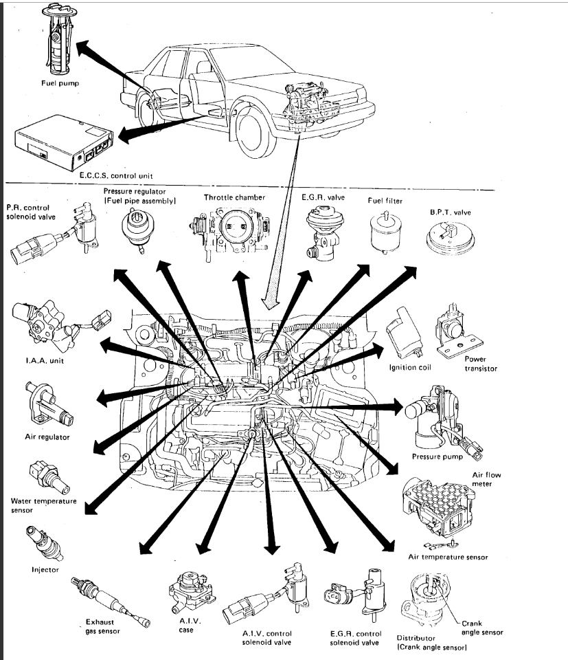

Checked for vacuum, did the squeeze test and sprayed carburetor cleaner on all vacuum connections. aAll checked out good. Where is the coolant temperature sensor ?
Jun 10, 2018 at 9:47 AM
Here is the engine coolant temperature sensor location (below):
Jun 10, 2018 at 11:07 AM
