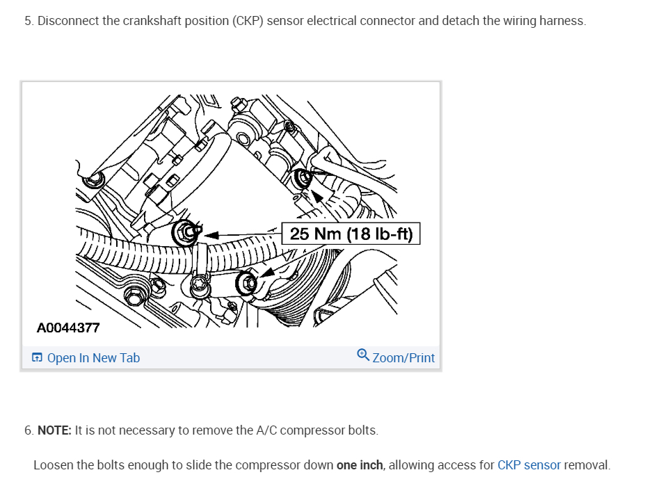

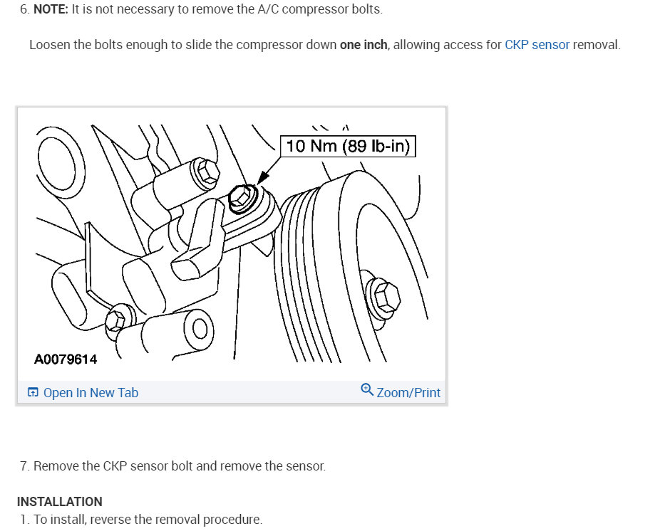

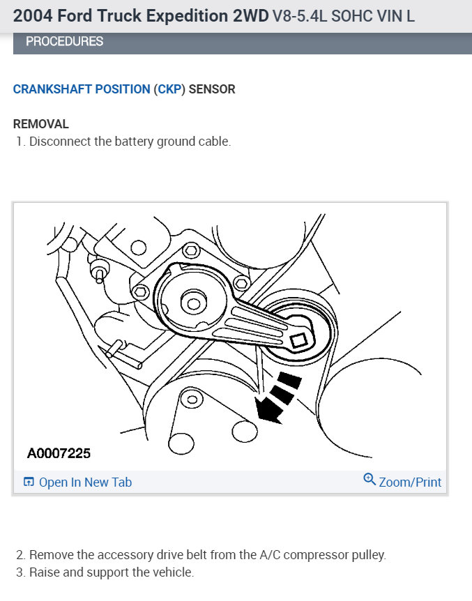

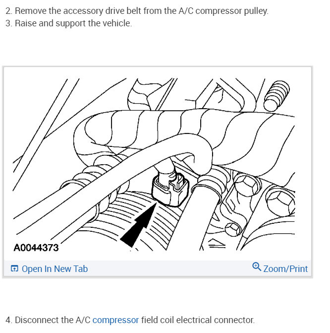

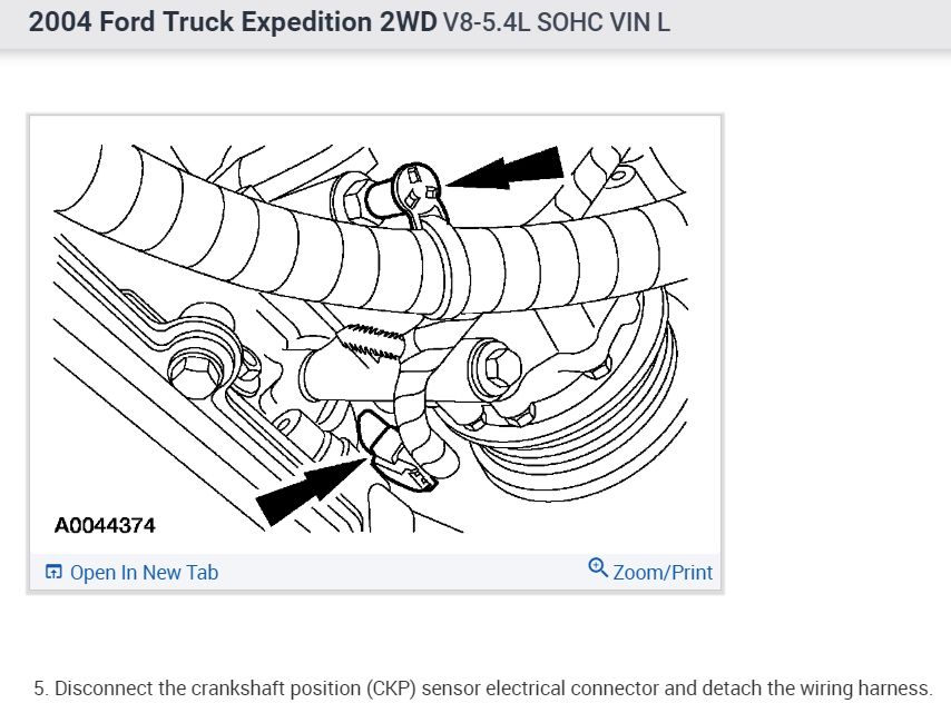

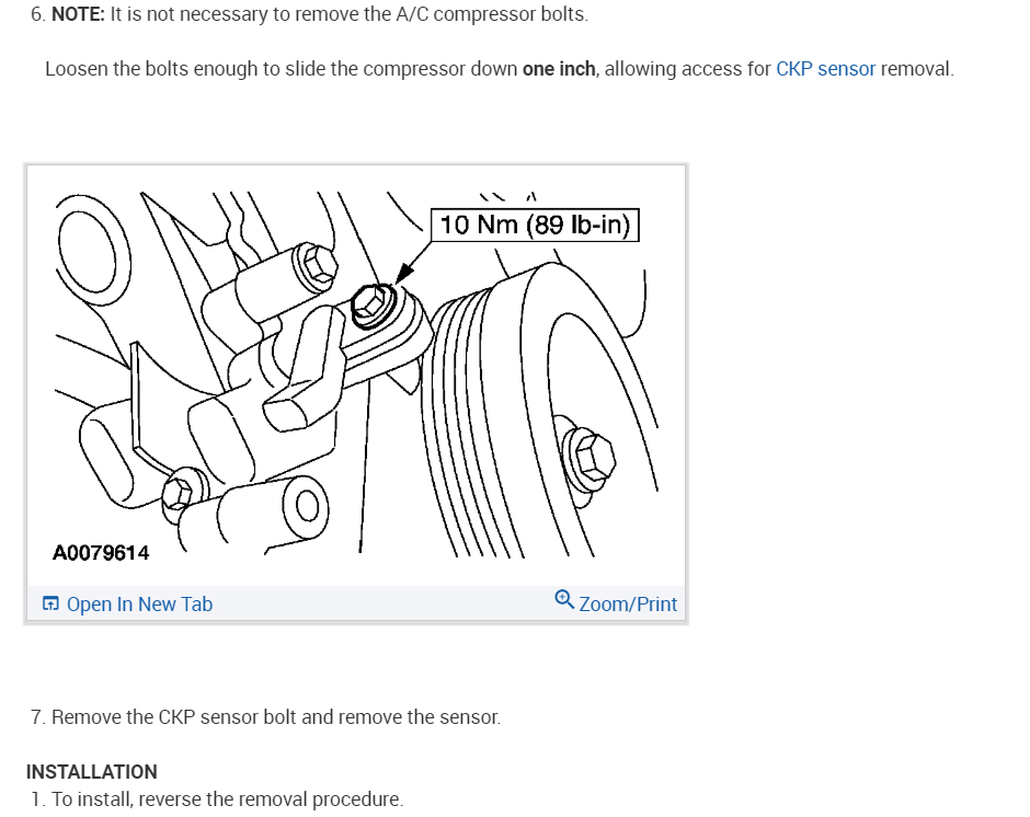

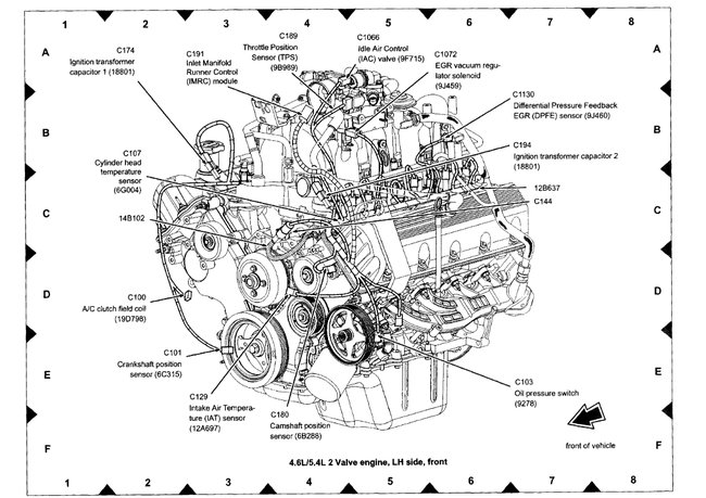

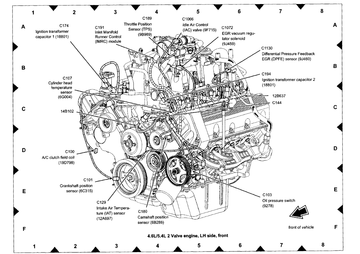

Yep, the crankshaft sensor is what I would replace, it gives you a clue at slow speeds partial failing and then catching itself. Here is a guide that will walk you through the repairs and diagrams below to show you how on your car.
Check out the diagrams (Below). Please let us know what happens.
