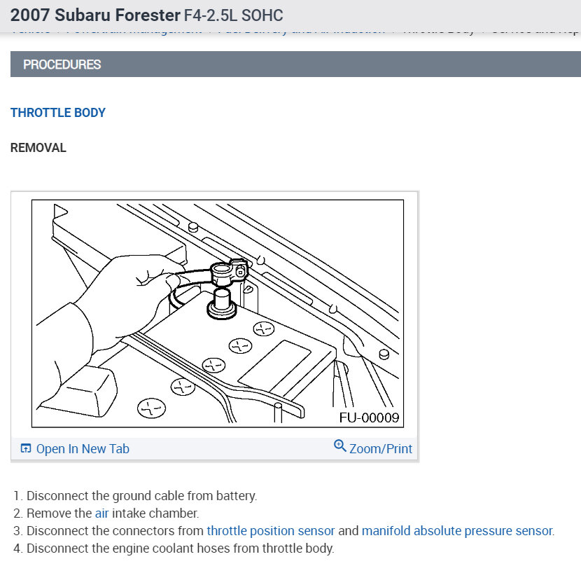

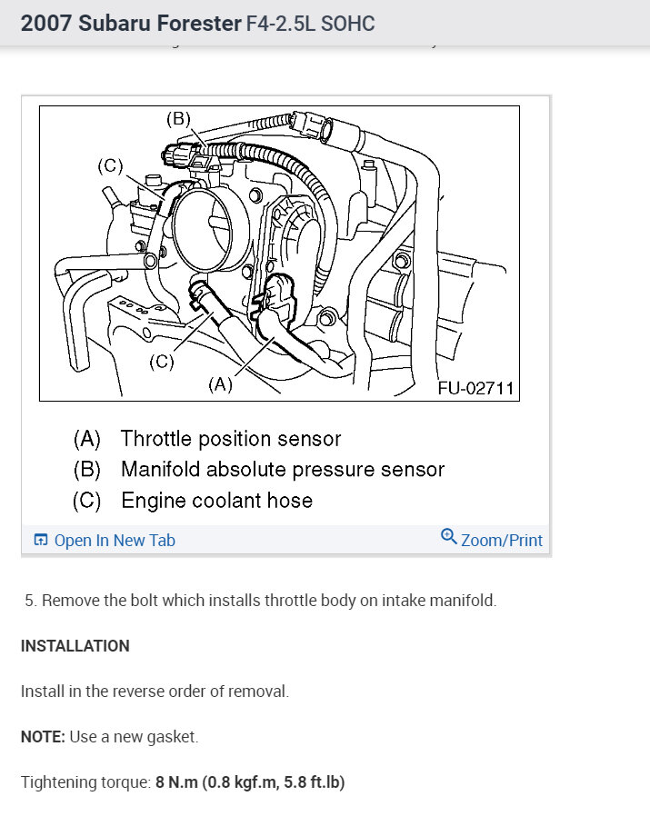

Sure, it sounds like you have a vacuum leak, or the throttle body needs to be serviced.
Here are three guides to help us fix it and I have included instructions in the images below for your car:
https://www.2carpros.com/articles/stall-at-idle
And use guide when the engine is cold only:
And this guide for the throttle bore service:
Check out the images (below). Let us know what happens and please upload pictures or videos of the problem so we can see what's going on.
