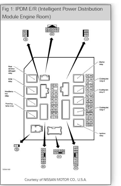

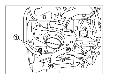

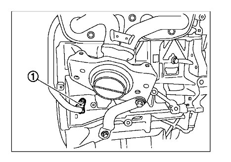

The first thing we need to do is run the codes, if there are no codes it sounds like it could be the crankshaft angle sensor. Here is a guide to help us fix it and the crankshaft angle sensor location in the images below as well so you can change it out. I have also seen the main power relay for the computer system go out as well.
and
https://www.2carpros.com/articles/engine-stalls
Check out the images (below). Let us know what happens and please upload pictures or videos of the problem so we can see what's going on.
