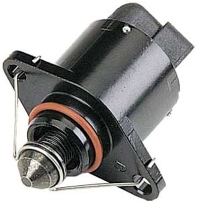

If you find no leaks and the check engine light is not on, I would then suspect the idle air control valve, IAC. The IAC is located on the throttle body and is designed to maintain the engine's idle when you remove your foot from the accelerator. I have attached a picture of what the one looks like for your vehicle.
