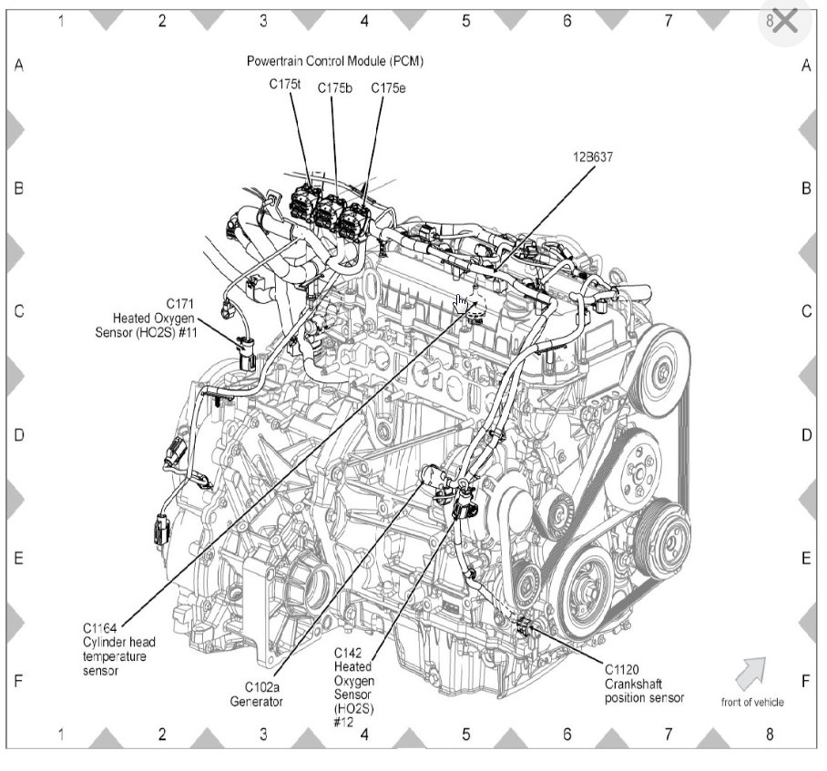

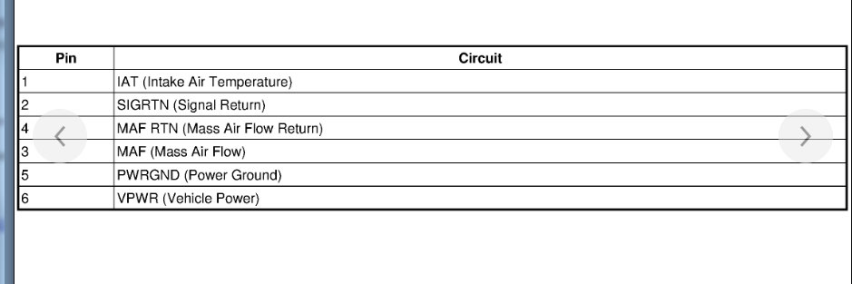

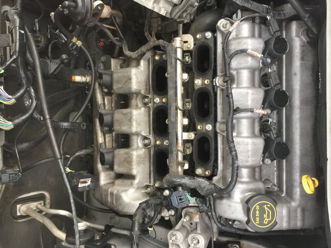

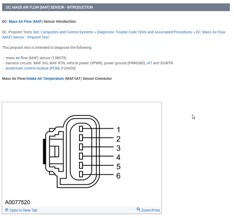

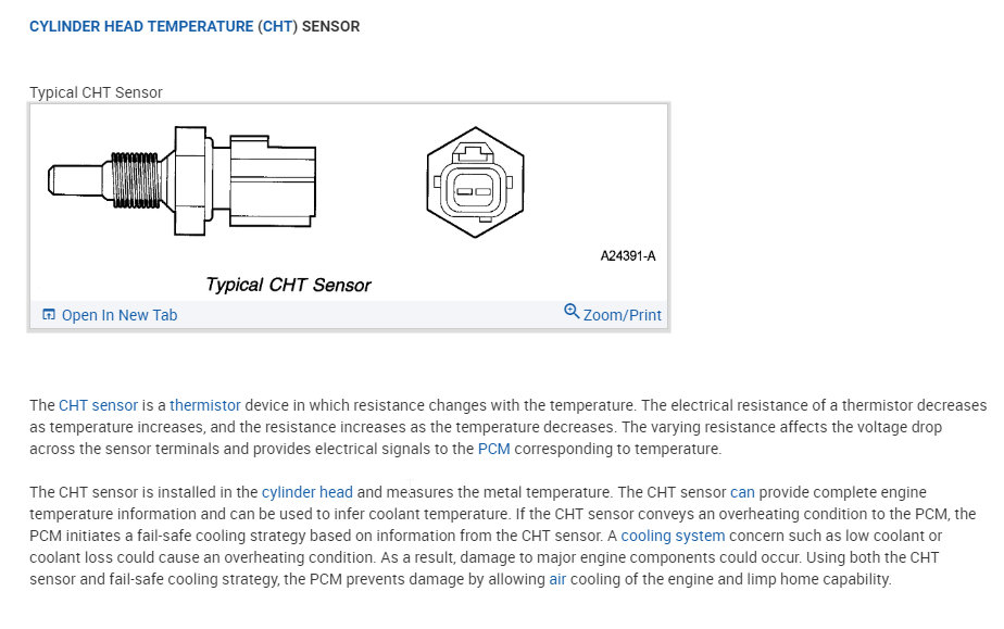

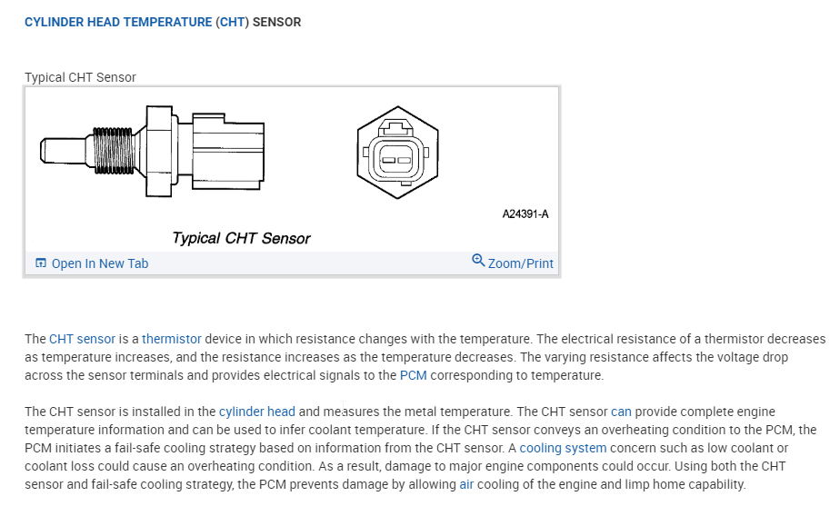

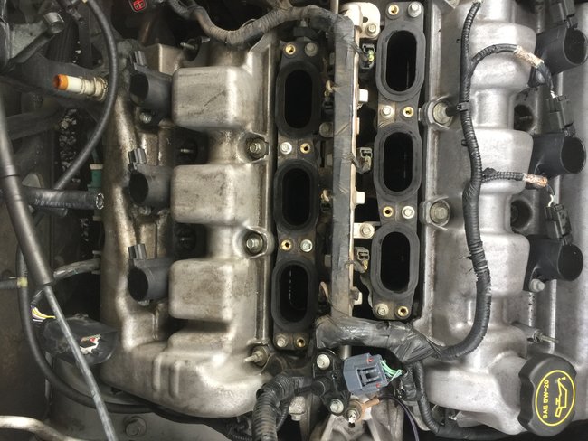

I have been having an issue where my vehicle starts up perfectly on a cold start but doesn’t when hot. After idling for 15-20 minutes I turn off the engine and try to start it again. It turns over and has power but the rpm's fluctuate/sputter until it loses all power. Usually only takes about 5-15 seconds. Feels as if it’s overheating but temperature gauge reads normal. I’ve replaced my coolant reservoir (was cracked), fuel rail pressure sensor, MAF sensor, air filter, coolant temperature sensor, flushed the radiator, replaced spark plugs/coils, replaced fuel pump/filter yet I still have the same issue. After all this I took it for a test drive and it still felt as if it didn’t have the usual power and stayed around 2,000-3,000 rpm's with me trying to floor the accelerator. I’m at of loss of what it could be so I’m replacing the cylinder head temperature sensor next although I can’t find it on the cylinder. Anyone know if I’m missing something or know what this could be? Also where is the cylinder head temp sensors located?
