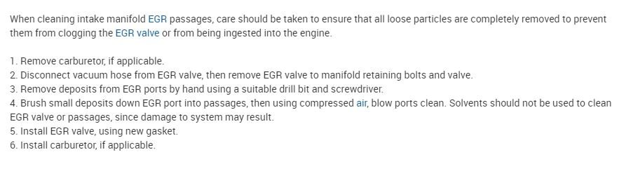

I would start by checking the EGR valve on the intake manifold by the throttle body. Remove the hose and see if it still stutters. If it does not, then the valve is bad causing a vacuum leak off idle.
https://www.2carpros.com/articles/stall-at-idle

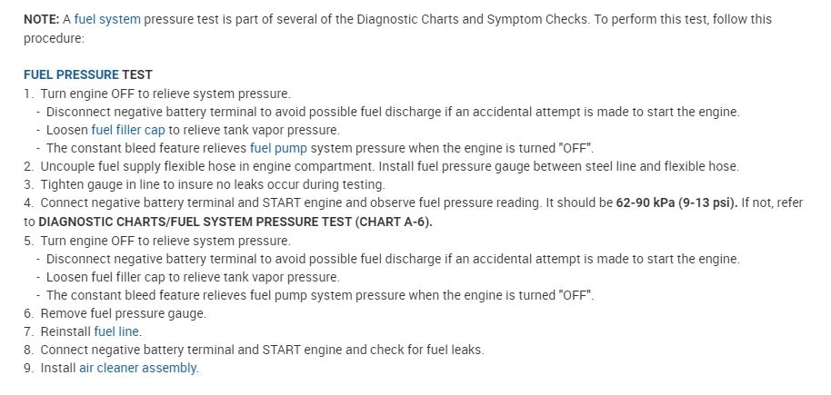

I would also check the fuel pressure. Low fuel pressure will cause this as well.

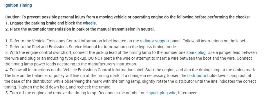

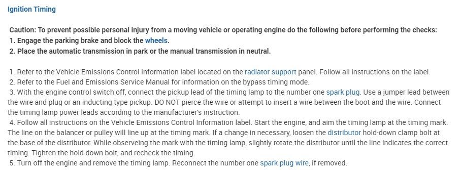

Lastly, check the ignition timing. Follow the procedure I attached and set it at 12 degrees before top dead center.

I disconnected the EGR valve and the problem went away in both drive and reverse. Thanks for the help.
