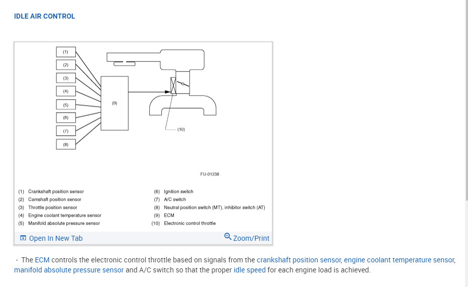

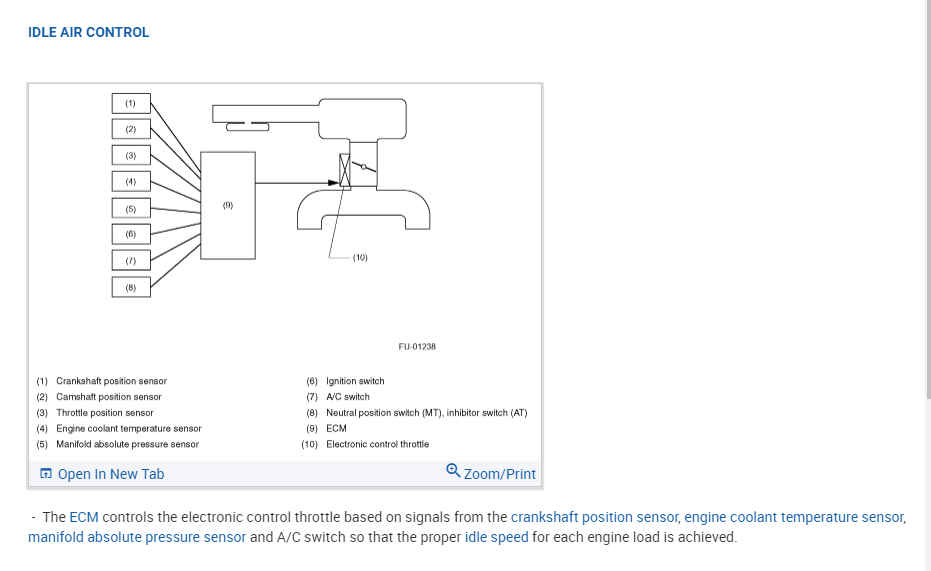

If holding the brakes down causes the engine to stall it is either a vacuum leak or the IAC is failing. It could be other things but we need to start here. I doubt it is related to the head gaskets but we need to check for a vacuum leak as maybe a line came off or is leaking.
Let's start with these things and go from there.
https://www.2carpros.com/articles/idle-air-control-valve-service
