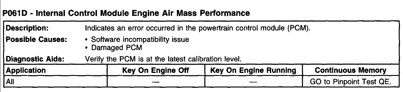

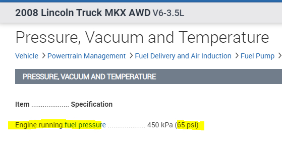

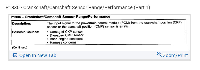

My car stalled and I've had a couple of issues with it starting. It turned over cycling the starting sequence three times before starting. Ran fine after that, started up after shutting off after arriving at home.
