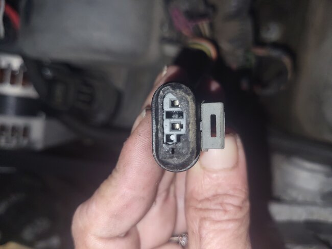

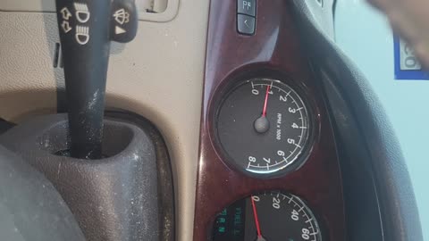

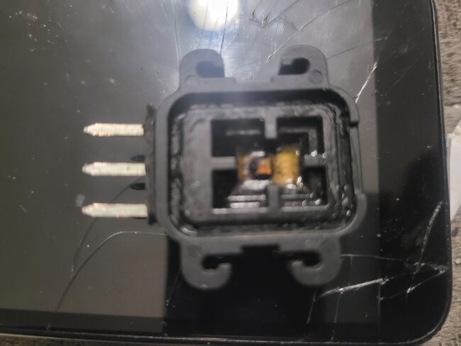

This is the third time. I'm doing this because if you try to go back in. The model is blank, and it won't let you get past that. Anyway, I got this car, and it had code p0171 and p0455. Got a new gas cap, both codes went away. My neighbor who's a mechanic discovered the wrong fuel pump was on there and I got a new one. Run great for a day. So, the problem started all over again, new code p1516. Got a new throttle body, but that 1 through all kinds of sensors for the TPS. Check it off. Look at the old one I thought my mechanic friend had looked at it. But he didn't because the plate was covered in that sludge. I think they called Coke about at least a quarter inch thick. So, I cleaned it and put it back in. Did the revolum procedure and it ran beautifully 4 15 minutes sitting in park. I turned it off with inside. Did a few things came out half hour later to go to the grocery store? I didn't get 2 feet down the street. And it started doing the same thing and stalled. My friend brought another mechanic by He got code P0068. The air filter had a giant hole in it across the whole top of the filter and the screen For the MAF was off. Fixed that situation. I also jumped the field pump relay. It works the fuse was 25 instead of 20 amps changed that. I checked the fuel pressure by sticking my finger in the Schrader valve. It does not spray out, but gas does come out. I did it with the key in the arm position. But the car was not running. Right now, it has no code still doing the same thing. I also just cleaned the map sensor it was caked in oil and I'm sending a picture of the connector the video is after I did that. I also have black smoke from the exhaust and the smell of gas. When I start up especially. I also haven't been able to do the relearn procedure because it will not run long enough. I did take it out again after I did the last one. In the video, the earlier noises are cars going by? At about 1 minute. I put the pedal all the way to the floor not for long, but you can see/hear what happens. I'm a single mom and I just don't have the money for a real mechanic and tools...
