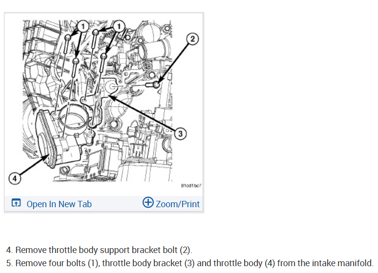

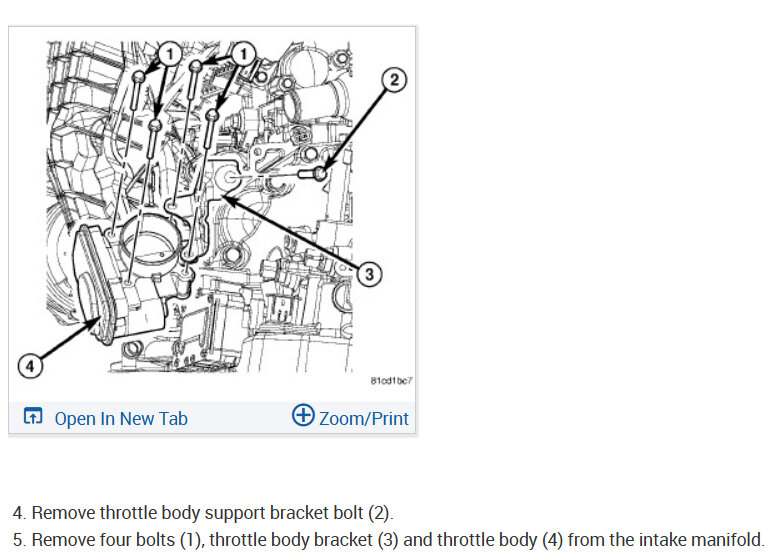

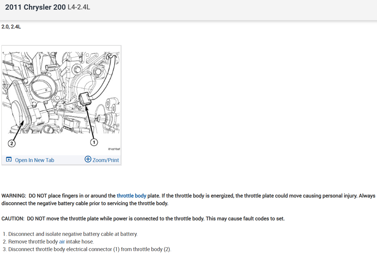

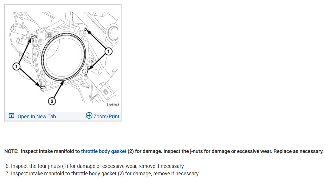

Yep, this will happen when the throttle bore needs to be serviced, please follow this guide and I will leave instructions for your car in the images below.
Please go over this guide as well, which shows other possibilities:
https://www.2carpros.com/articles/stall-at-idle
Check out the images (below). Please upload pictures or videos in your response of any problems so we can see what to help you with.
