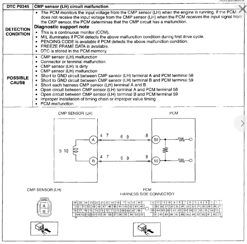

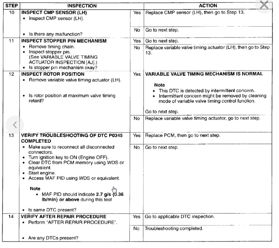

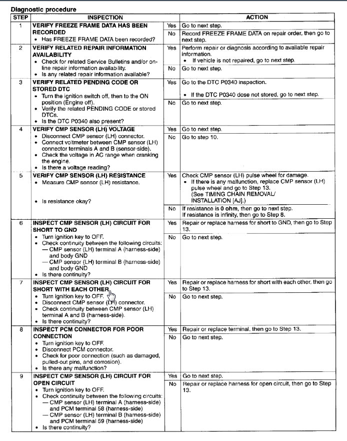

Good thing we have a code but I would think the issue is a wiring issue or some other issue with the circuit.
Here is the testing that we need to do in order to find out what the cause is. Please notice the first page where it gives a list of possible causes so we need to work through this to find out what it is.
Please let me know what questions you have. Thanks.
