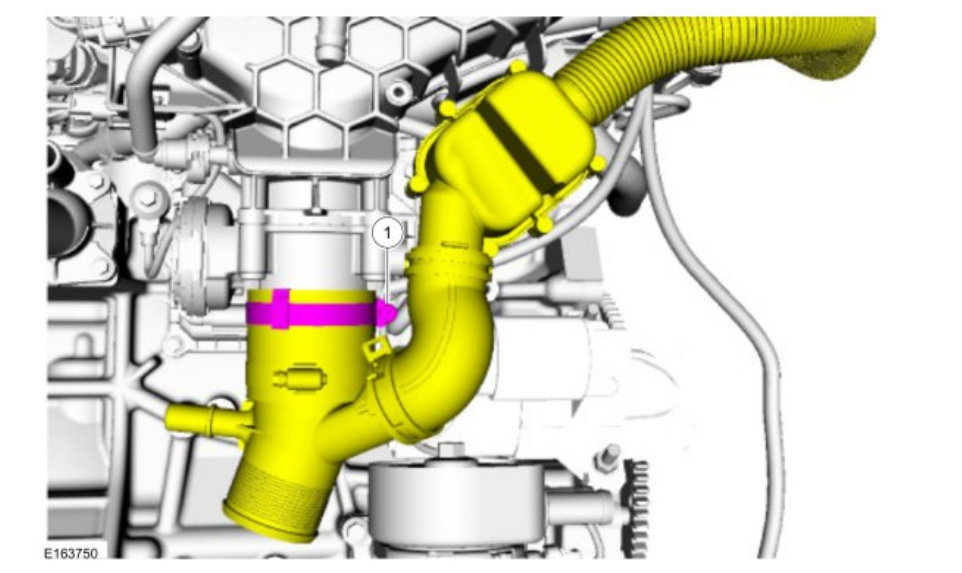

Removal
WARNING: Before beginning any service procedure, refer to Safety Warnings in General Information. Failure to follow this instruction may result in serious personal injury. See: Vehicle > Initial Inspection and Diagnostic Overview
WARNING: Do not work on the fuel system until the pressure has been released and the engine has cooled. Fuel in the high-pressure fuel system is hot and under very high pressure. High-pressure fuel may cause cuts and contact with hot fuel may cause burns. Failure to follow these instructions may result in serious personal injury.
WARNING: Clean all fuel residue from the engine compartment. If not removed, fuel residue may ignite when the engine is returned to operation. Failure to follow this instruction may result in serious personal injury.
NOTE: Removal steps in this procedure may contain installation details.
1. Refer to: Health and Safety Precautions See: Vehicle > Technician Safety Information > Health and Safety Precautions (General Information). See: Vehicle > Initial Inspection and Diagnostic Overview

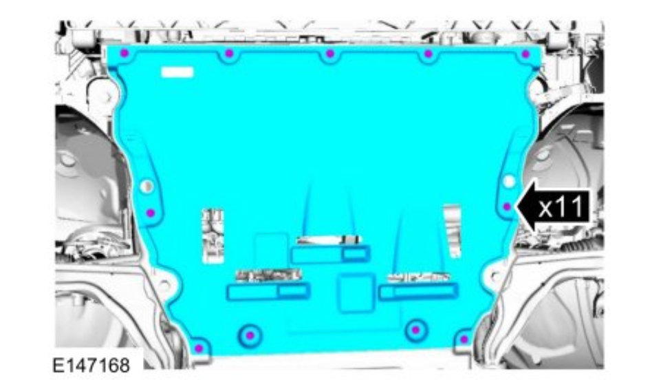

2. Refer to: Jacking and Lifting - Overview See: Vehicle Lifting > Procedures > Jacking and Lifting (Vehicle Jacking and Lifting). See: Vehicle Lifting > Procedures > Jacking and Lifting
3.
Help See: Vehicle > Components > About This Information
4.

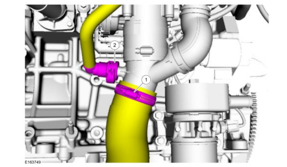

1. Torque: 5 Nm
2. Refer to: Quick Release Coupling See: Fuel Line Coupler > Procedures > Quick Release Coupling (Fuel System - General Information).
5.
1. Torque: 5 Nm

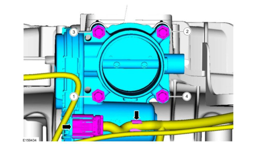

6. NOTE: When disconnecting the Throttle Body (TB) electrical connector disengage the red locking tab on the Throttle Body (TB) electrical connector by sliding it to the rear of the Throttle Body (TB) electrical connector, away from the Throttle Body (TB). Squeeze the Throttle Body (TB) electrical connector while removing.
NOTE: When connecting the Throttle Body (TB) electrical connector engage the red connector locking tab after fully installing the Throttle Body (TB) electrical connector. The red tab will not slide forward unless the Throttle Body (TB) electrical connector is fully installed.
Torque: 10 Nm
7. NOTE: Make sure that a new Throttle Body (TB) gasket is installed.
