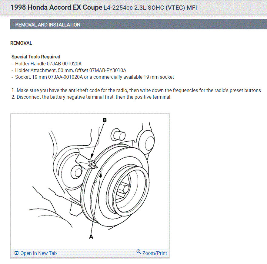

If you determine the sensor is bad, here is a link that shows in general how to replace one:

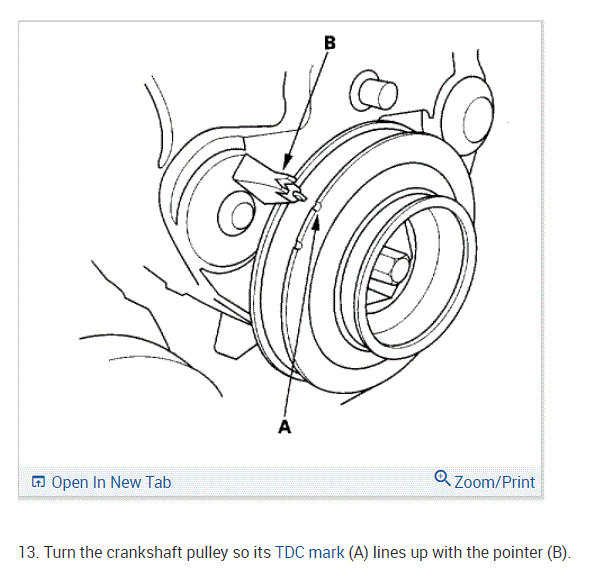

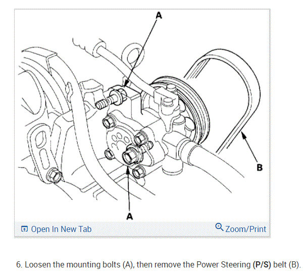

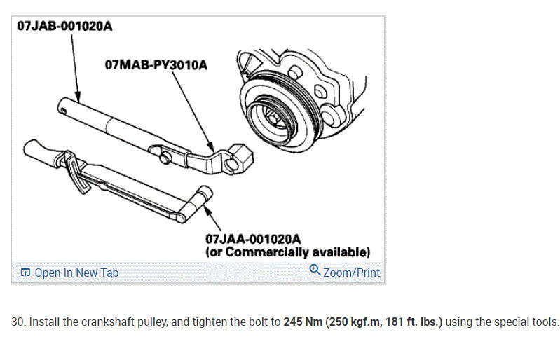

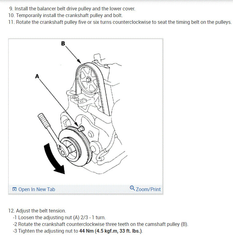

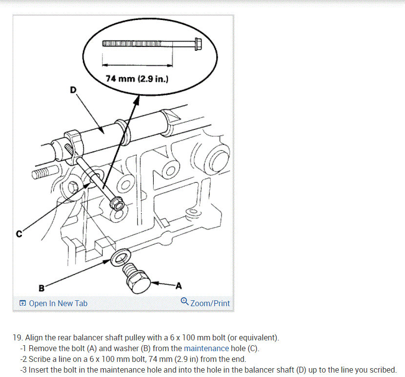

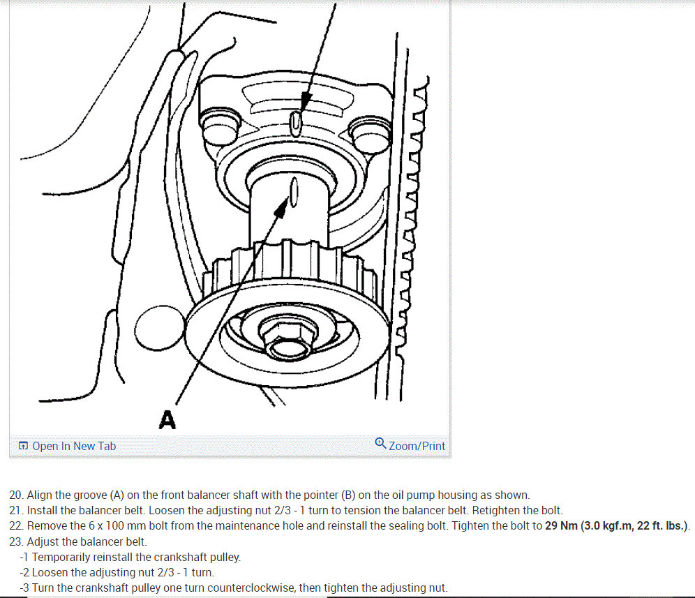

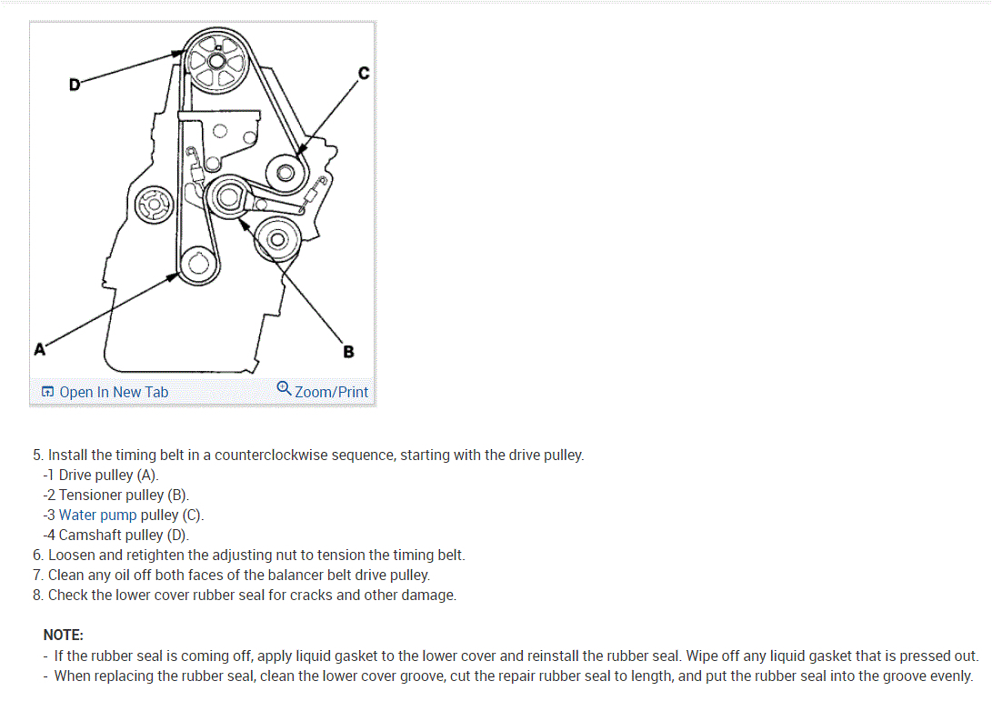

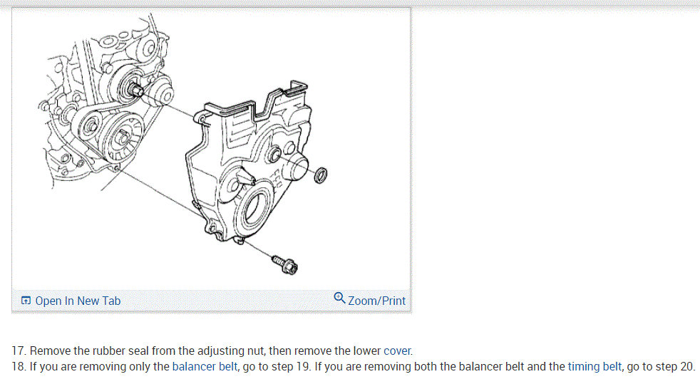

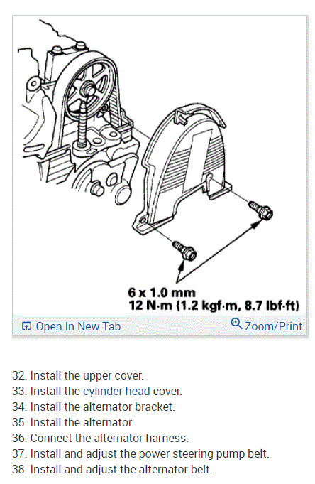

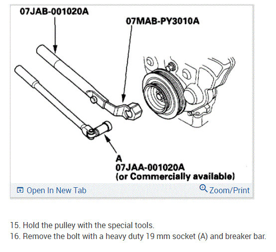

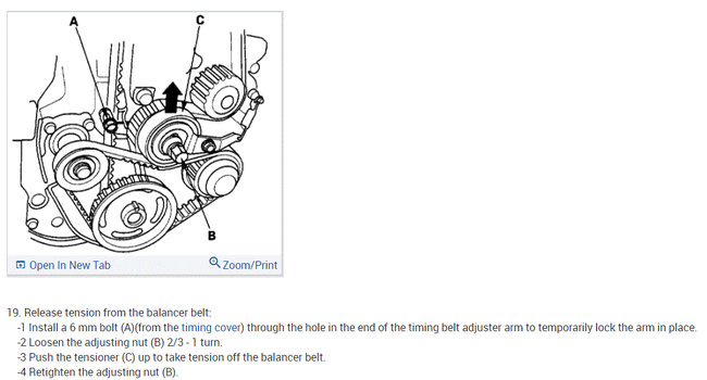

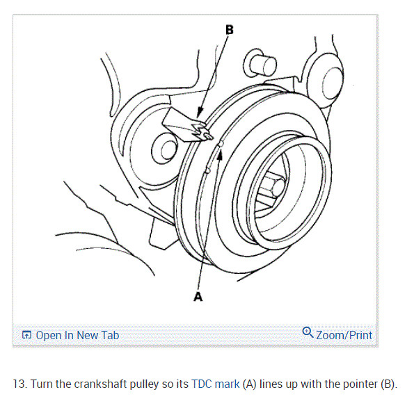

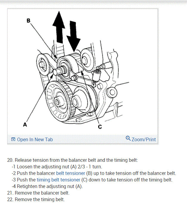

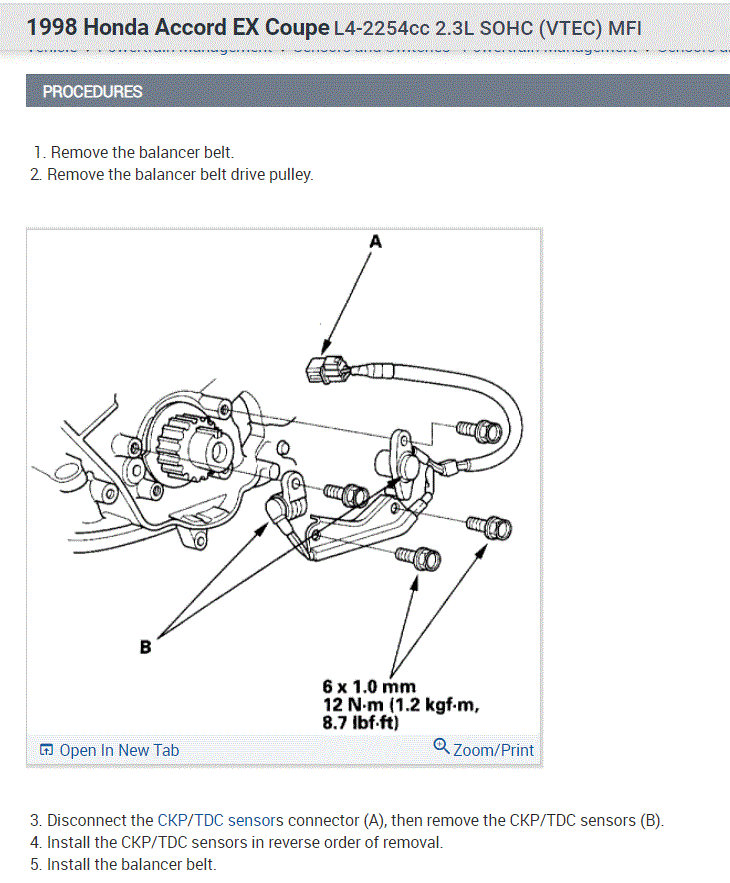

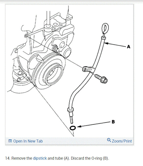

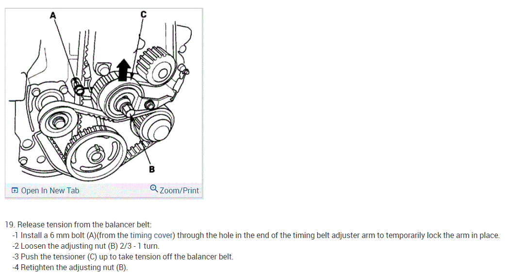

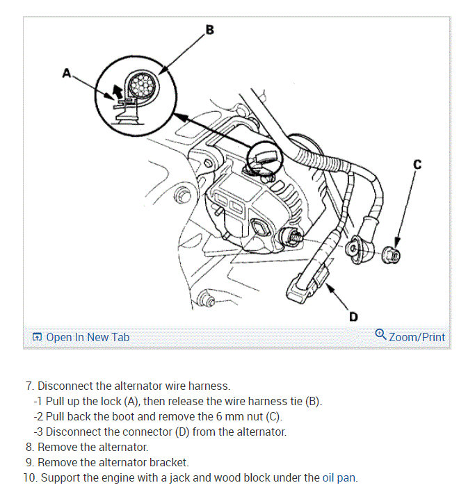

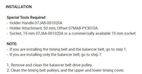

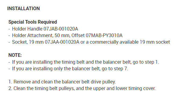

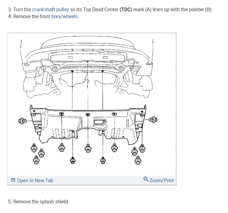

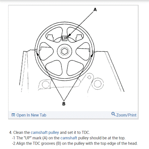

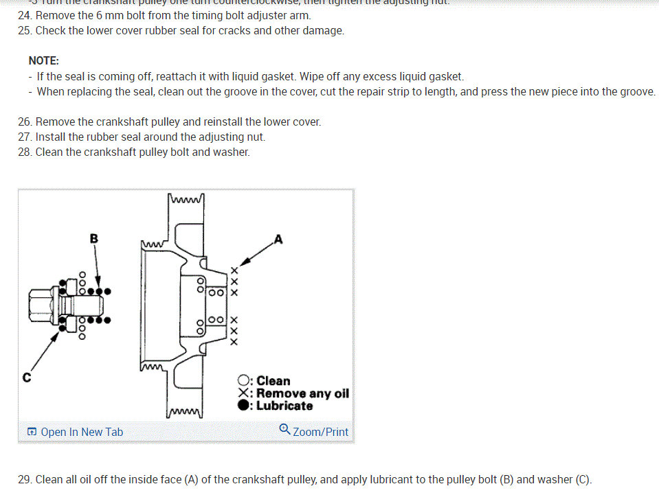

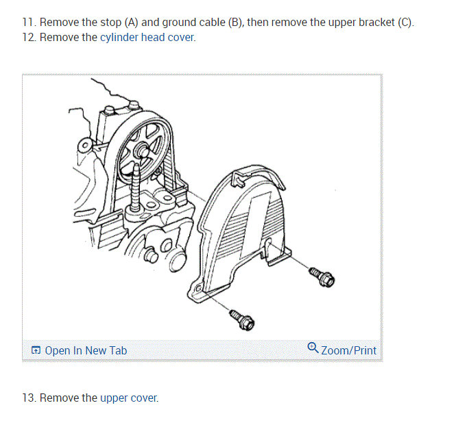

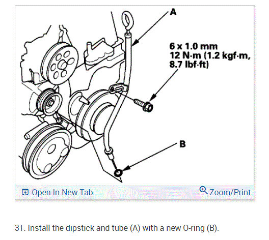

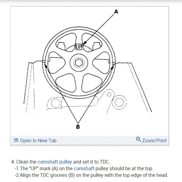

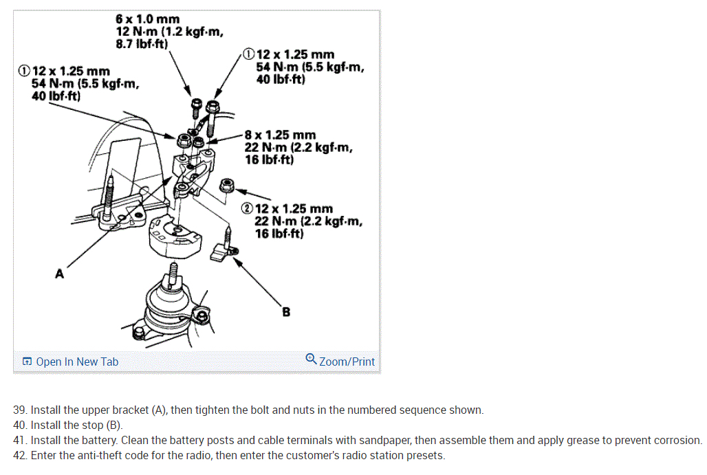

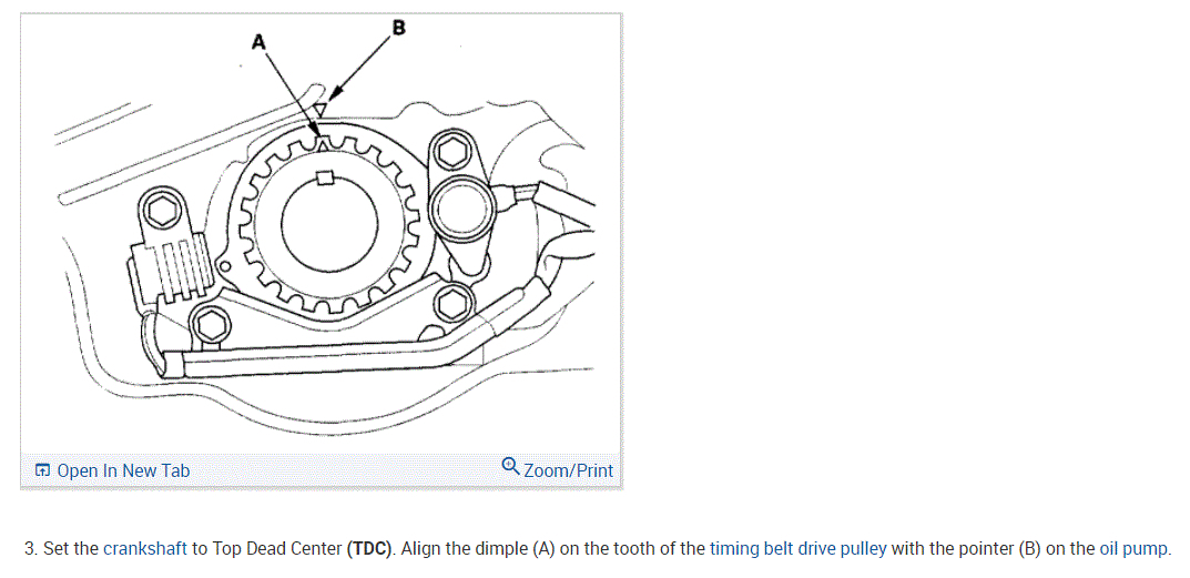

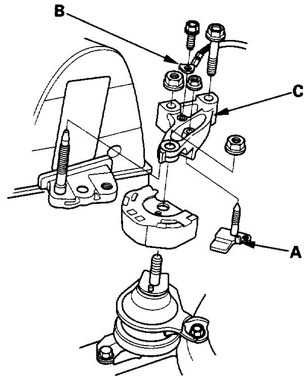

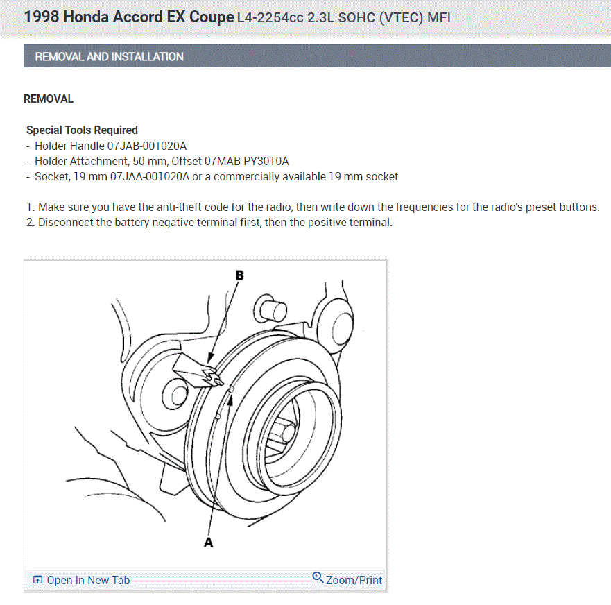

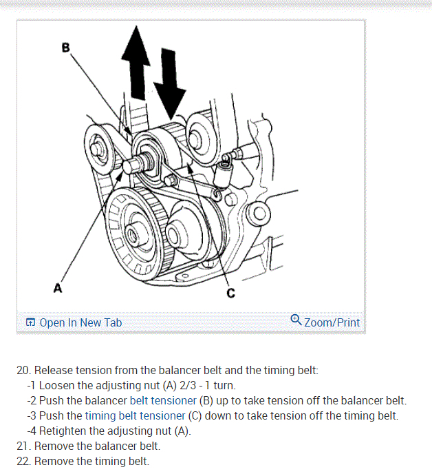

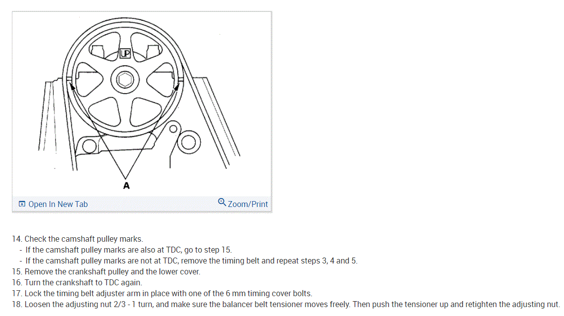

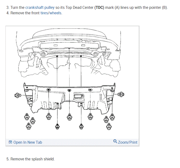

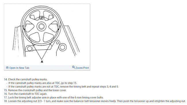

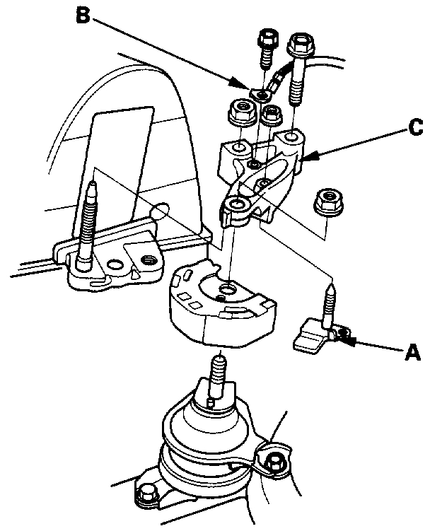

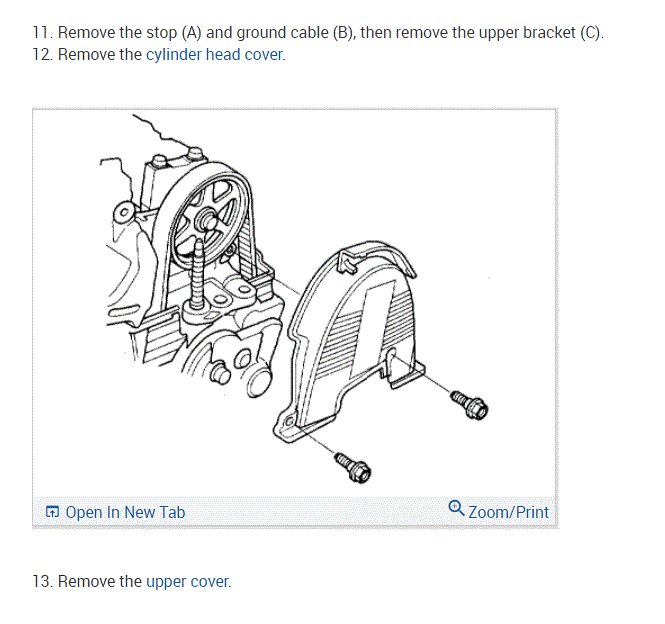

If you look at the attached pic, it shows the sensor-specific to your vehicle. This one is a little more involved because the balancer belt (timing) needs to be removed.
The first pic below is how the sensor is replaced once the belt is off. The remaining pics explain how to remove and replace the belt.
I hope this helps. Let me know if you have other questions and what you find.
See pics below.

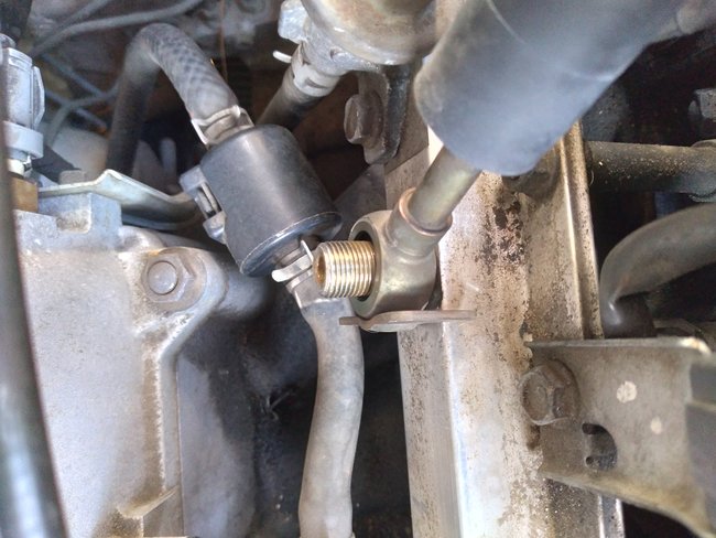

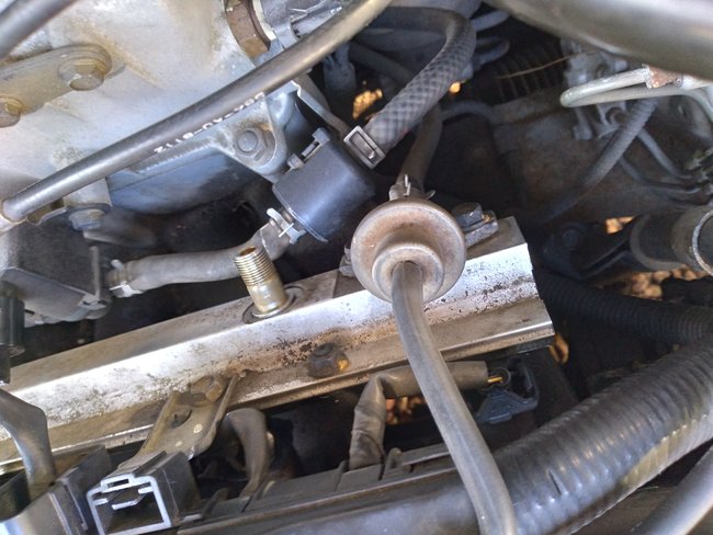

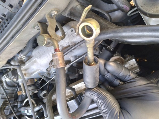

Okay, so I thought a fuel pressure test kit and the issue I'm having is that when I took the damper off the fuel rail none of my attachments for the fuel gauge out of the couplings actually fit on the threaded piece. I found one that went on a few threads but I felt like I was going to strip it because the threads feel different on the fuel rail than the ones that are on the test gauge attachments. but it fit on snug enough that I thought I could do the test. so I turn the key to the on position are fuel squirted out of the line set is underneath the damper. I sent a picture showing the line that goes on the threaded piece of the rail before the damper even if I found a coupling or attachment that goes to that part of the fuel rail I don't know how I would stop the fuel from coming out of that. mine in order to test pressure I had the fuel gauge hooked up the best I could to the threaded part of the fuel rail and when I turn the car over fuel squirted out of that line. so I don't know if there's some way of keeping it attached or if I have to undo that line from the firewall and pressure test it from that line instead? but I read online that the Accords have the same issue with finding an attachment.

When it stalls, does it start right back up? If you had the tester on a few threads and fuel shot out, pressure doesn't sound like the issue.
Let me know. Also, do you have a live data scan tool?
